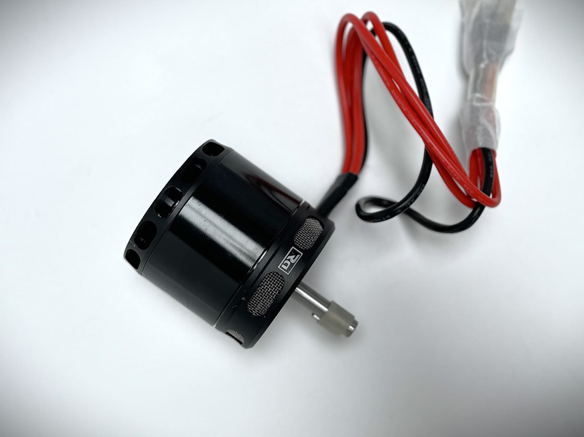

Speaking of racing, we’ve had a few people request higher kv motors lately for 4WD race boards.
We get these custom made individually usually, but I thought I’d get a couple extra sets of these 6465 255kv motors made up, perfect for the front of a 4WD race board.
We have 2 sets put aside, 398 AUD / 360 USD per set. Shoot us a message if interested! We can also match them with a set of 6495 255kv and ship worldwide with all taxes and custom’s fee’s included in the shipping price :call_me_hand:
Im curious, is there any particular reason reacher doesnt do 190ish kv?
The kv is a result of the number of turns - how many times the bundle of coils is wrapped around the stator teeth. You can only do increments in whole numbers like 6 turns, 7 turns and not say 6.5 turns, hence why you end up with specific jumps in kv and can’t do inbetween.
I see. Guess im stuck with flipshit for the time being :smiling_face_with_tear:
The 6465 and 6475 size can do 190kv. The kv steps change between motor length as there are multiple factors that affect the final kv, not just number of turns alone.
Dm me if you want a custom set of 190kv 6465/75! We have a shipping channel that can get them into the US without import taxes and customs fee’s.
Thx dude. I actually recently got new flipshits after one broke down recently but I’ll be sure to check with you next time. I might upgrade both my builds next season and will be sure to check with you!
