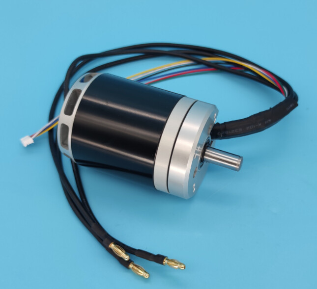

We then completely redesigned the motor working with the engineer at Reacher Tech to come up with a new version that is more compact, robust, has more torque and made the cooling system able to actually work with the addition of air intake vents, as well as Radium-ified the appearance :smirk:
The result was pretty awesome in our opinion. Perhaps one of the most underrated features is that we are now running 4 of the same decent sized ball bearing (most other motors have 3 bearings often different in size and very thin which is bad for longevity). And the bearings aren’t installed with a huge press or anything so it is possible to replace them at the end of their lifespan without being a massive pain. This means the motors can last a very long time if not beaten to death climbing rocky mountains.

So on the latest revision of the Radium/Reacher motors we changed just about everything to do with the sensor system, so much so that the sensor pcb is on the opposite side of the motor (thanks @Trampa for the great suggestion!). We changed the hall effect sensors to a different brand and type, added decoupling capacitors to the sensor pcb, and moved the sensors to front of the motor where the wires can run straight out without going near the stator or magnets. We also changed the sensor wires themselves from 80C rated PVC to 150C rated teflon in a multicore flexible cable and added glue to stop the pins moving on the sensor plug. We ditched the resin coating on the stator to allow air to flow between the coils, and upped the strength of the magnets for more torque. There is also now sufficient Loctite of the right kinds in the right places, and we are currently testing the latest batch to assess if they are ready to be made available for purchase :partying_face:
So far the sensors are working great, and you can now feel hot air coming out of the exhaust vents when you spin the motors up after some riding.
