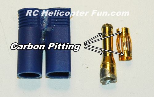

I remember a good picture somewhere that shows how due to the uneven contact points, they wear away two main points on the banana strand connectors. Whereas with the split connector at least the entire connector touches each other, but can’t seem to locate that picture.
Edit** found it, over time it gets uneven carbon pitting
