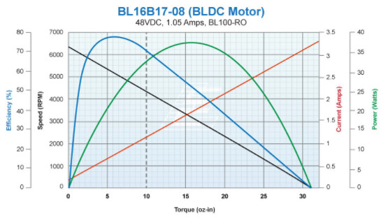

This but plotted on a graph over RPMs.
Things like efficiency and idle current draw is intresting too.
example:

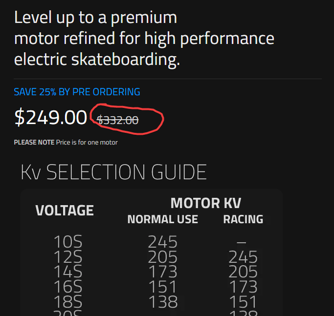

Oh it did, as I mentioned I’m comparing non preorder prices, which should be the point of comparison unless you plan on having it at the preorder price permanently.
I believe thats in aud.

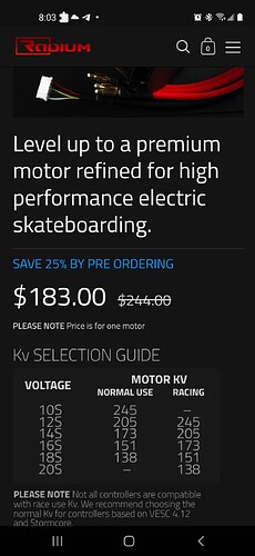

Here’s usd:
Huh, I only just noticed the currency selector. I didn’t think to look on the bottom left of the screen for one. Never mind me then!
