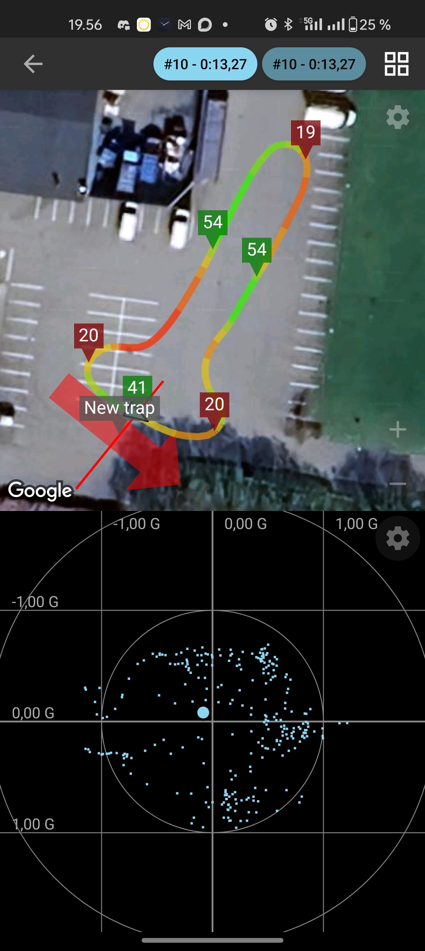

Did a very slight PB of 13.27, 0.01 better than last session :joy:
Late into the session I also found a line that I feel like has potential. I had one lap where I was super slow in the first corner (exiting it with over a sec delta to best lap) and finished the lap only about 0.20 slower than best lap. I just need to connect that ending with a good first corner entry and I will have the first position. Hopefully I can connect it next session.
My findings from that lap are to take previous laps last turn a little wider and stay wide but straighten quickly. Going little wider than usual entry into the first turn, tight turn at the end of the T, late apex the next cone, then try to straighten out as quick as possible in the end again so I can get back on the power, but wide enough so that I can make the first turn again.
Also this is not a completely new finding, just one that at the moment I find hard to consistently implement. Brake a lot, let off, take 4th cone and straighten out aggressively, brake more, let off for 5th cone.
