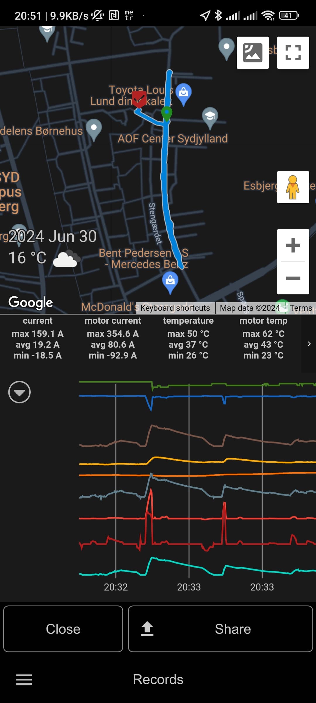

Done some drag racing on the exway venators. I can’t full throttle now :sweat_smile:
354A max drawn from the available 400A
It’s technically possible to improve this time on the current setup but I’m gonna take the tires off and save them for indoor tracks
