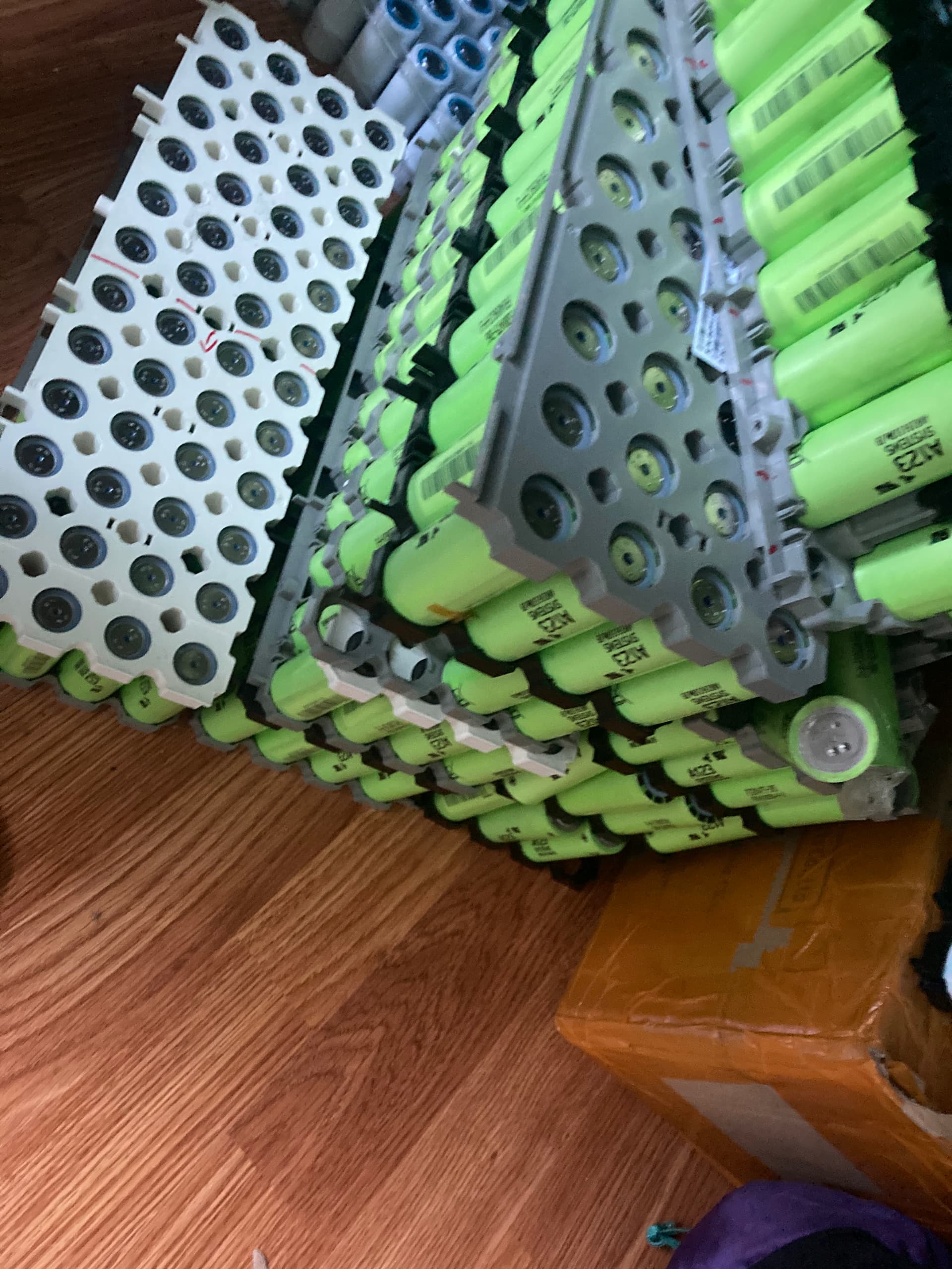

I thought u shouldn’t be welding the the center bottom of all these cylindrical cells. I don’t have the pic anymore but the center most millimeter or two is where the can attaches and that connection can be damaged increasing resistance

A123 26650s also have this vent on the bottom side but it’s the positive.
