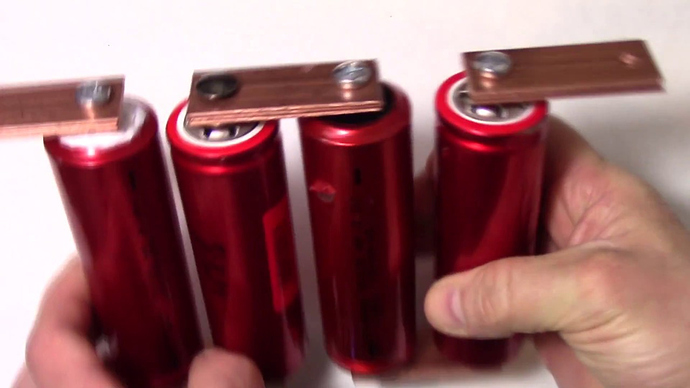

I just want to see cells with threaded ends…just bolt everything to a copper bus bar and call it a day

How can you add those to a normal cell? Take a flat head bolt and torch the end, add some solder, and sticking it to the cell?
