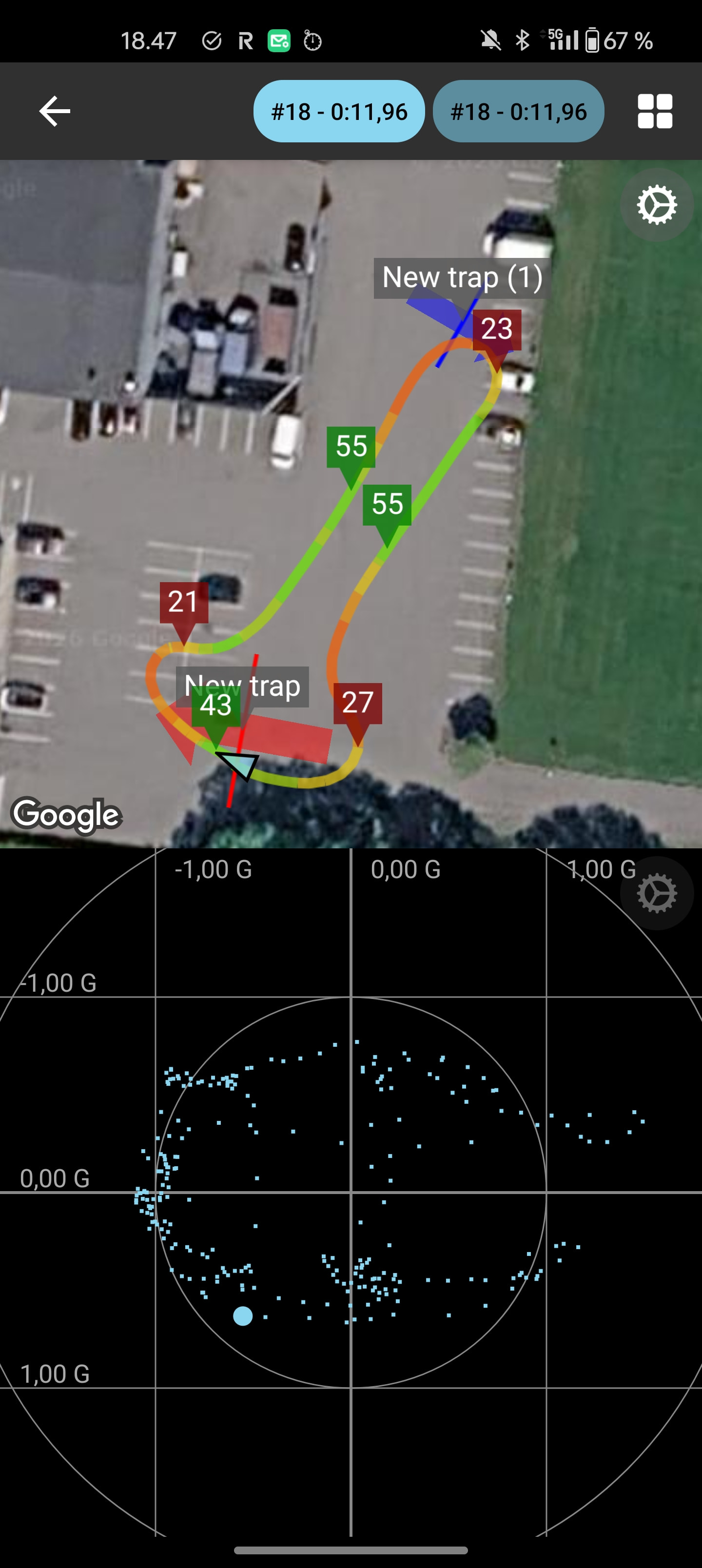

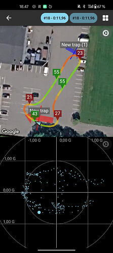

11.xx here we come!
11.96 today
Can’t wait to put them into comparison tool I built since the 12.09 lap to compare against a numerically optimal lap to see where it’s still possible to gain time
