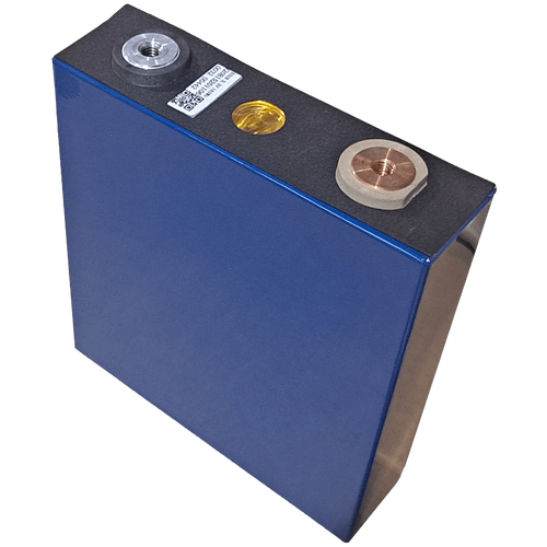

I feel like if i were going to try lifepo4, i’d be leaning towards prismatic cells.
Iron is heavy
I’ve been looking at them.
You’d think being rectangular, it would be easier to find a good fit for what I’m wanting to do.
Like, you’ve got these guys:
Seems like a really good price for the wh.
But, I’m not looking for more than 600wh. 400-600. Otherwise it will be too big and too heavy for my liking.
So what are you supposed to do?
4S1P, a whole 12v?
Something like these might work, if I don’t get destroyed by shipping costs:
14s2p
627wh
90+ Continuous amps
Obscene Peak Amps, I’m not sure if I can even show those numbers.
The ONLY thing that I wish looked better on these was the charging current.
Which is listed on the table as only 7A.
When going down steep downhills, the max regen current needs to be high. At least -30A I’ve found, and I’ve pushed that to the limit a few times, so I’d certainly be happier going higher.
I’ve already had one slow motion crash when I’d just got my board and conservatively set my regen to -12A
Had to do a controlled abort right into a chain link fence at the end of a hairpin at 18mph.
But I’d probably just assume that if these cells can handle such high peak discharge, that the regen peaks would probably be fine too.
