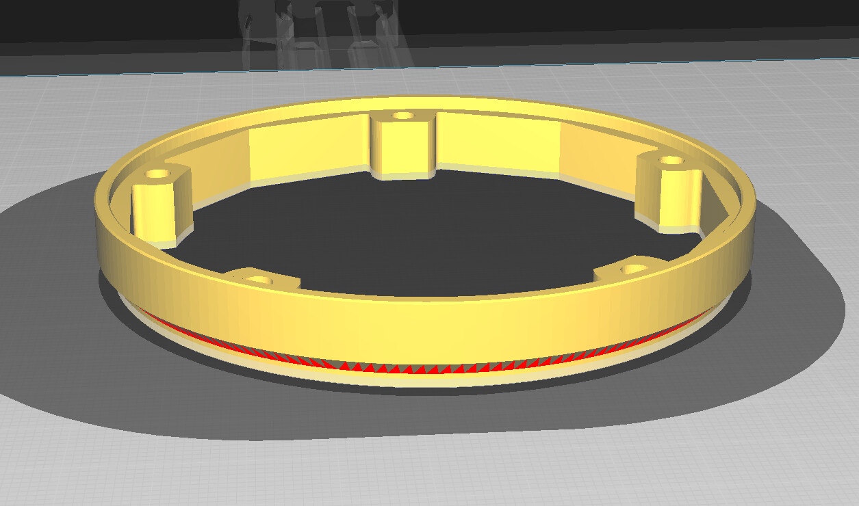

Here’s the MBS XL hub spacer files incase anyone wants to print a set.

Printing and fitment tips:
Don’t use PLA, I’ve had a PLA set melt in the sun. Any other material should be fine. You’ll probably have to drill out the screw holes with a 4mm drill bit. And if the lips don’t snap together easily, I recommend taking a dremel sanding bit and just do a few circles on the printed part to get the fitment right. It’s quite likely that the dremel trick will need to be used, as tolerances vary by printer and material… And it’s designed for quite tight tolerances. If you don’t have a dremel manual sanding with sandpaper can also get the job done but dremel is much faster.
The part should be printed in this orientation without supports, I usually bump up the wall count enough so that it gets to 100% infill with just walls.
Note2:
I’ve not had any spacer related failure / safety issue, and in my testing the spacers hold up better than the hubs themselves if printed well. That said, obviously use at your own risk. However, what I did have is that the hub bearing seats widened over time with the use of big spacers. If you keep spacer width to around 15mm which should be enough for most tires, this shouldn’t be something that happens quickly. For supernovas and linn slicks I found the 15mm spacer to be the ideal width.

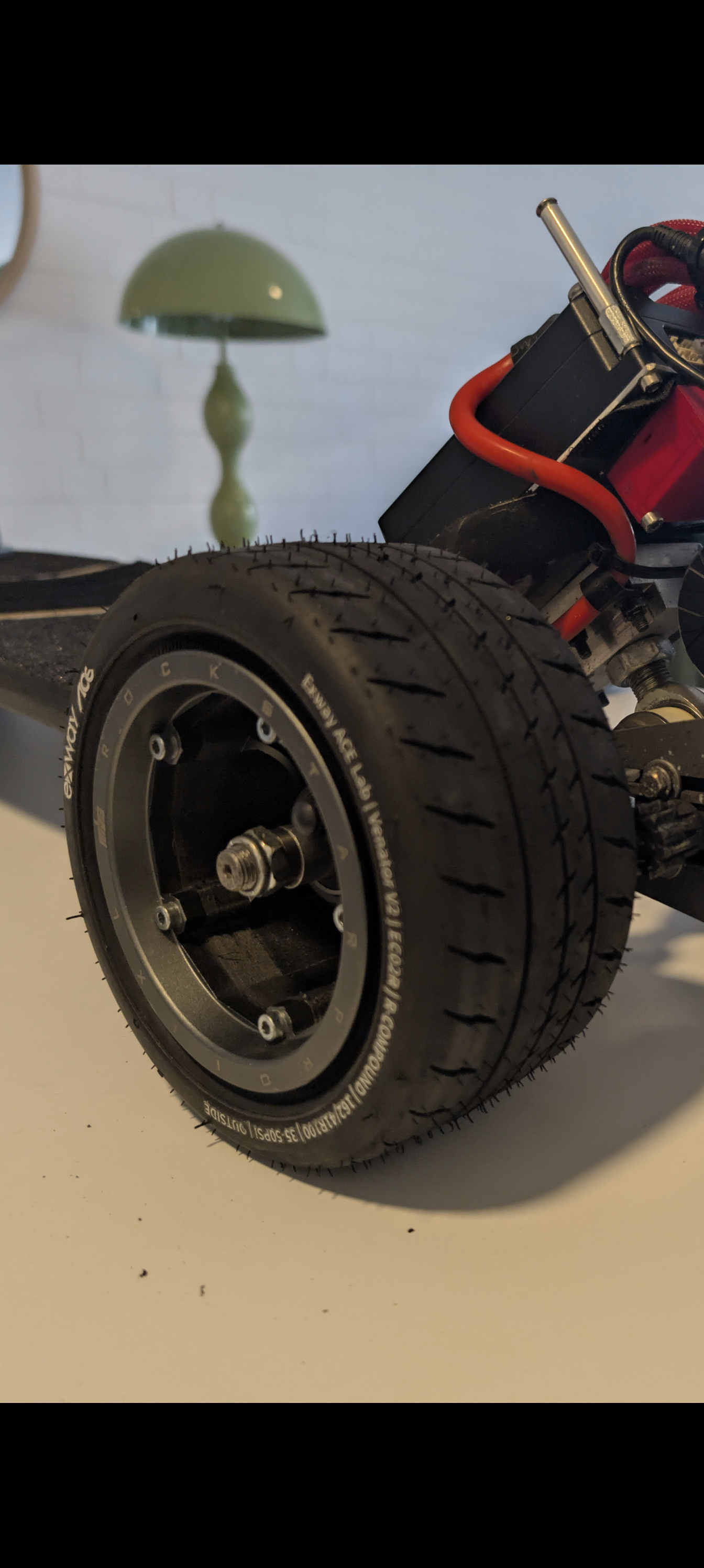

Thanks for posting these. I drew one up but didn’t have a chance to print and test yet; I’ll compare mine and yours. Planning on running the Exway ACE CST 162 tires on the XL hubs so I was thinking around 10mm might be good, but I’ll check.
15 was spot on
