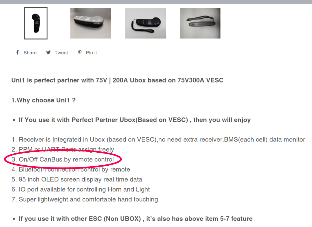

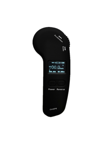

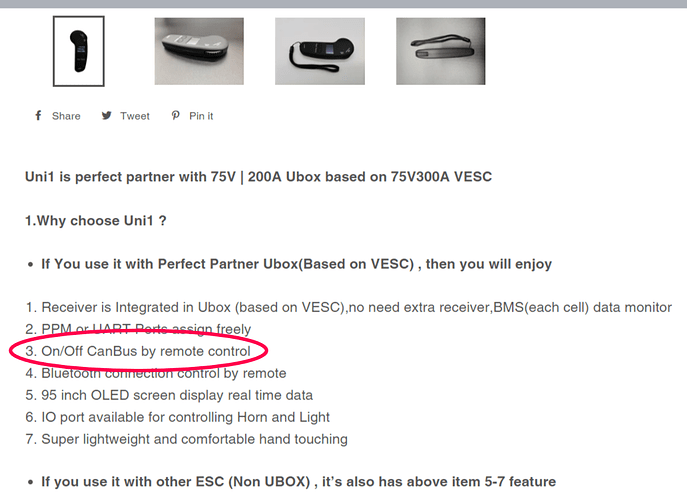

But that remote! Wonder if u can get that alone. I’m an emailed question away from knowing.

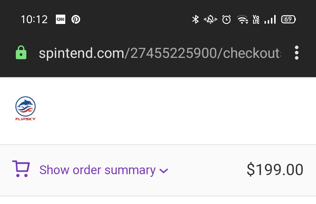

Don’t know how legit these guys are , but they seem to have the remote with receiver:
Ah how could I miss that flip sky logo.
