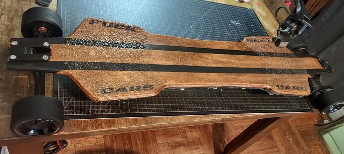

PLÄÄNK - Restomod | What if the Ship of Theseus was a mediocre raceboard?
Bro, throw that shit out. Sounds like a nightmare
bruh I bought like 10 yards of it, at this point you’re talking about trashing a 10, maybe 15 dollar investment
Lol sounds like the 200 dollar roll of chop strand that i bought and hate using.
Shame about losing the wood grain :sleepy:
yeah but it’s more vibrant now anyway, since it has the same finish as the deck :+1:
Silver linings are always good.
Solid job on the enclosure regardless of the finish :ok_hand:

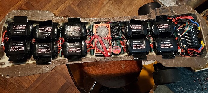

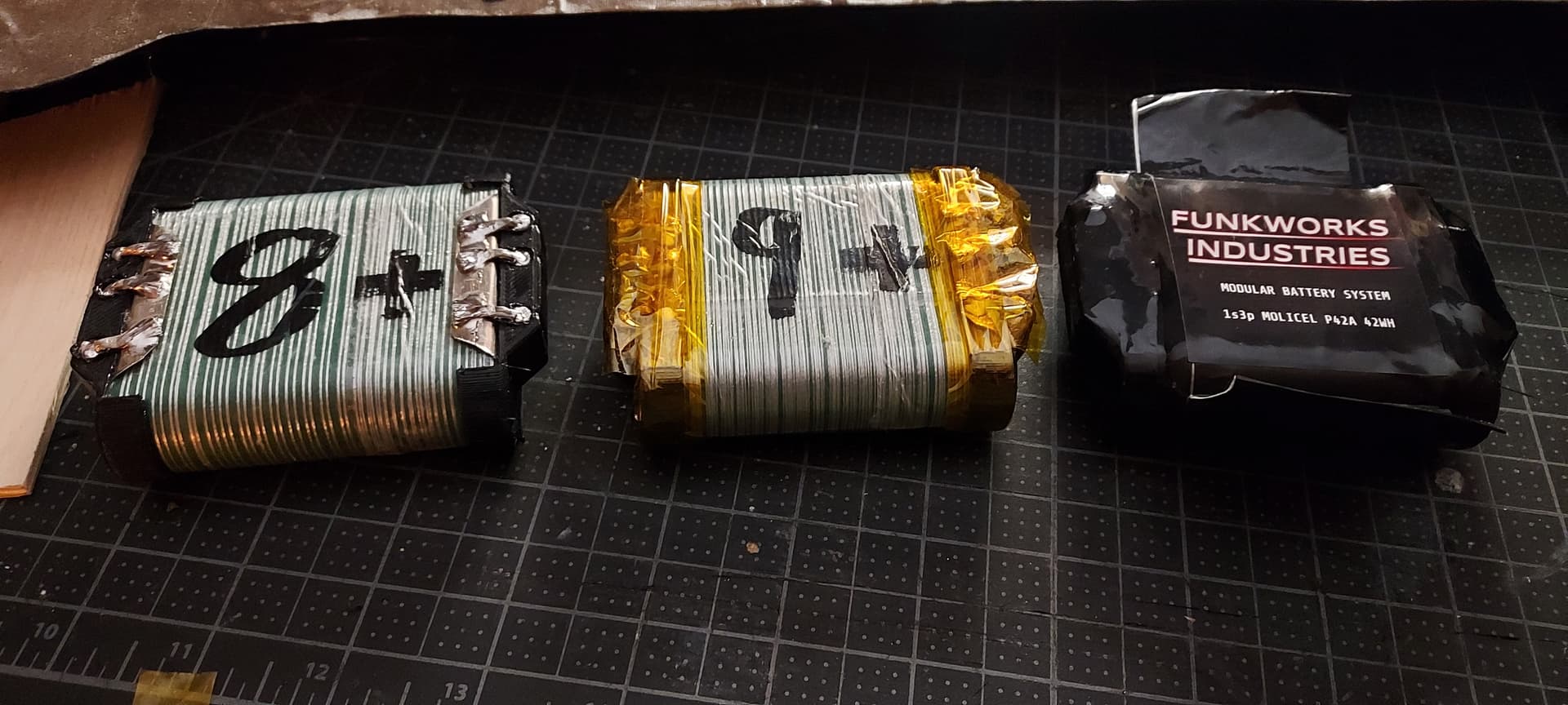

Connecting the bullets to the nickel tabs is the last step before wrapping up the batteries. It was pretty nice to be able to do the rest of the work on the wiring, without any of the cell groups being energized. Hopefully looks slick enough that TSA won’t think it’s diy :ok_hand:

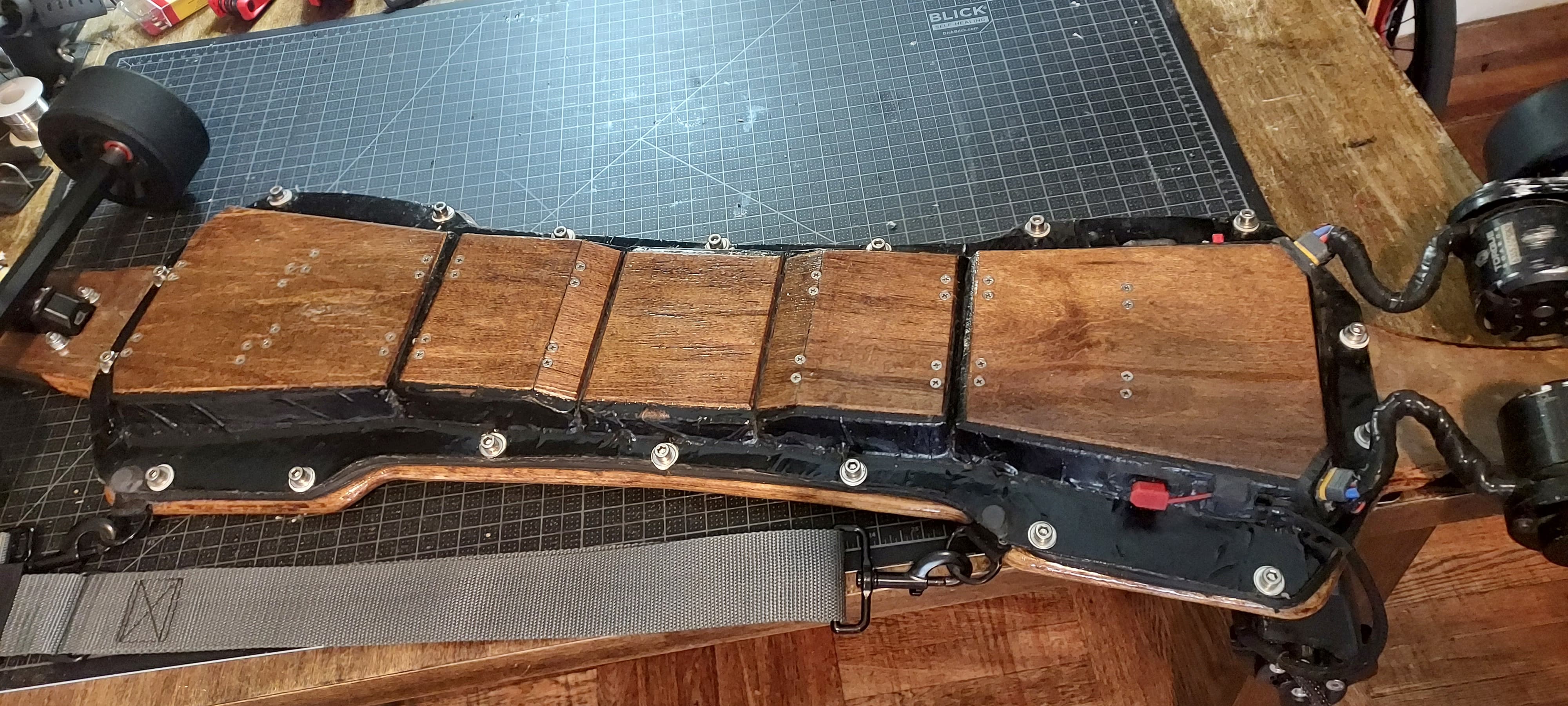

Internal wires all glued down, foam sandwiches for the batteries top and bottom.
Schmexy.

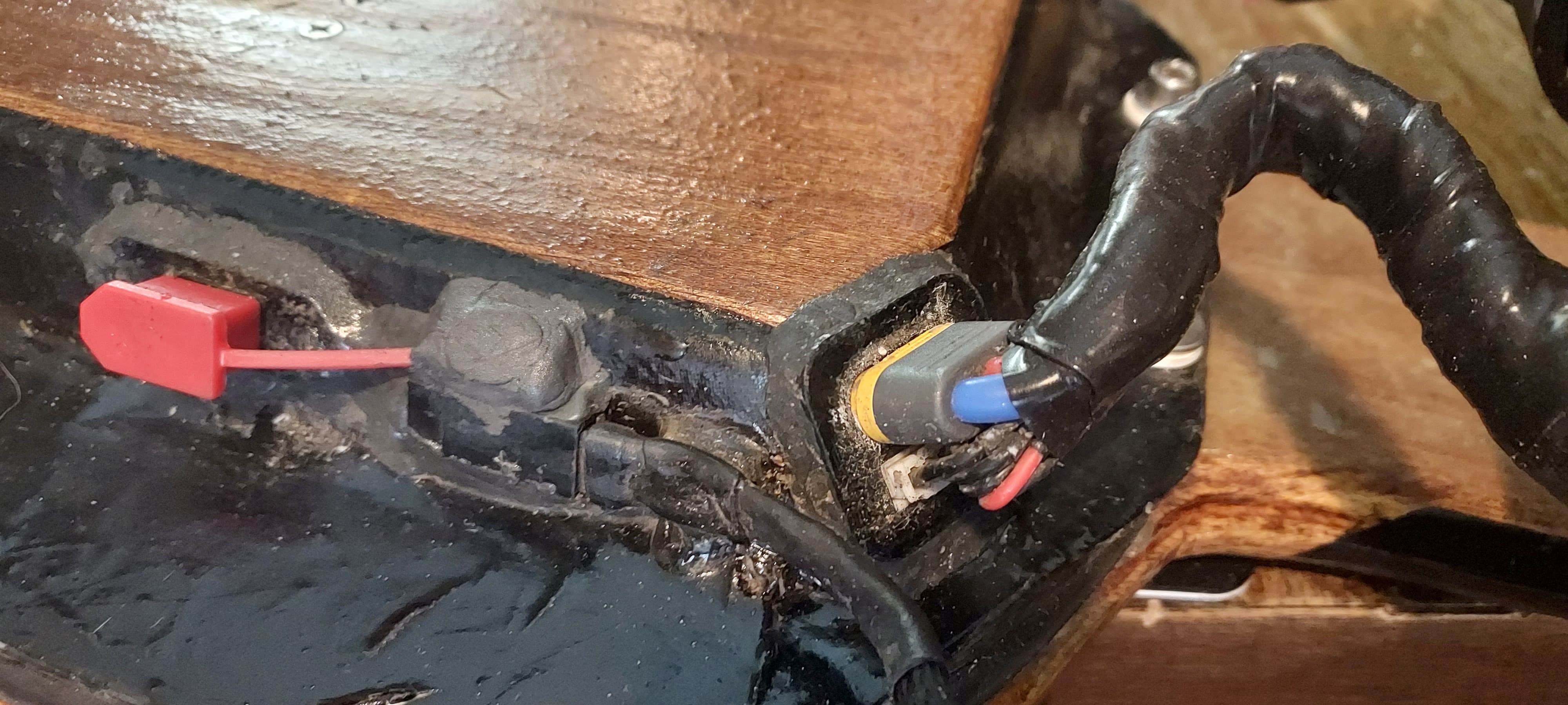

Panel mounts on everything
Stainless hardware and a shoulder strap :muscle:
At long last, ready for action!
This board made it to our group ride last Sunday. Sexc and awesome.
Wait, does each p-group have its own 4 bolts holding the bullet connectors locked together? :exploding_head:
Vibrations? In this household?? I think the fuck not
Yeah, the bullet holders are glued to the inside of the enclosure, but that’s not enough. So I added wood screws going in from the outside
The screws don’t hold the P-groups onto the bullets, that is just from compression

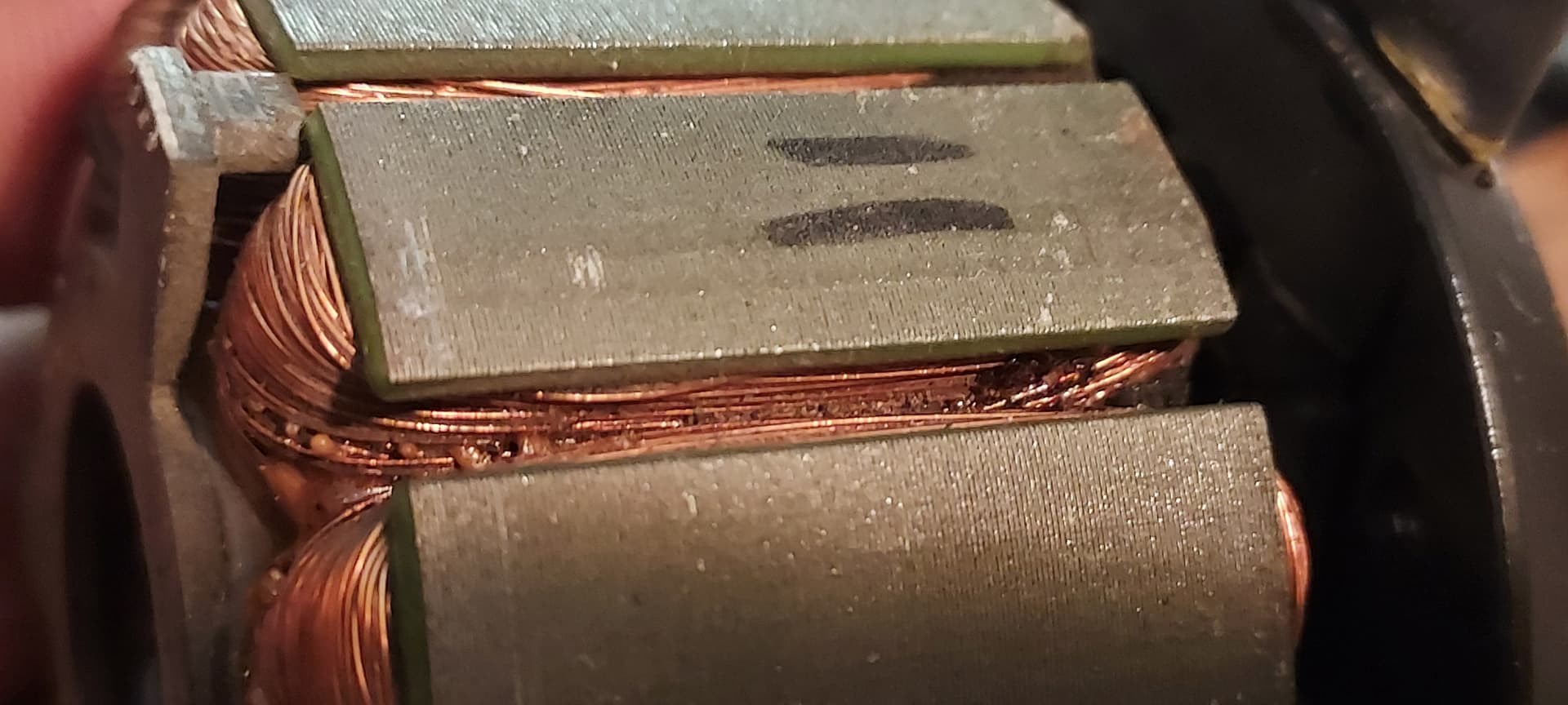

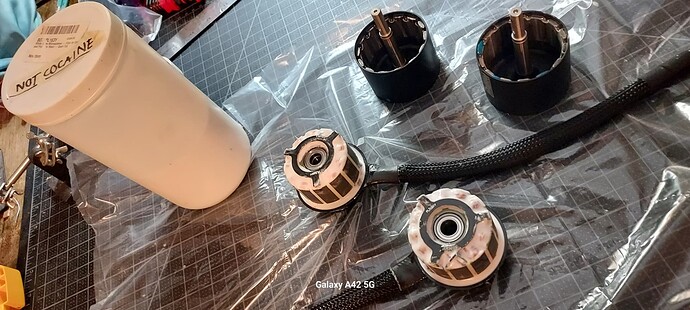

Got some random intermittent braking the other night, and did a walk of shame back home. Thought at first that my LegStick™ tether might have gotten frayed from an earlier incident but it turned out to be an internal short on the right motor. Took it apart and found the offending coil:
Could either be the dirt and water ingress at the base of the coil, or the hits that the motor has taken from its low ground clearance. Either way, I should probably get some battle hardened motors at this point. I’ve heard good things about the recent flipsky iterations, yes?
They’re good. Just loud as fuck for no reason
Don’t threaten me with a good time, bucko
New motors who dis
Battle hardened the windings too, they’re now fully sealed against moist forms of intrusion

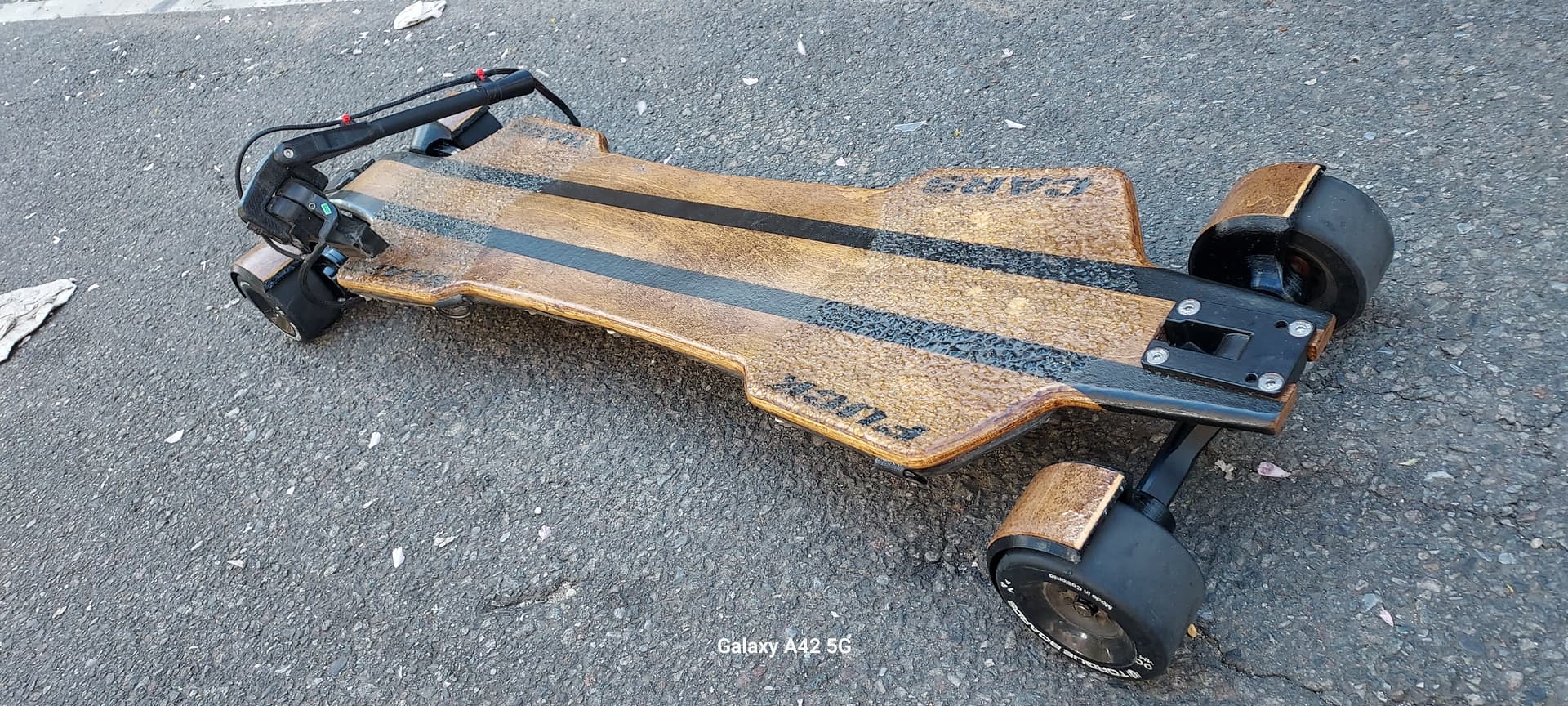

Printed some fenders with ~tasteful wood paneling~ , splashed some puddles today and they’re mostly effective. This thing is turning into a 1980s station wagon, though.
@Evwan you’re right about the motors sounding crazy. They function as an easily readable speedometer now.
Blessing and a curse. I have davegas everywhere, so I don’t like.
My reachers start whistling at 30. It’s less intrusive but enough to let me know how fast I’m going.
What epoxy/sealant did you use on those stators?
Totalboat epoxy, thickened with microballoons
