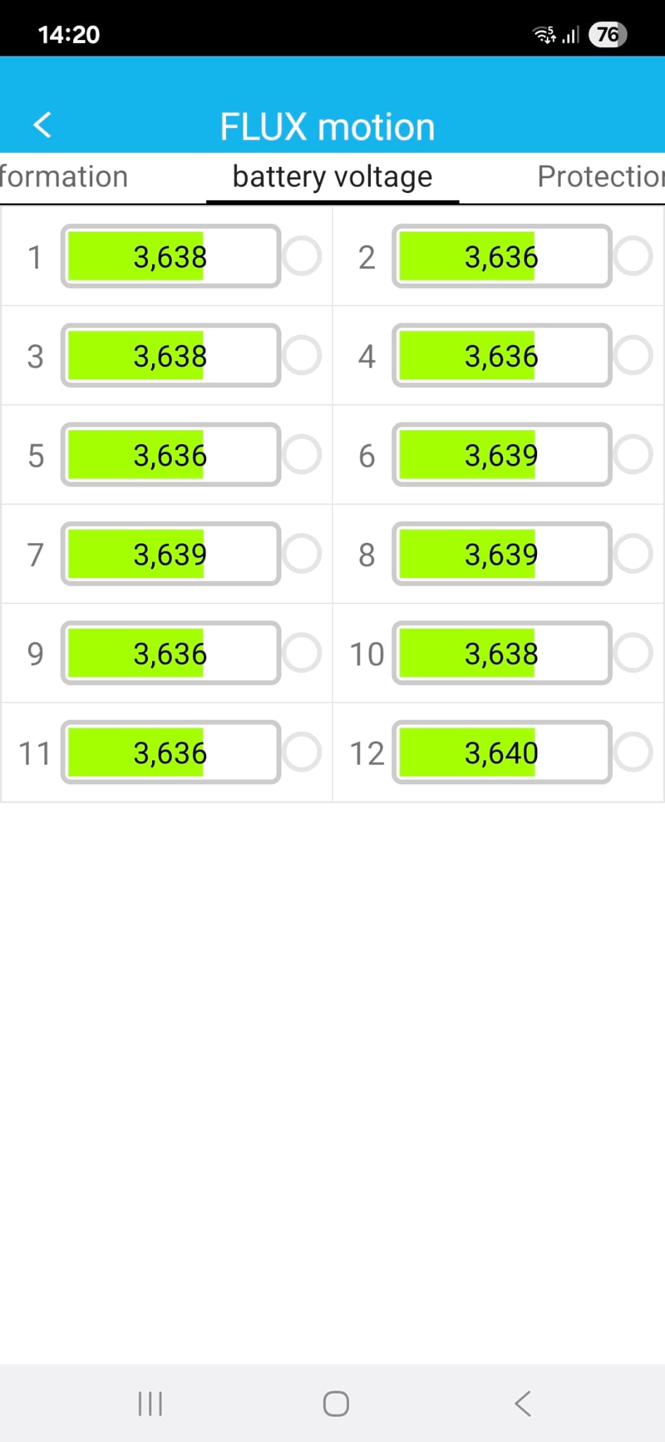

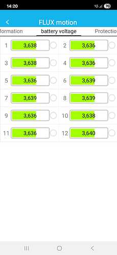

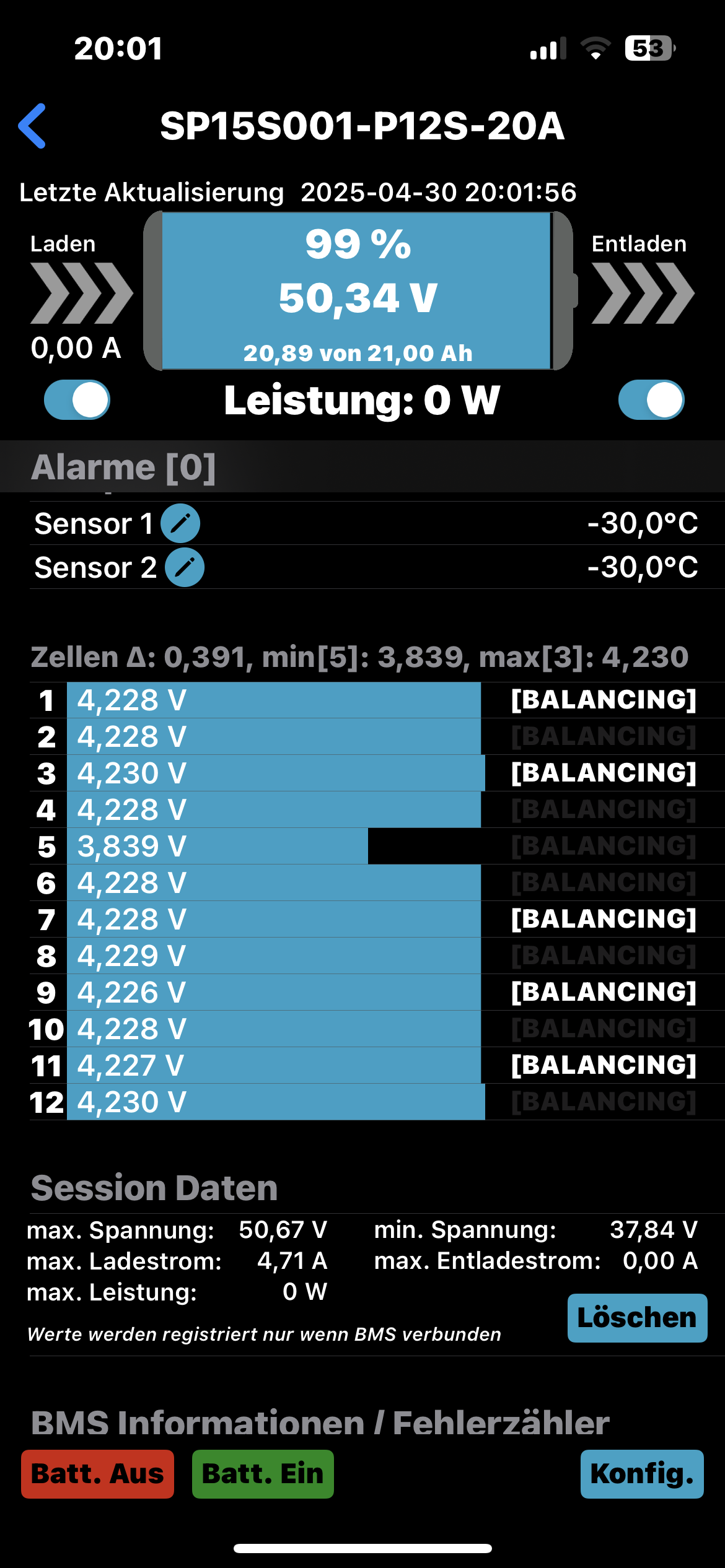

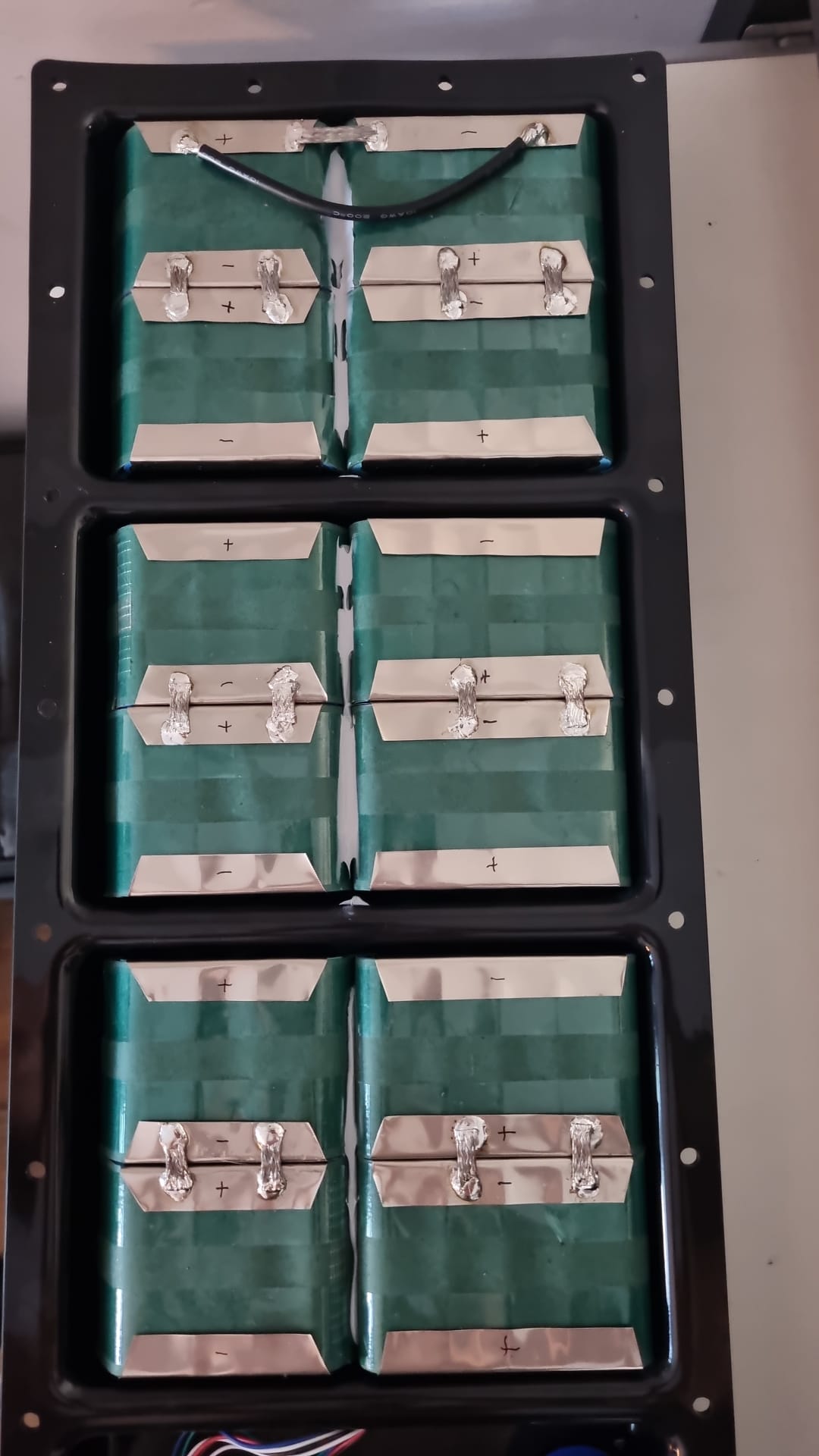

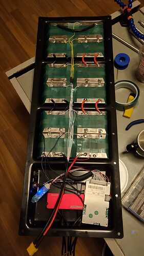

P group voltage drop more than other p groups
Ehhhh potentially?
It could be any number of things, but by the looks of it, it’s probably going to be pretty tricky to diagnose.
The entire pack will need to come out and given the way it was constructed, it’s not gonna be especially easy or safe to repair.
I’m placing bets on a cell shorting on the carbon

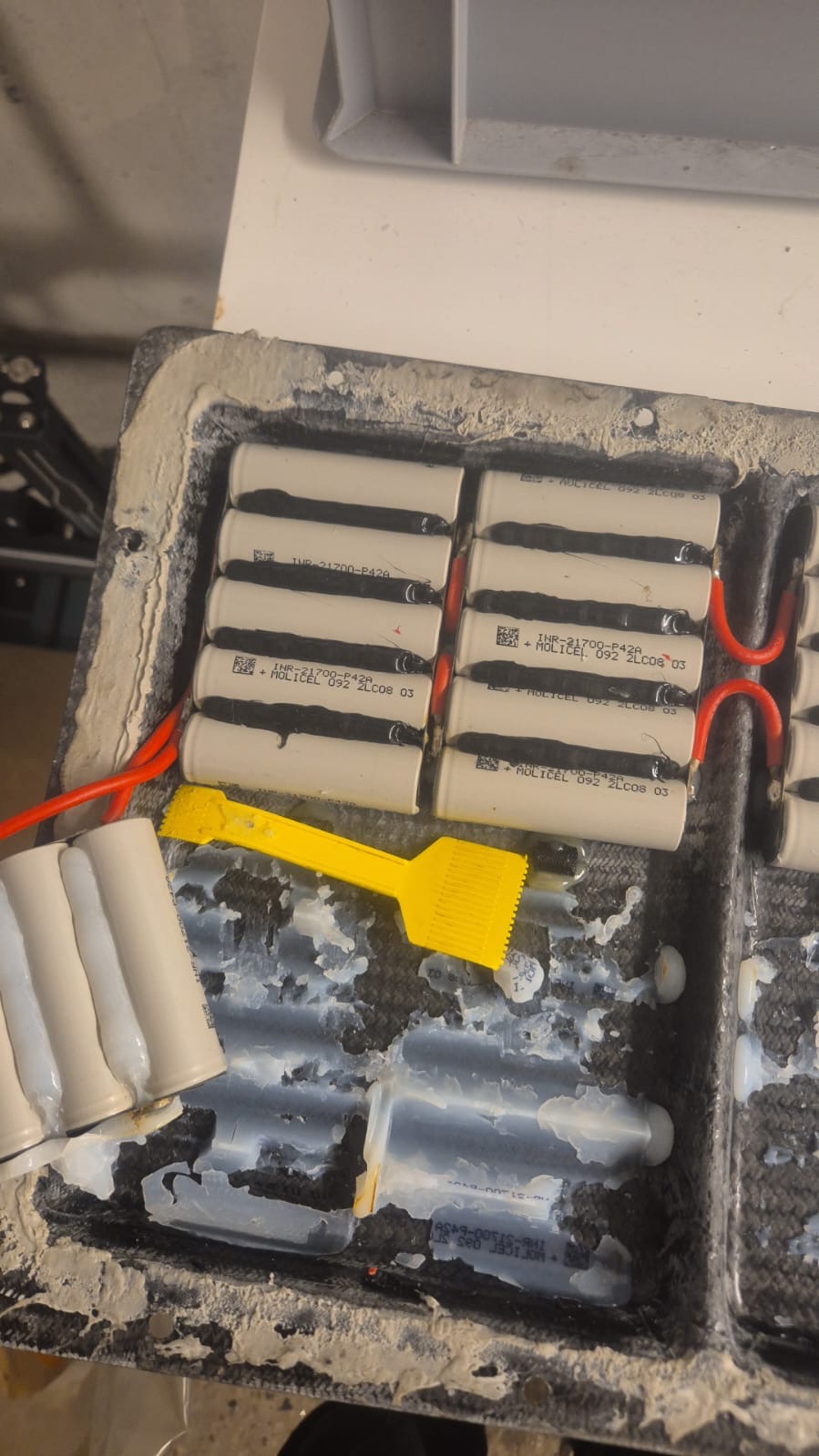

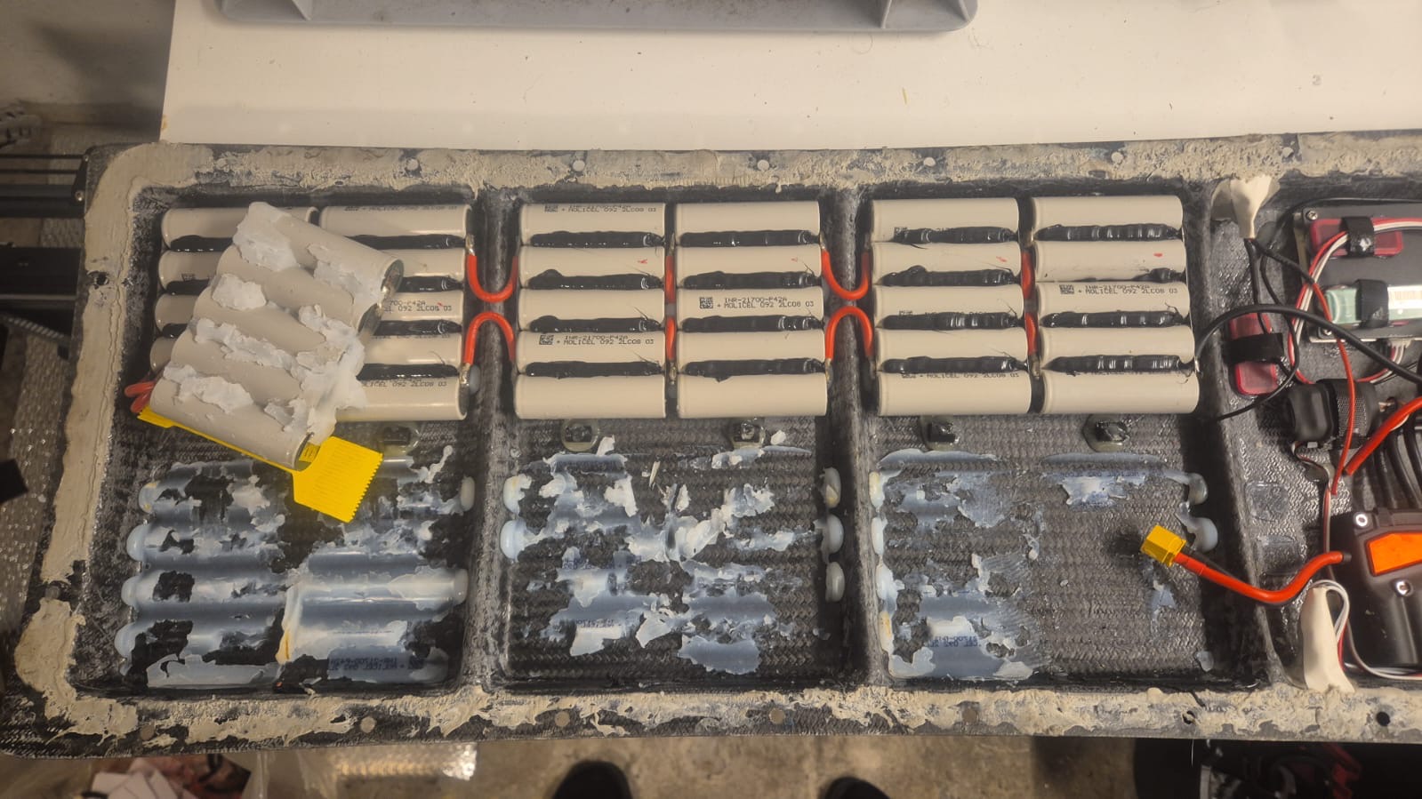

I wonder what “potted” to the enclosure means… It seems to me that with a lot of sweat i would be able to dismount this battery, and maybe save some of it ? I don’t really care about the loss, willing to spend on a total new battery. So i do need to clean the enclosure up, which should be doable ?

If you dont have experience with liion batteries and how to safely handle them, then I dont suggest trying to do that yourself. The risk of a fire is very real.
I think you’d be better off sending the whole enclosure (or perhaps the whole board) to a reputable battery builder, and let them remove the pack from your enclosure. Simeon is a good choice if he’s willing to take the job.

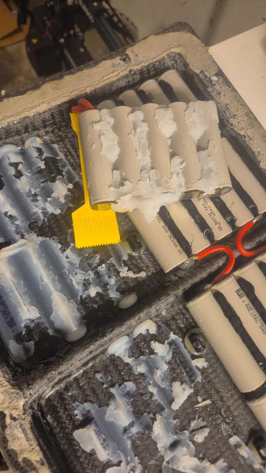

Likely it means that the battery is stuck to the enclosure with lots of silicone. Based on those pictures, it seems like the cells are stuck to the enclosure directly, which not only makes removing them much harder, it also makes removing them more dangerous.
If you decide to remove the pack yourself, here’s some general advice:
  • Unplug all connectors from the battery/bms/esc before doing anything else.
  • Clip all of the wires and remove the loose wiring from the enclosure.
  • Clip each wire separately, one at a time.
  • Clip each wire as close to the cells as reasonably possible.
  • Insolate each wire as you clip it. A simple piece of electrical tape works fine for this.
  • Insolate any exposed metal of the battery (nickel, solder, copper, etc.)
  • Do not attempt to remove the nickel p-group connections. Leave the p-groups intact and treat each group as its own unit.
  • When removing the p-groups from the enclosure, do not pry or cut with any metal tools. The cells/p-groups should always be treated as “live” and capable of producing a short-circuit.

Weird that the BMS didn’t cut off the overcharge… Maybe also faulty? Are the temp sensors connected? (the -30°C indicate they aren’t)
most likely that or a loose weld. Either way, the pack (or at least p-group 5) has to come out and with that amount of silicone it’s gonna be a pita…

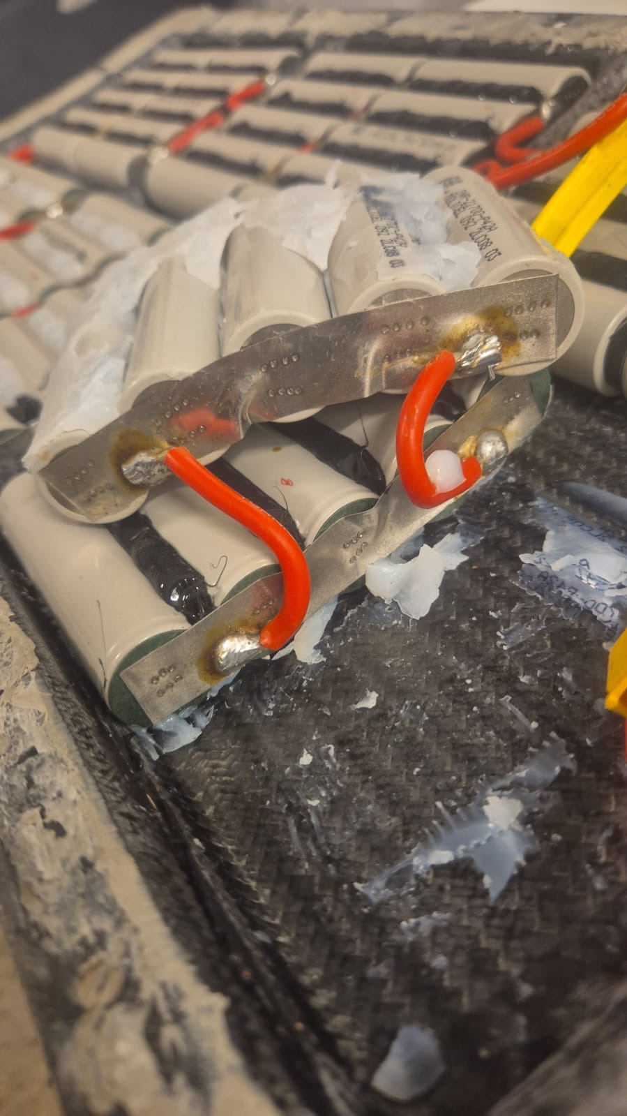

Overall I don’t like how this is built… basically no insulation around the cells and solder joints besides a thin layer of fibreglass on top of the carbon? How did John think this is sufficient?

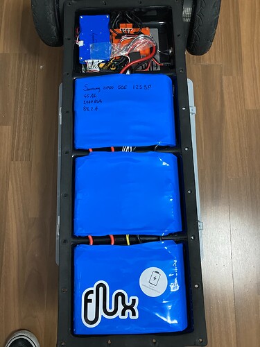

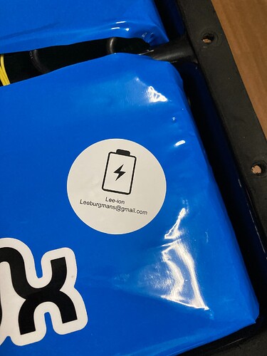

Relieved that this battery is out of my garage/house. Lee, an Englishman from Holland who used to be on here (the community) too I heard, has taken on the job🤙🏼
Lee has built my big battery for my Flux-board years ago, and that one is still going strong👌🏻

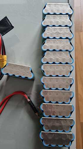

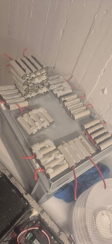

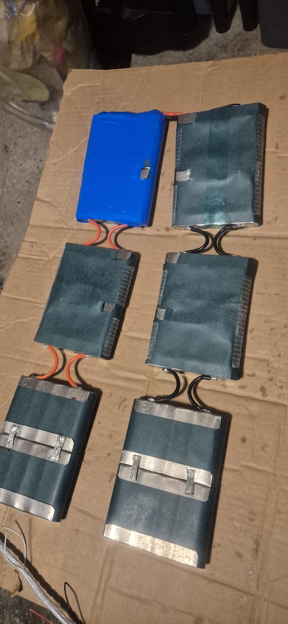

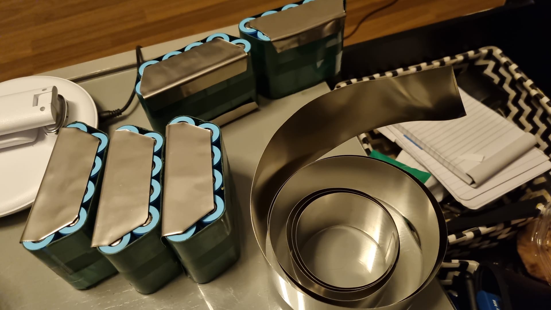

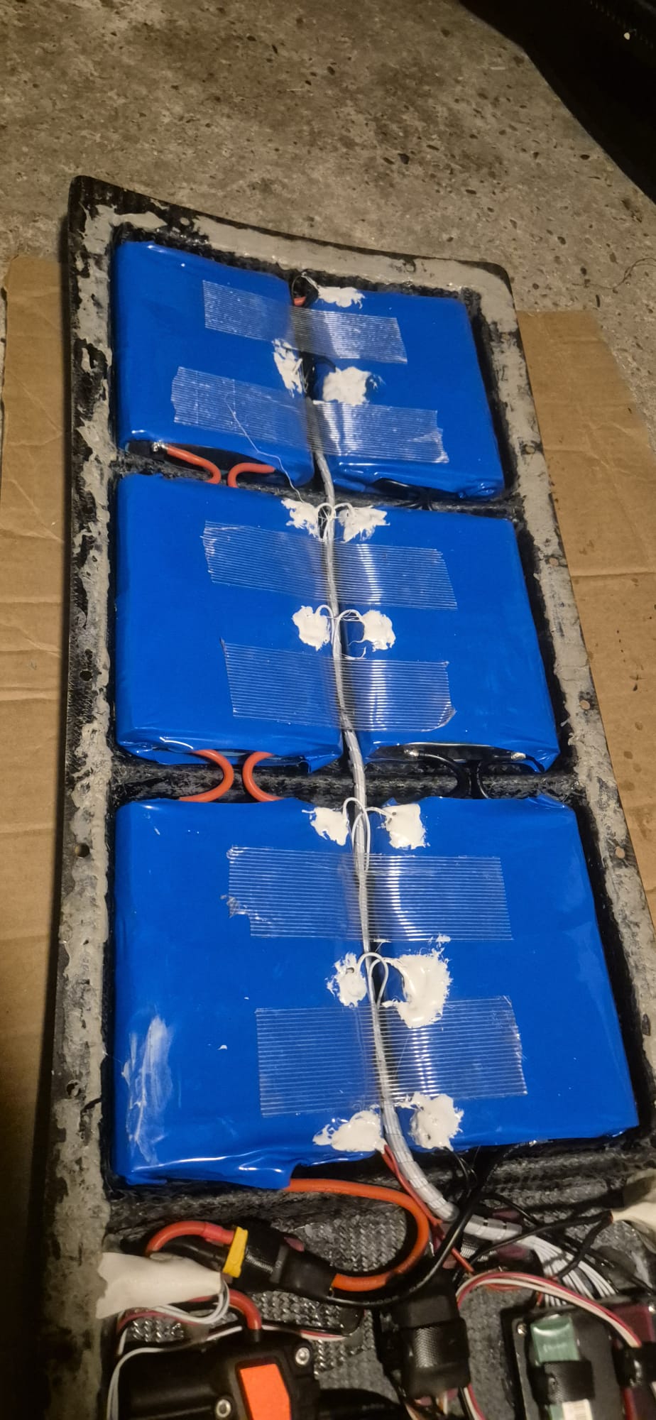

So here’s what he’s up against , taking the BoardsOfSweden battery apart :face_with_hand_over_mouth:
He was especially worried/surprised by the sharp edges of the nikkel plating not being rounded and possibly puncturing through that epoxy and touching the carbon :fire::scream: Not to mention all the other goo and shit he encountered :rofl:
In defence of John from BoardsOfSweden ; he DID mention that the battery would mean a total replacement/exchange of that+enclosure when having trouble with it.
Because of how it was constructed (goo/glue/sillicone/total hell) he would send customers a complete new enclosure with battery mounted in there as an exchange when needing warranty☝🏻
Knowing this ; i tried to contact him a month ago about my troubles and he has yet to respond…

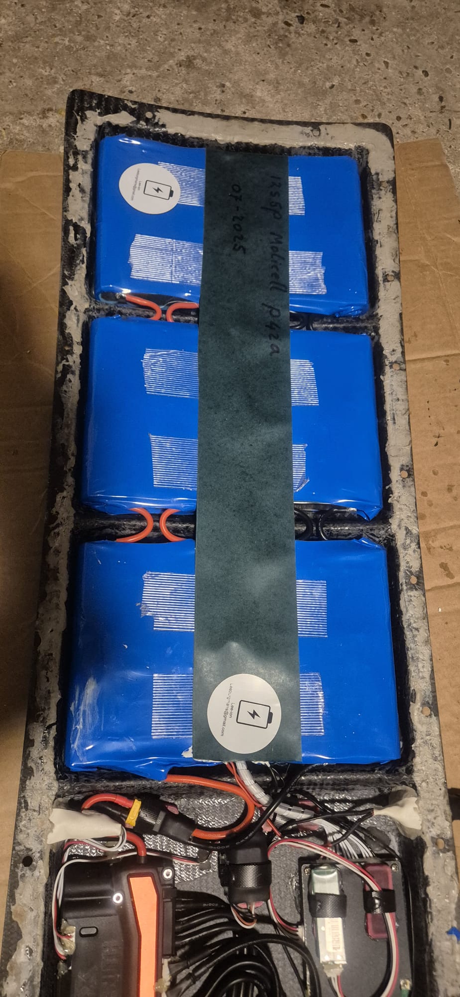

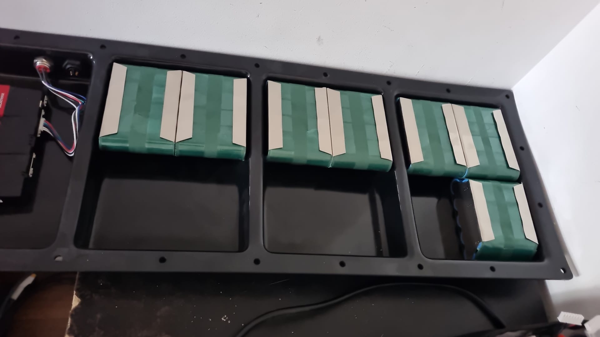

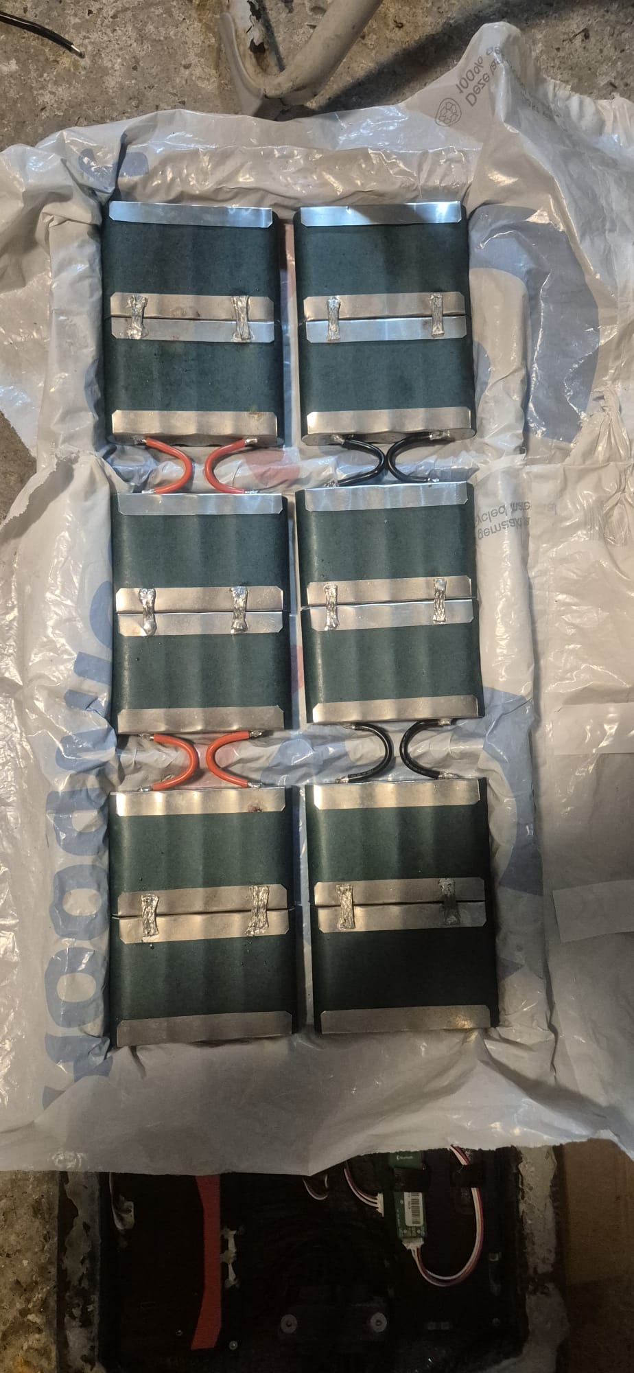

New Boards of Sweden pack. Seems like a nice job.
Englishman in Holland Lee did my Flux battery which has been going strong for 4 years now, this battery looks same or better.
Much better than it used to be ! :partying_face: Safe+sound !
