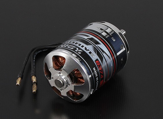

Thats Maytech based motor vs Turnigy…I got both…130kv Maytech and 149kv Turnigy SK8…I prefer SK8, but it is a matter of personal choice…130kv motors have amazing torque, super fun to ride…
One thing I was concerned about on the sk8 motors is the lower the kv the less amps they can take. I dont know if that matters but I haven’t noticed that on any other motor.
Well that it is actually better, less amps, more torque, more range…Its depends on what you are looking for…
So having lower max amps increases range? I definitely want 130kv because my gearing is so low and I can change it. Even at 130kv my top speed would be 40mph. Maybe 110kv would ve better.

Wait, you understand that at the same voltage a higher kV motor will spin faster than a low kV right?
Not to mention you can pretty much gear the performance of any motor to output what you prefer. It just requires a bit of maths to get the correct reductions.
