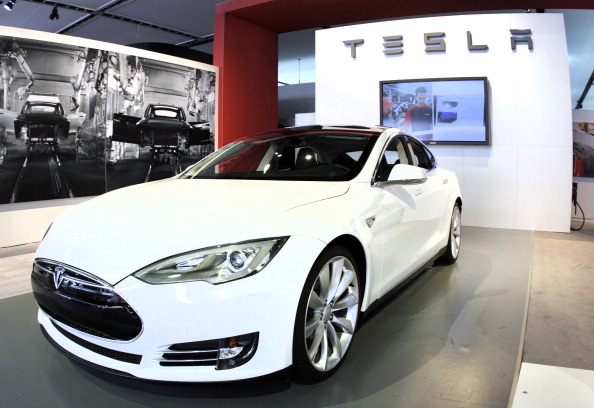

99% of cars can’t even maintain a constant 1g acceleration
“ Tesla Model S Plaid: Peak Acceleration is at 1.2 G’s”
keyword: peak
not average
0-60mph in 2 seconds in a Tesla is actually 1.3g average
and it doesn’t use water bottles
Because on a Tesla, the angle to the center of mass is more than 45 degrees from vertical measured from the rear contact patch, without a water bottle
