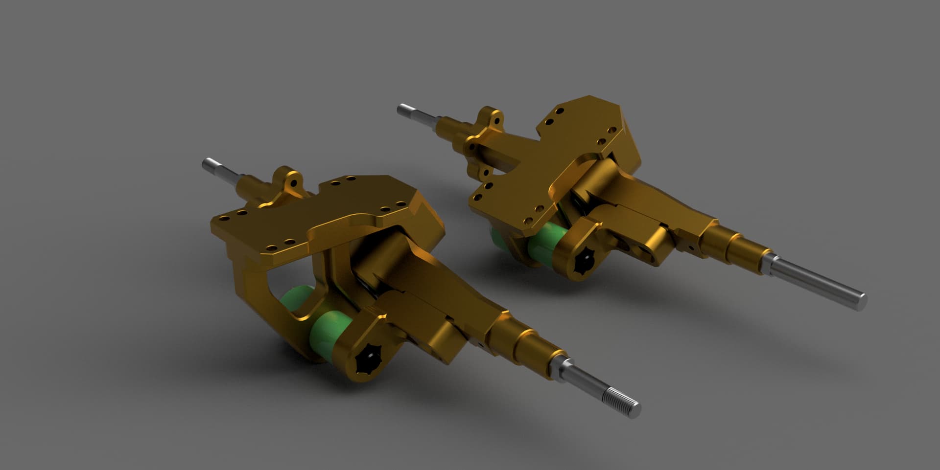

3-link hanger rolls, pitches, and yaws on a spherical.
This appears to be a zero rake channel truck using similar pivot characteristics of the Duality. Nice work.

After the Swing-Arm truck on revboard is work well, I’m plan to make few version of it. Compatible with flat deck (35 degree baseplate)and mtb deck (0 degree baseplate)
8mm axle and 10mm axle compatible,
With 8mm axle, full length 350mm
With 10mm axle, full length 370mm
Hanger width 258mm
With new series of sat, would be rakeless.
With 35 degree, axle center to the baseplate is 40.5mm.
Zero degree baseplate, axle to top is 36.7mm

What’s the smallest wheel size you’d be comfortable running on these, in particular the 8mm axle version?
