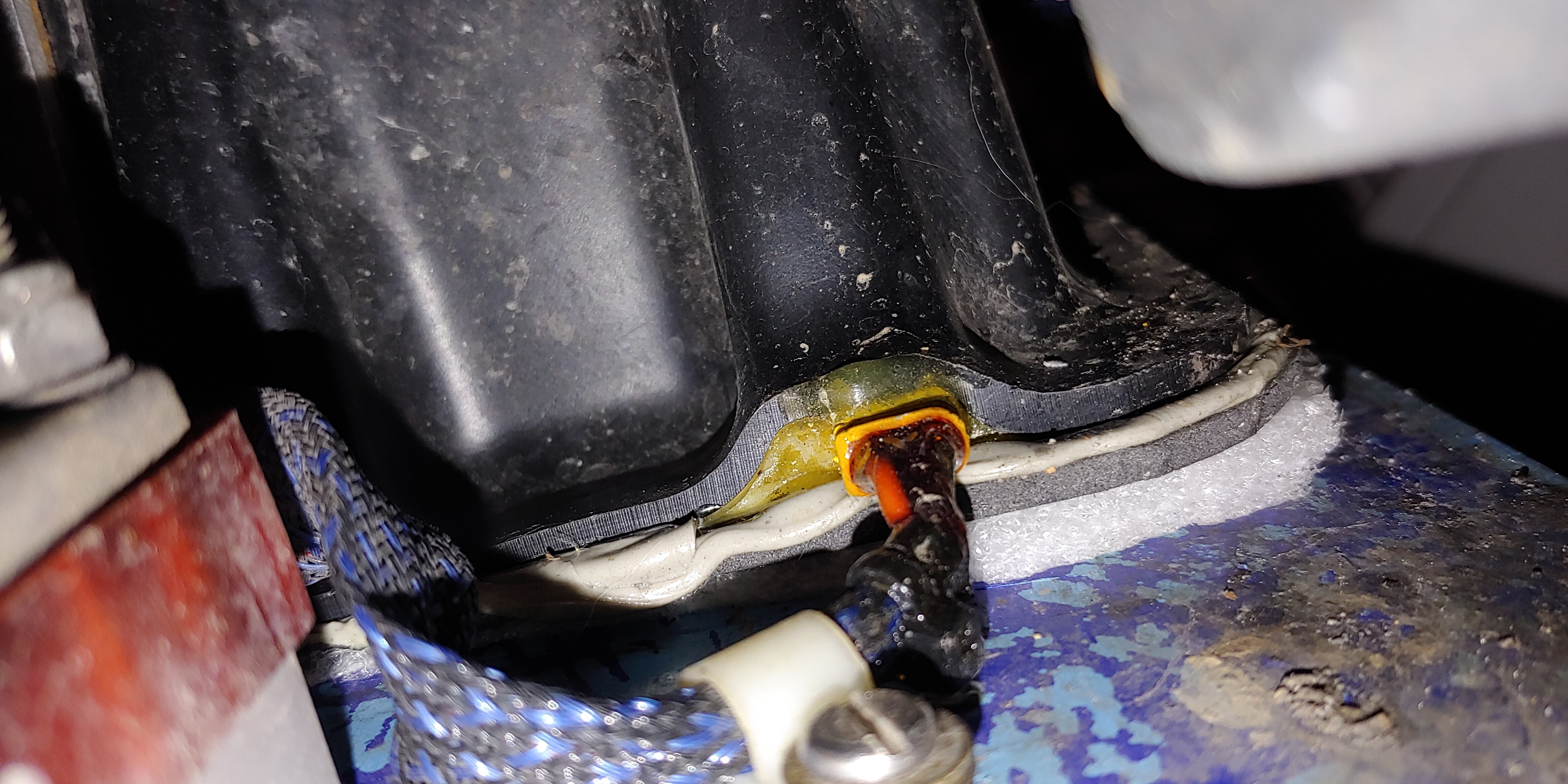

lol you would hate these BB awd hummie enclosures I have. Biggest wire channels evar
The last one I did looked like this. I epoxied an XT30 into it also for lighting.
But that same method with fishpaper to make it flat and thickened epoxy under that, with nonthickened epoxy over that once it cures, just to ensure no leaks, and butyl tape on top of the flat afterwards

Thanks for the advice on butyl tape I’ve seen in some other topic
Its working wonders :slight_smile:
I do hate that indeed, i filled em up :rofl:
