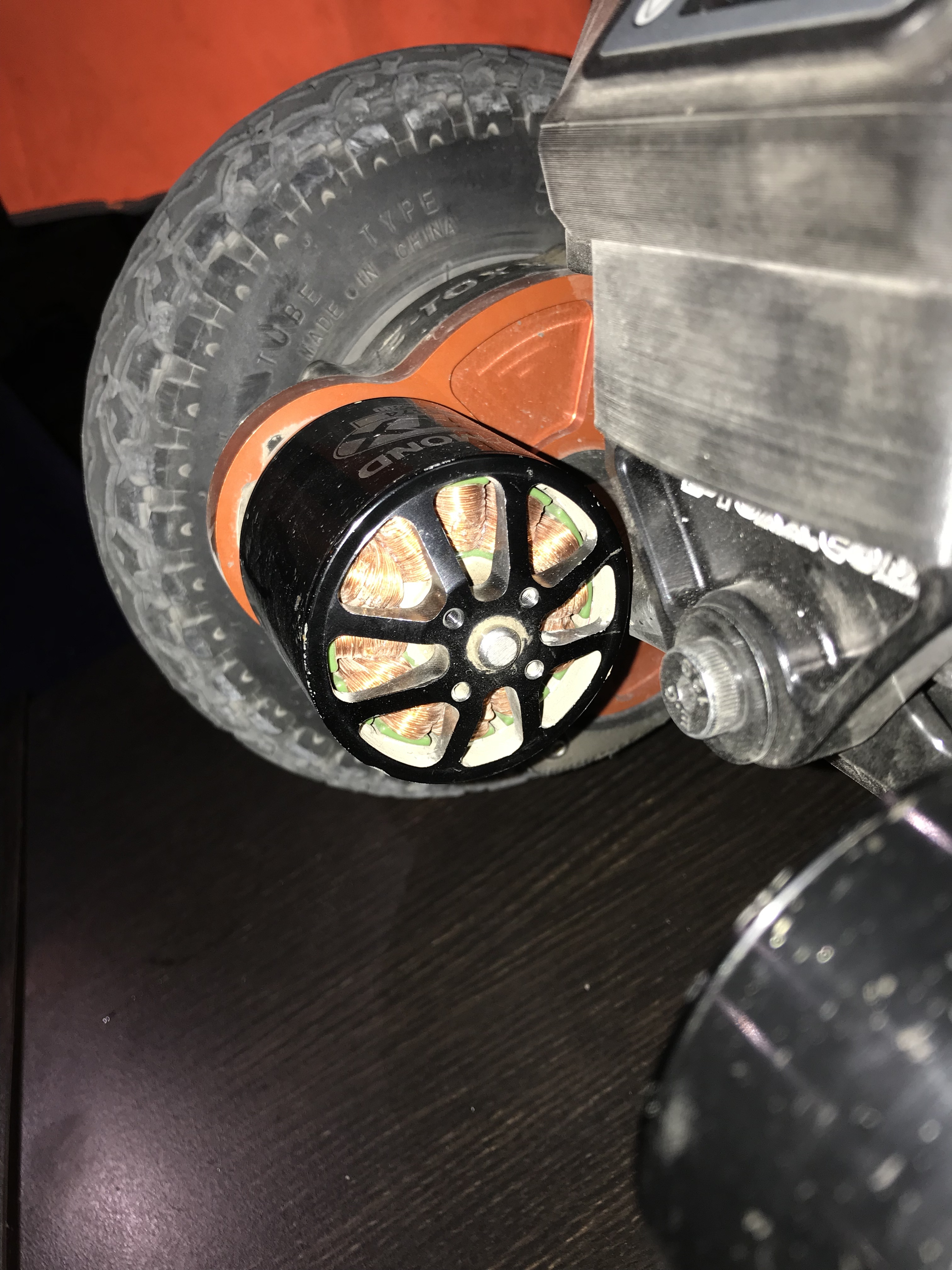

I have tested the gear drive with 1:6.25 gearing and 200 kv Dymond AL 6374 motors. Man that had punch and made fun :grin:
what was the top speed of that thing?
Loaded speed topped out 50 km/h on matrix II trucks and 9" wheels. Theoretically 62. And it had the as5047 magnetic encoder for sensored on board. The dymond motors have more copper windings than other motors I know.
oh nice, i spoke with Jen from Etox and he has sugested me 8/50 helical gear drive for my 192kv motors and 12s7p build
that gives 6.25 ratio and aparently gives good efficiency/ what are your thoughts on this?

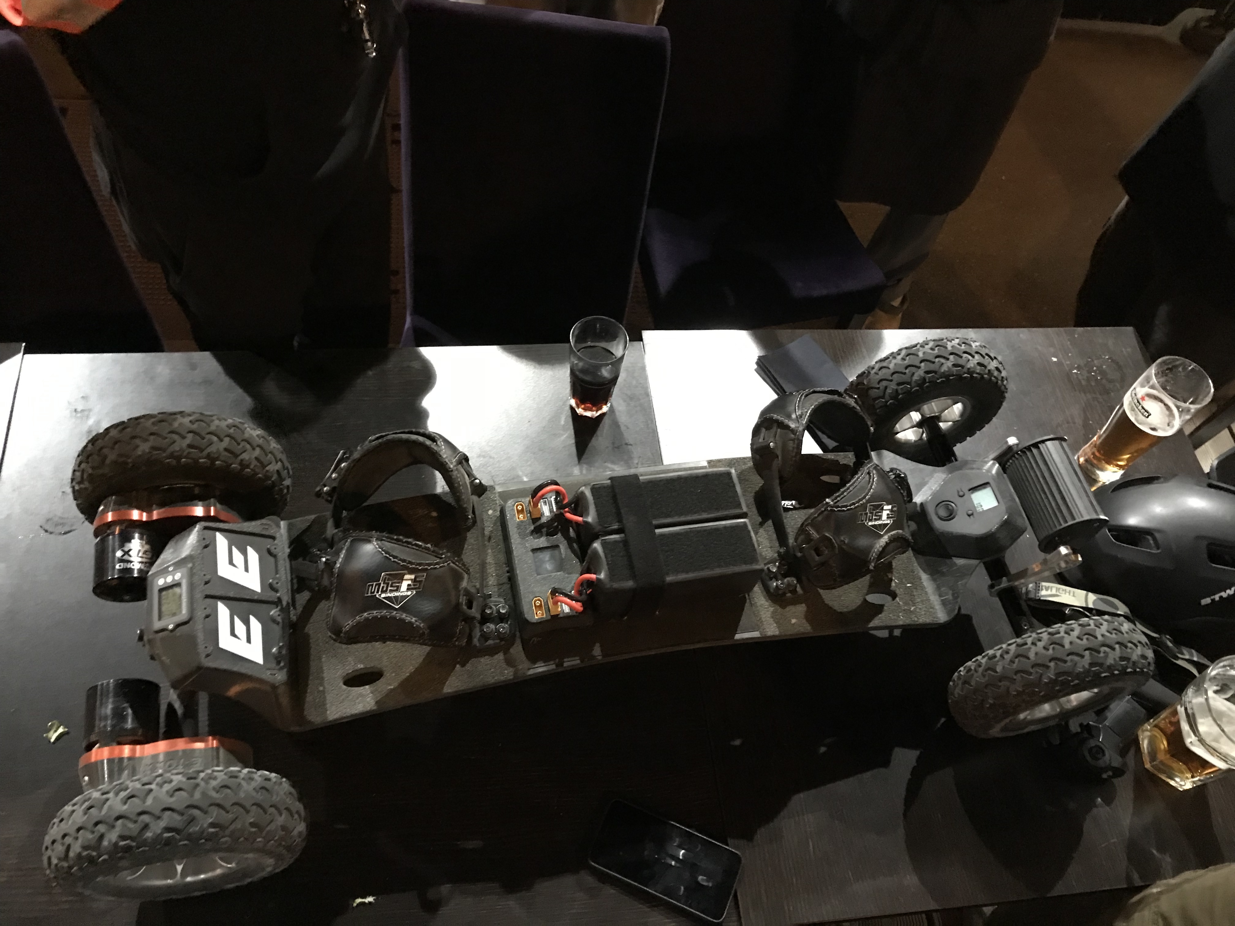

Dymond motor 6374 on @Duffman board

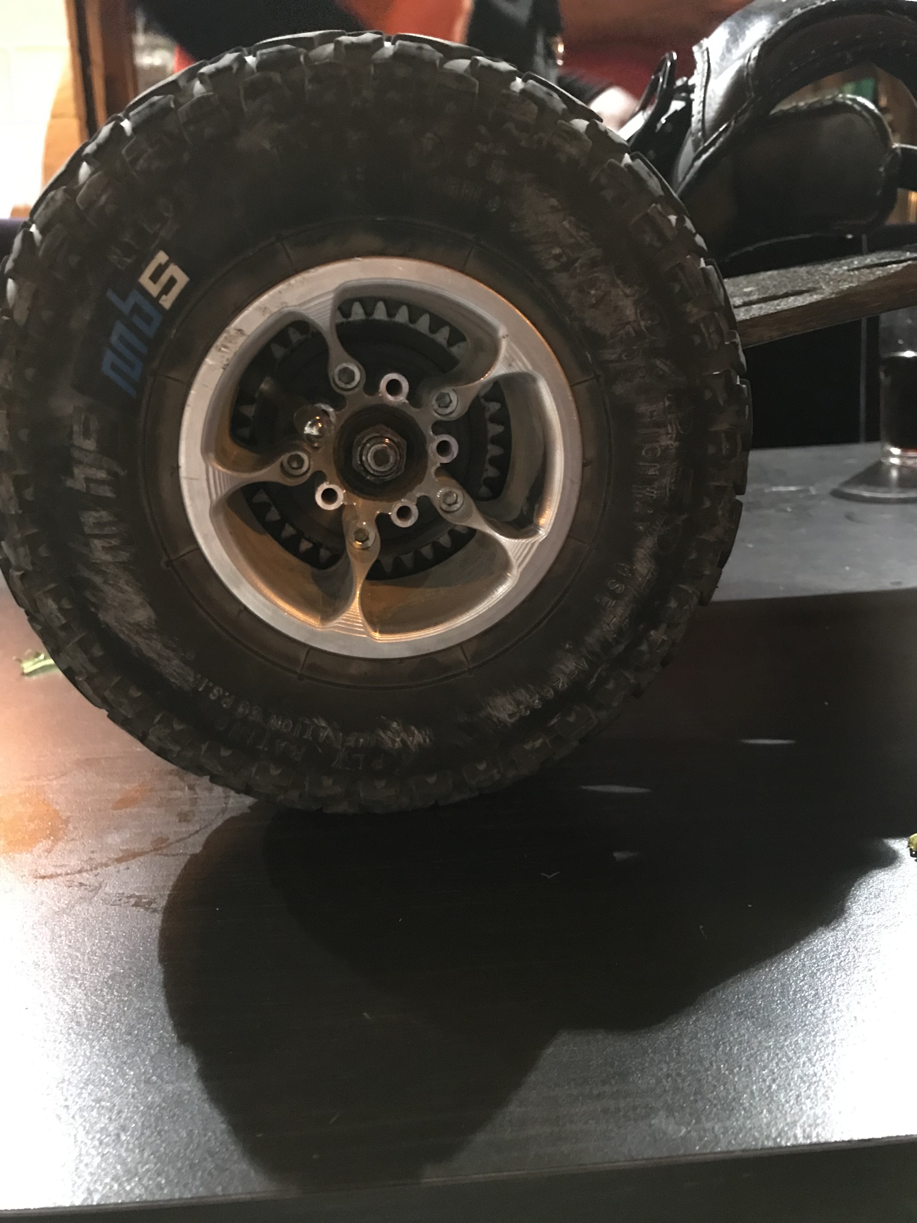

what tyres do you have on there that looks sexy af
You are right.
Not my board. But I happen to have a picture of that too.
Those wheels are custom made too I think.
Thst are tyres from mbs. The rest says @esk8manbabes
