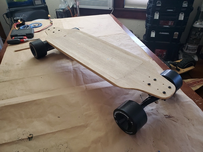

Double stack integrated deck I’m using atm
While on shut down I played a little dress up with the test decks before I sent them out. All testers will have their decks in less than a week and then let the games begin. If all goes well, I will do revisions and do a small batch for others interested. I can’t do anymore for free, but we’ll figure out a fair price. Thanks again for all of the interest. I’ll keep working to make them better. I’m really excited to see all the different builds that people might do with them :slightly_smiling_face:
That kind of looks like it has a hump. If you paint mine black it would look similar.
if you make a double stack I will gladly send it to @Sender to get his magic on it and then I’ll move the guts from my existing to this one :wink:
I can do these. For the most part I just have to stack more veneer. I get 46 inch veneer right now and cut it in half to make the compartment. That way I get two layers out of one piece. To do double stacks, I have to use full length veneer. It just costs more and will increase the weight, but it can be done.
