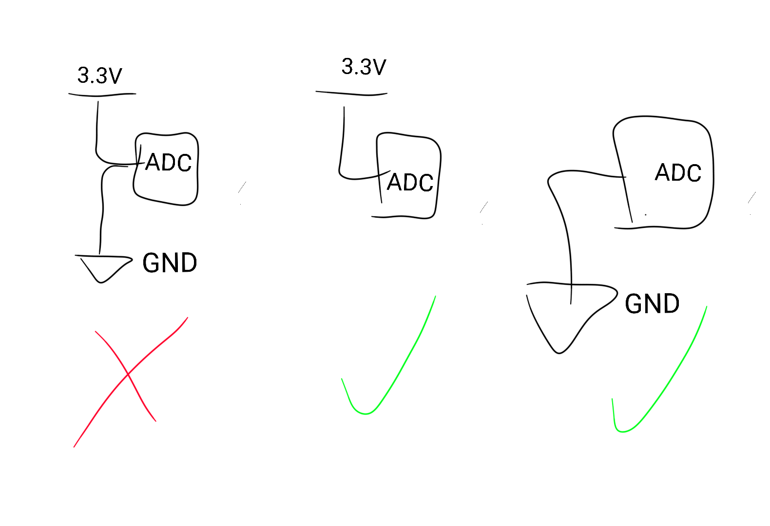

Well, this is one of the worst day’s I’ve had in a while. Was looking forward to testing and I find out the cables I got are slightly different than what I needed.
I still wanted to try it out so I got a wire and shorted the 3.3v straight to ADC1 and then shorted ADC1 to ground to get a reading range with the center at 1.4v (for some reason that’s the voltage it reads with nothing plugged in).
Now if I short 3.3v to ADC1, the motor spins up. When I short ADC1 to ground… it gives the same braking power as when using PPM input.

Since I didn’t know if BLDC mode would move the motor, I shorted 3.3v to ADC1, which I knew was a bad idea but I only wanted to touch it for a second. Motor nearly gave me a heart attack.

Oh no please don’t do that! This is a short directly to ground, and will definitely damage the board. How long did you hold it like this? The wires should have started heating up very quickly if the 3.3V didn’t cut out. Use resistors to split voltages, it’s called a voltage divider
The output of the connection has a 5v output and a 3.3v output. I assume that the 3.3v output is fine to short to the ADC1 pin as its the signal output that’s expected by it anyway.
The 5v pin is the one that shouldn’t be directly shorted to ground or any other pin. Though, I did accidently short the 3.3v to ground which caused the ESC to restart
I think it might be a language thing, I assumed you mean the first setup where 3.3V is shorted to both ADC and ground but maybe I’ve misread. If it’s short 3.3, remove 3.3, short ground, then yes you’re right
When you say the connection, do you mean from your micro to the VESC ADC? I re-read the thread to try and find a specific interface or something you’re referring to but I’m still a bit hazy there. For my understanding do you mean the micro can set its PWM/DAC output to be 5v logic and 3.3v or is it like a prebuilt throttle controller off an ebike or something?
Oh, not at all. I only had one wire. I shorted 3.3v to ADC1 to get the high signal, then took the same wire off to then short ADC1 to ground to get the low signal.
I mean the ESC has a port that offers 5v, 3.3v, ground, ADC1, and ADC2 pins. The 5v is to power whatever you connect to it, and the 3.3v is the signal it expects to be rerouted to the ADC pins.
