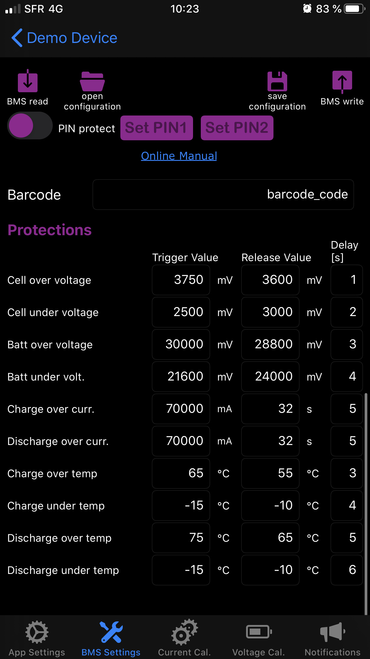

I think the LTT bms has all those smart features you mentioned on IOS too, it’s just a paid service (I paid around 6€ to unlock those, although the app itself is free.
I agree that the UI looks way better than on this than the android version.
This is probably an updated version. Looks cool. I’ll take a better look at it and update the info in the initial post.
i wish the dev would port this version back to android. i would happily pay some money for a paid version that is better than the normal android one.
