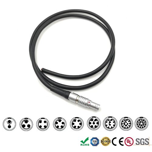

Everything you need is right here… props to @rosco for the links.
Expensive, but by far the best solution i’ve found. And these ones are pre wired :ok_hand: i like to run the wires from the port to a male jst and put the female jst on the battery.
Egg 1B 12mm balance -
Male plug link
NZ$ 15.27 37% Off | FGG 0B 1B 2 3 4 5 6 7 8 9 10 14 16 Pin Male Plug Connector Welding Cable for Camera Power Flying Leads Cable
Dust cap link
NZ$ 12.66 | M12 Connector 0B 1B 2B Series BFG Plug Caps BRE Dust Cap for fixed sockets HGG EGG ECG EEG Plug and socket connector
https://a.aliexpress.com/_mKi1g7L
Belive these are much larger than the ones you had in the photo right? im looking for that tiny monicole sized 12-16pin :smiley:
It’s for a compact shorter build intergrated. so it’s really only just got space.
These are pretty much the smallest you will find dude. 12mm diameter hole.
that’s an xt30 next to it for size reference. Its tiny.
Its worth the money, especially buying the prewired one. Its the nicest plug and socket I own by a long shot.
