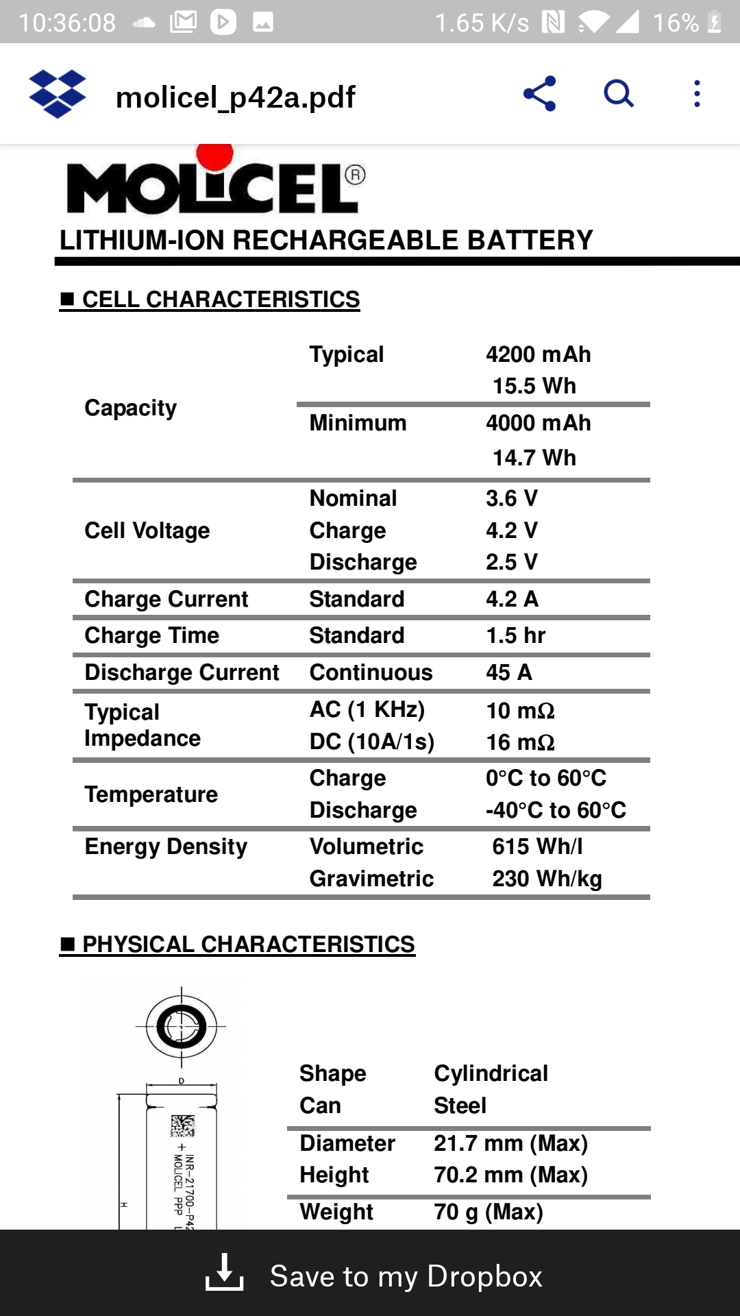

So is it safe to say 25A would be the recommended battery amp settings for P42A? For esk8s context of course.
It depends on how hot they get in your pack, how they’re charged, the cycle life you want, etc.
25A-30A is about a far as I would recommend taking them for okay cycle life as long as they are not stressed otherwise.

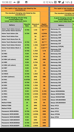

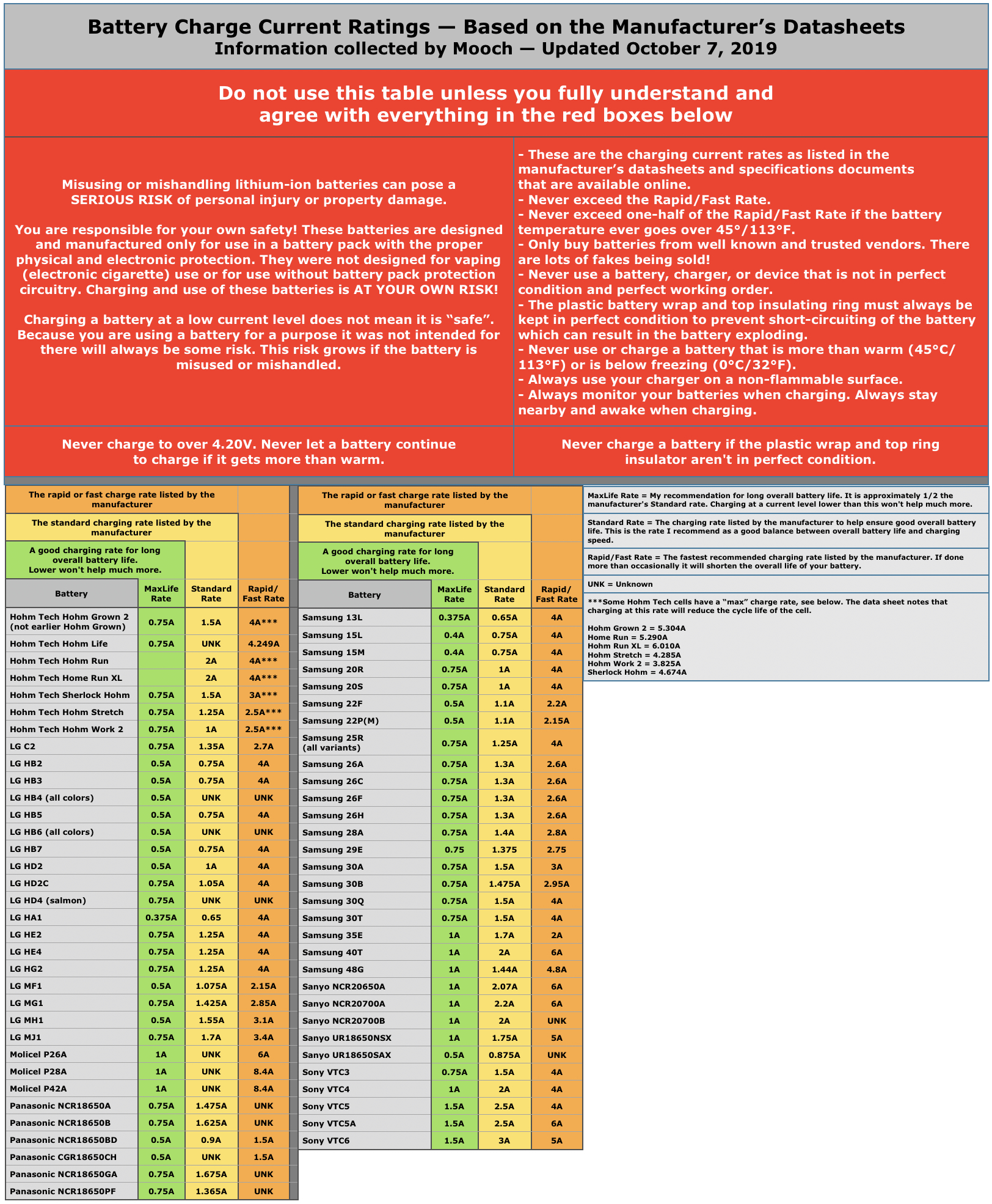

Standard charge rate is 1c, so what is the fast charging rate?
2C ?!
Do you have the rest of that image that isn’t cropped off? :smiley:
https://www.e-cigarette-forum.com/blog-entry/battery-charge-current-ratings-table.7823/?fbclid=IwAR00pzhDoTl-vTS0QPThUEd256zhBrFtdGEoHVTBuEFNlPsSZQeeprT00Xg
The fast charge rate is shown in my table. :slightly_smiling_face:

the 12S4P p42A pack I’m building for the bustin sportster will likely get set around 20amp/cell continuous. 80A battery is more than enough. Max Ill set it is 120 amp or 30/cell.
Dont run these at 45 amp or close- its really not necessary. For 4AH 21700 cells, its still essentially in a class of its own for 20-30 amp discharge without the thermal issues. While it and the 40T can both handle 25amps, the p42a should do it a few degrees cooler
