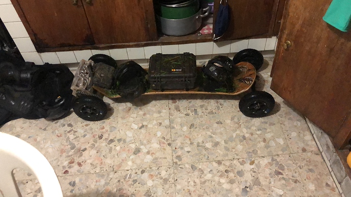

MBS COMP 95 / FOCBOX UNITY / SK3 6374 / 12S4P MOLICEL P42 A (NESE 2S4P) / PELICAN 1200 / NANO X / CHAIN DRIVE ISO6B
Clamps are ready
With my configuration it would make sense to put an anti spark xt90, I would limit the current to 90a when the battery could provide 120a, is it enough with the one that comes integrated in the unity?

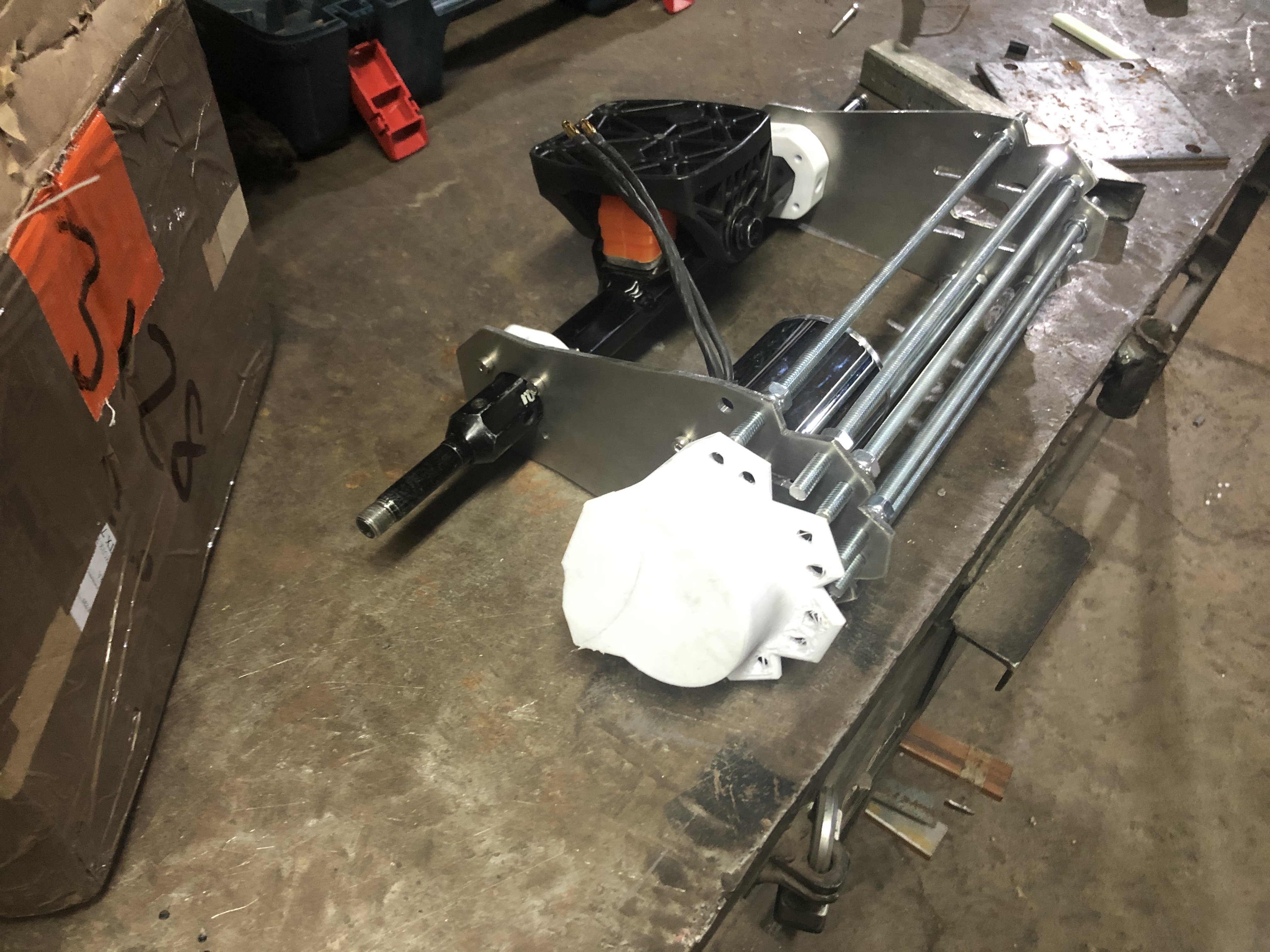

I wonder if there will be a problem with the motor magnets and the threaded rods; I was thinking of putting heat shrink on these to get them to repel a little
It has been some time since I no longer published updates but here is my progress
I have almost all the parts, I only need the nese modules and some connections for rgb to arrive; I tried to solder the rgb but they are a pain of balls
I think I may have the adapters tomorrow from a local electronics store and if not I will have to go to amazon
For the led strips I will make a channel with the rauter and then cover with transparent epoxy; I can get cheaper resin for encapsulation but I don’t know if it works, if anyone knows speak right now
I don’t know if I should make the channel right in the central part of the roof or on the sides; I think that if I do it in the central part, the roof may lose resistance, what do you think?
I had some advancements in the motor mount and align and fix one, I am waiting for the glue that I put on the clamp oppressors to dry so I can put the other since I do not want to move it much, I think I will put a little heat shrinkable on the bar threaded to prevent it from affecting the magnets of the magnet (since nobody answered me if it affected or not so I will suppose the worst)
Regarding the wheel sprockets, I took them to a lathe workshop where they helped me make the 5 holes for mounting and remove weight by expanding the hole in the axle, they only charged me 15usd to do that and make the taps for the motor sprocket.
I had to manually modify the covers for the engine sprocket since with the spacers there was a very small space between the wheel and the cover and I was worried that if the tire suffered impacts it would rub
I also printed the box for the focbox unity, I forgot to put the hole for the switch but it was easy to solve it with the hand drill
I am making a stainless plate to put it as a cover and thus fix the unit and it works as a heat sink
Also lengthen the motor cables and solder mt60 connectors to where I will directly connect the bullets from the unit
I proceeded to paint everything with a spray, I hope the painting lasts

That esc case looks sweet dude.
Thanks I think it looks good but I don’t know how it make the work, I have a mini case for the vesc if it can work good
today I updated the unit for a ubox and the sk3 192kv for freerchoby 6384 100kv this configuration kicks like a donkey hahaha I love it
I had a problem in the ubox configuration, I could not configure in the Windows application, but on the smartphone I had no problems.
