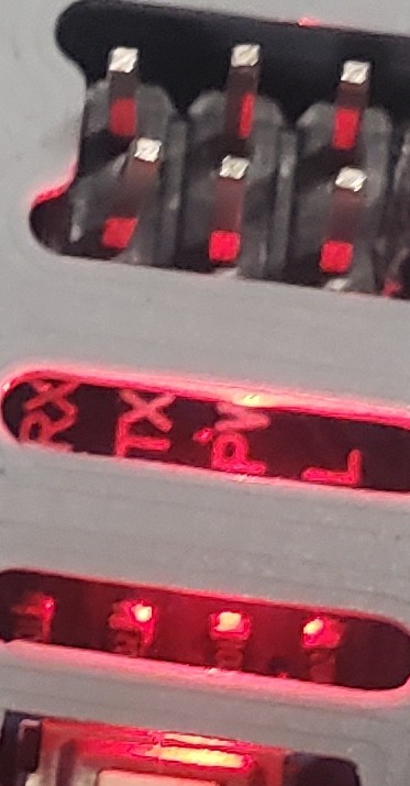

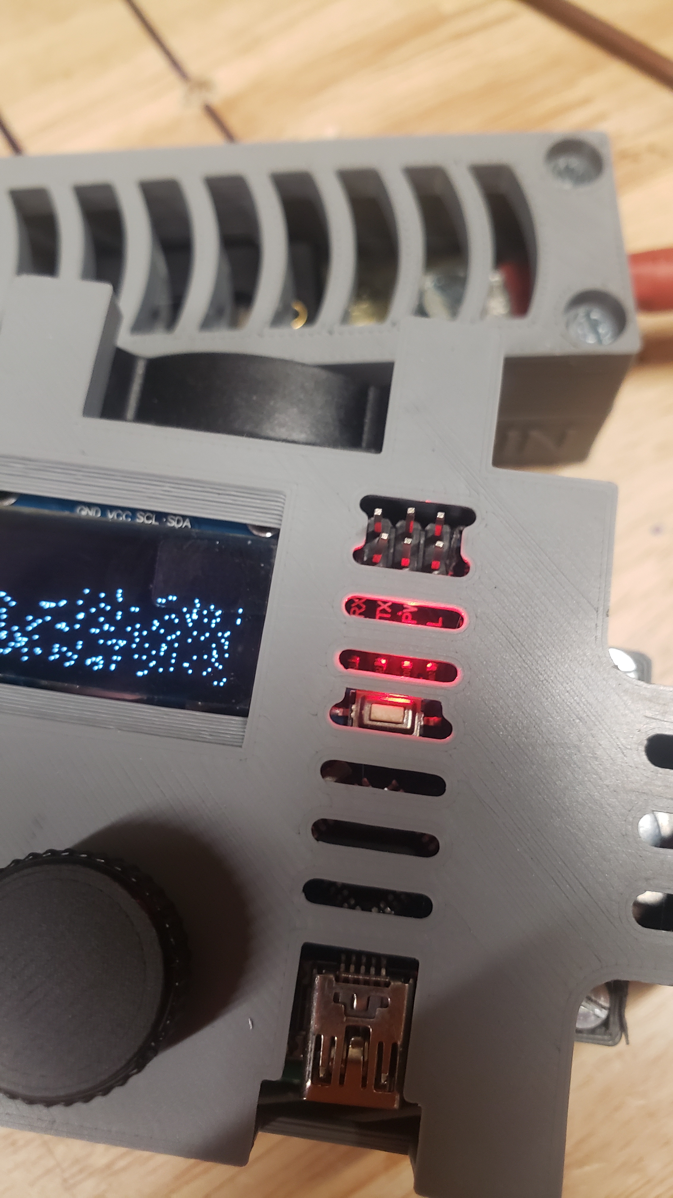

Hmmm dropped some nickel across these 6 pins and now my malectrics seems to be broken :scream: anyone know what’s up?

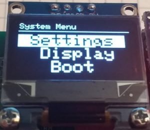

Something is fried. OS looks shot too. Warranty?

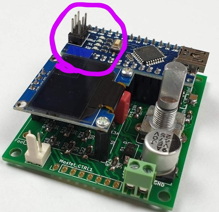

Not sure…I wrote them an email…that’s weird that those pins are exposed if shorting them ruins this thing
those are the pins on the arduino nano board. i’m hoping that even if you did short something you only fried an easily replaceable $3 board
I dont know much about these things, do you think if I bought another nano, and just replaced the one on here this thing would spring back Into life lol?

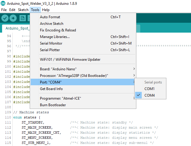

That, and you’ll obviously have to flash the appropriate code onto the new arduino.
But yea, once you’ve done that with any luck all will be working again.
