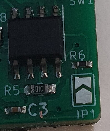

Do you guys think LLT/JBD would listen if we (I) would approach them with request to make it possible to switch off internal bluetooth modules with desoldering a solderable jumper?
I am thinkin something like this:
Note that those smd components are 0402 sized so this jumper pad is relativelly small and it wouldnt add anything to the BOM cost.
not everyone wants to open up their board, dig inside their battery pack and do solder work on the bms once the board is out of storage
i rather just plug in the board for 5mins to juice up each month, than to desolder / solder anything on the bms

I am playing with a microcontroller and trying to communicate through the UART port so the baked in bluetooth module would be just something that has the potential to drain my battery. The point would be to not change the behaviour that works very well for almost eveyone else and still have the option to customize it.
