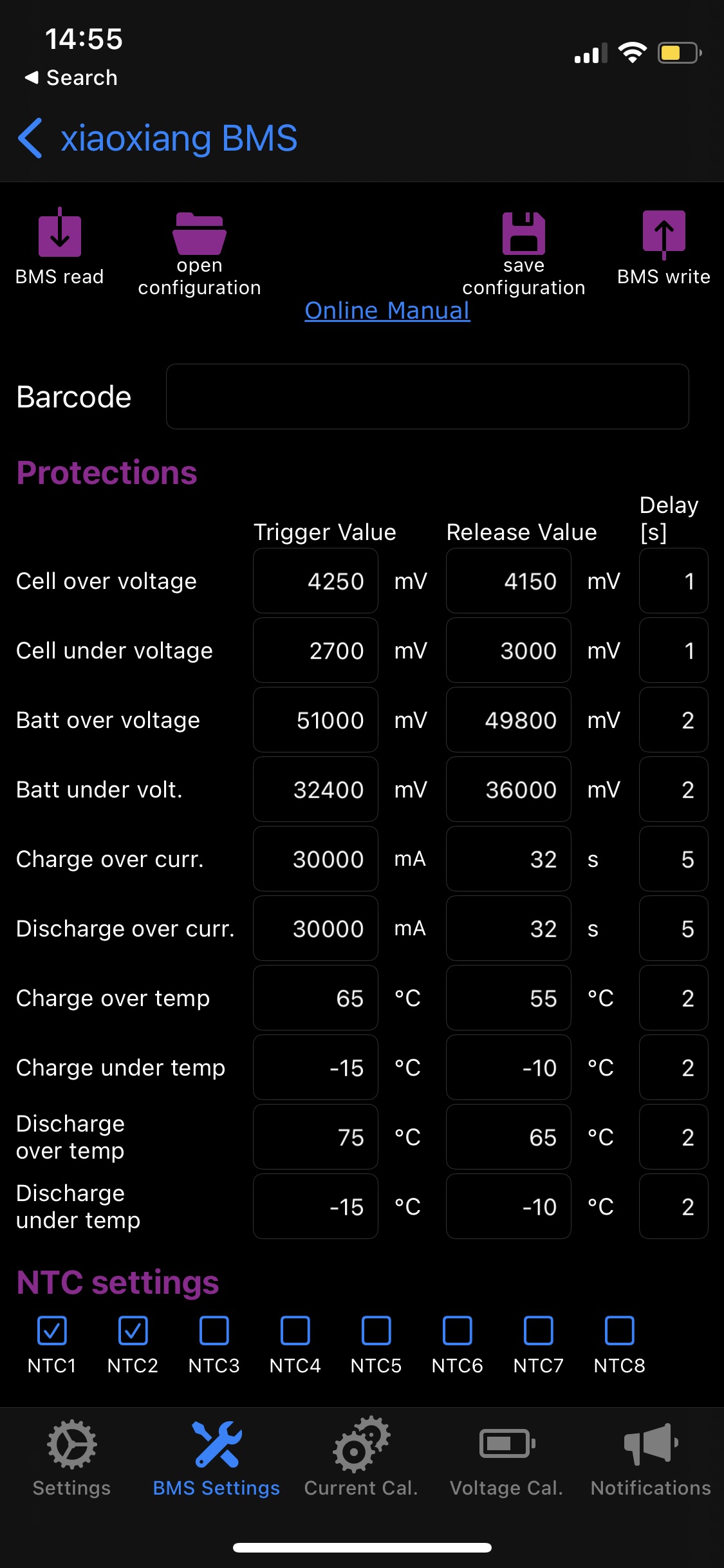

Given that at least 2 batteries from the same builder have suffered the same fate, i’d say it has something to do with the settings that have been applied.
My best guess is that the bms were set to always balance, which is a bad idea unless used under close supervision to balance out a pack with a high delta

even with that setting, it still has a cutoff at which it stops balancing, it defaults to something like 4.1v/cell
i really need to get at those settings.
both of these were delivered at storage charge, around the same time, somewhere around 3.75/cell. so they started low, and sat longer than anyone else ever lets them. so it’s possible the drain from the BMS/bluetooth is just more than anyone expects? but it takes a long time for that to show.

I was able to power on the BMS, by feeding it ≥16.4v on the first and last balance leads.
These are the configs. They look reasonable to me.
Theories put out so far:
# Theory
1 bms+bluetooth modules drains a decent bit, and over a year it could kill 725wh battery
2 bad settings in BMS config cause it to drain unusually fast.
3 Some BMSes are duds and drain unusually fast.
4 bad wiring by battery manufacturer.
