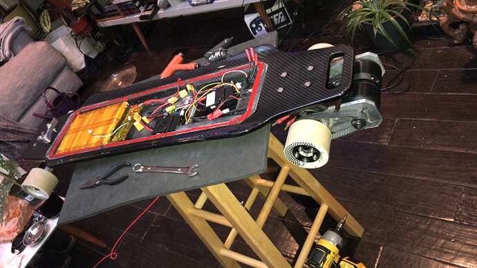

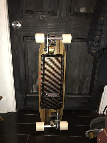

Yeah it’s SUPER confidence inspiring, and has hella wheelbase options. Freaking love it as an everyday board. Just mad that this Unity took a dump right after I made it fast lol. I didn’t even get to max it with the new battery.

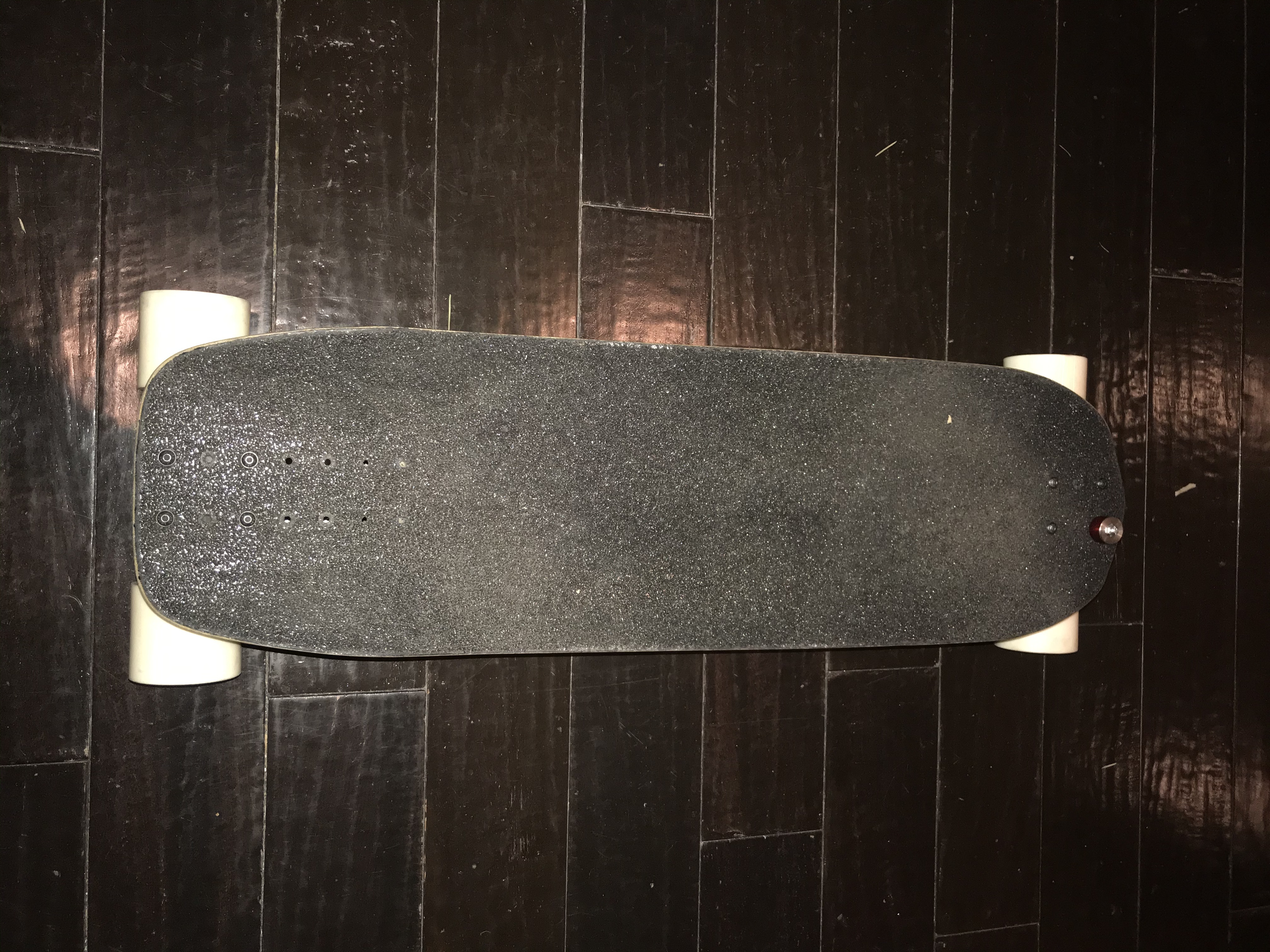

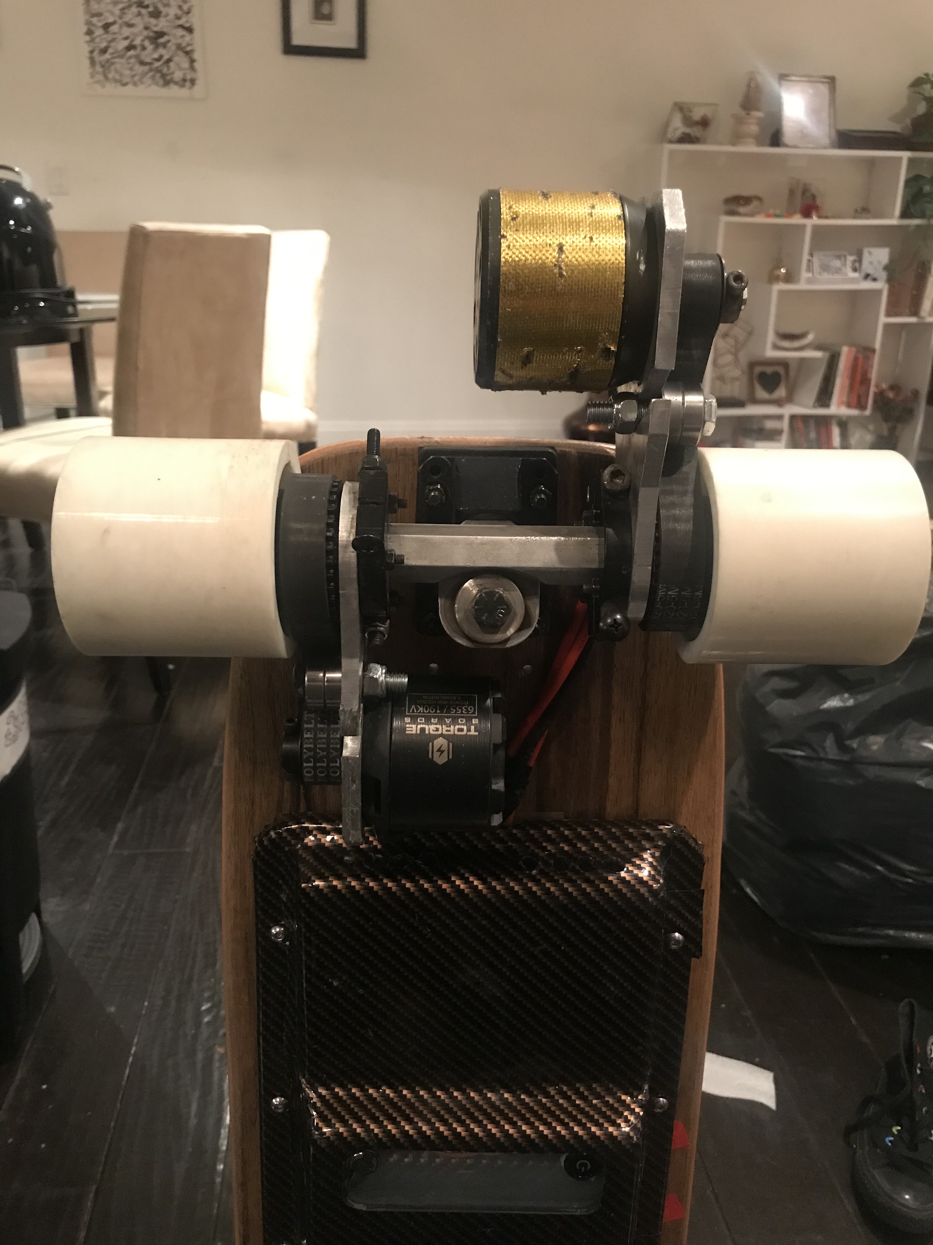

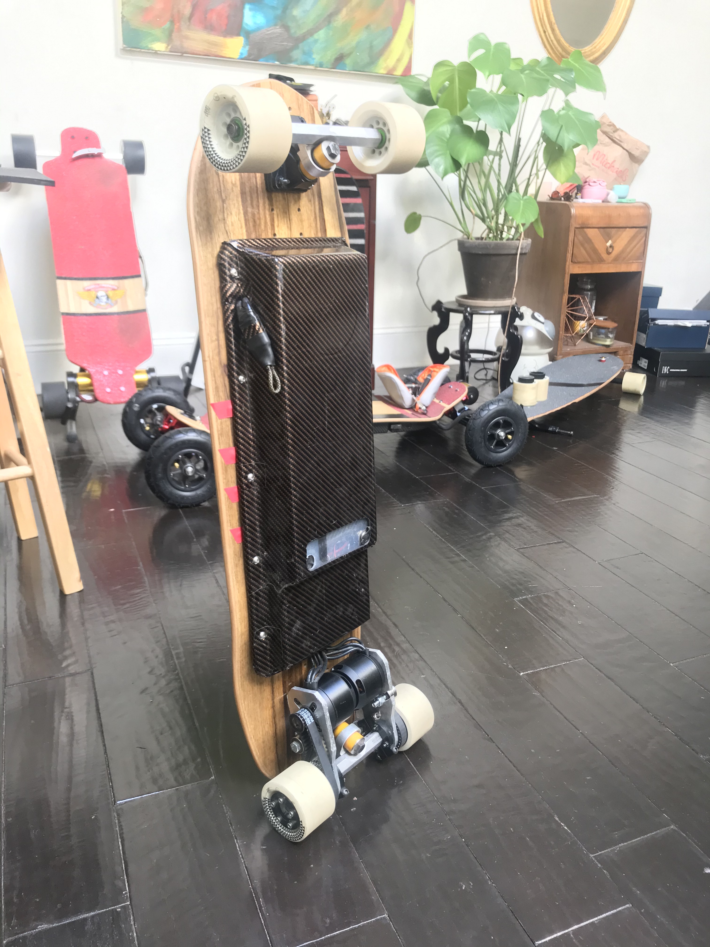

Update, so I got some moon gears and venom mach1’s. In order to make them fit with the 6354’s I needed to switch up the mounting and run dual diagonal. I also changed out the fried unity for two focbox’s I tried to run makerX’s mini vesc6’s but one of them got fried while setting it up somehow :neutral_face::neutral_face::neutral_face:
I’ll take more pics once I finalize setting but right now I’m running FOC 60/60 motor, 60 bat max, and -40 regen.

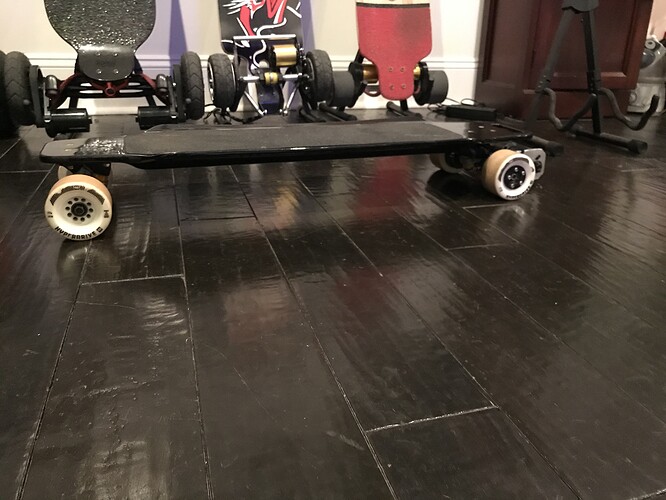

Did some testing yesterday, dual diagonal isn’t for me, really not into diagonally accelerating. I’m going back to dual rear, but I’ll just run one motor out front of the hanger and one out back. It’ll be uggo but it will brake and accelerate straight.
I might try and run the non-idler boardnamics mounts so I can “tuck” the motors better and move up the rear trucks so Its at least a little hidden, idk we’ll see, but it’s not staying dual diagonal for more than another 24 hrs.
Easily the ugliest drive train I’ve ever assembled but it works. Having one motor poke out the back like an old dude’s ball falling out of his shorts is fucking with me.

Idk man it felt so weird to me. All my other boards are dual rear. I could see getting used to it if that’s the only board I rode I guess, but since I usually ride at least 2 to 3 different boards in week I don’t think I could get used to the lack of similar accel and braking on just one of them.

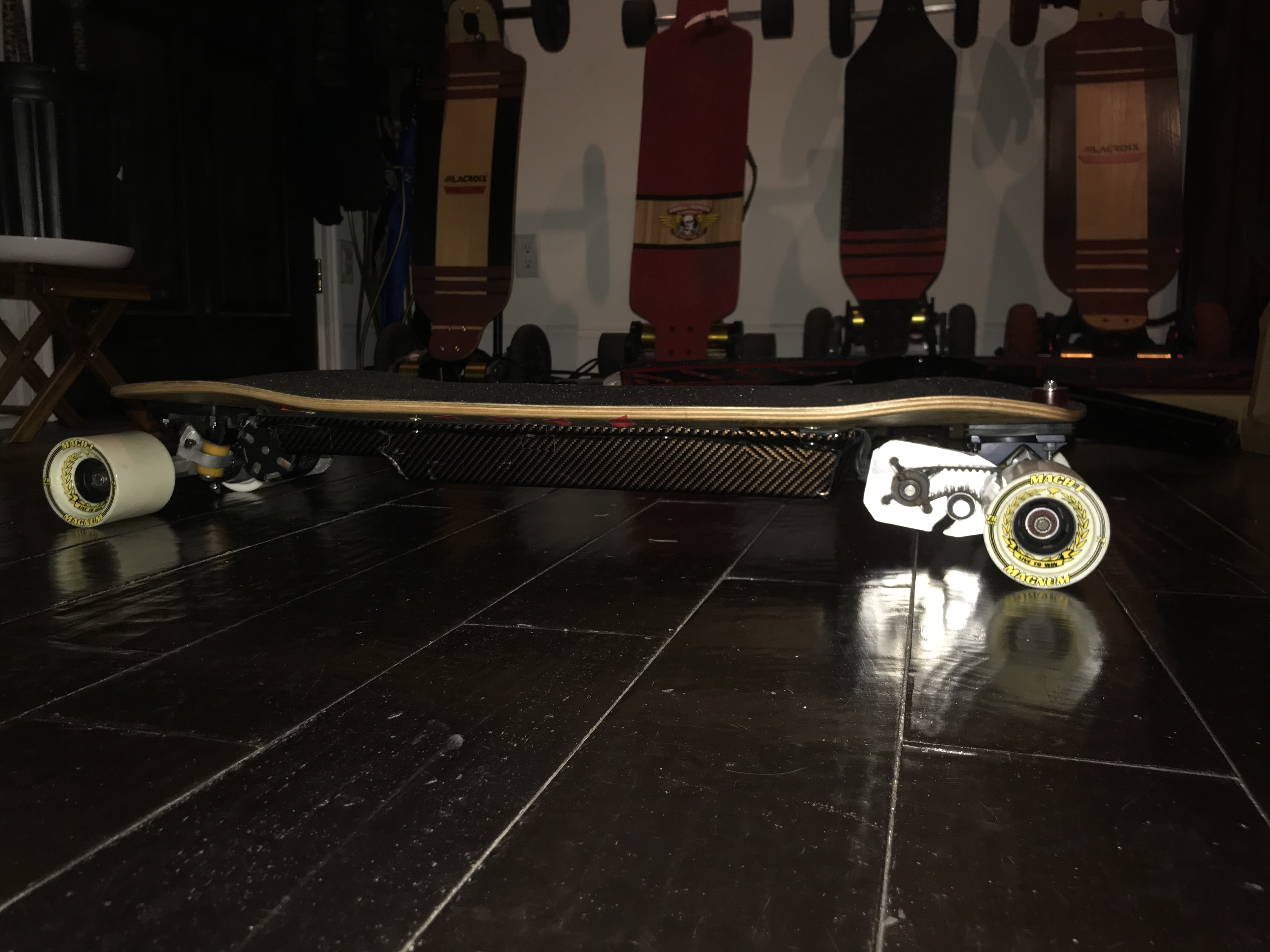

Andddddd I’ve reverted back to what I know works well for me.

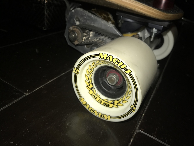

Mach1’s and moon pulley’s weren’t working out (my fault tried to use them for something they weren’t designed for)

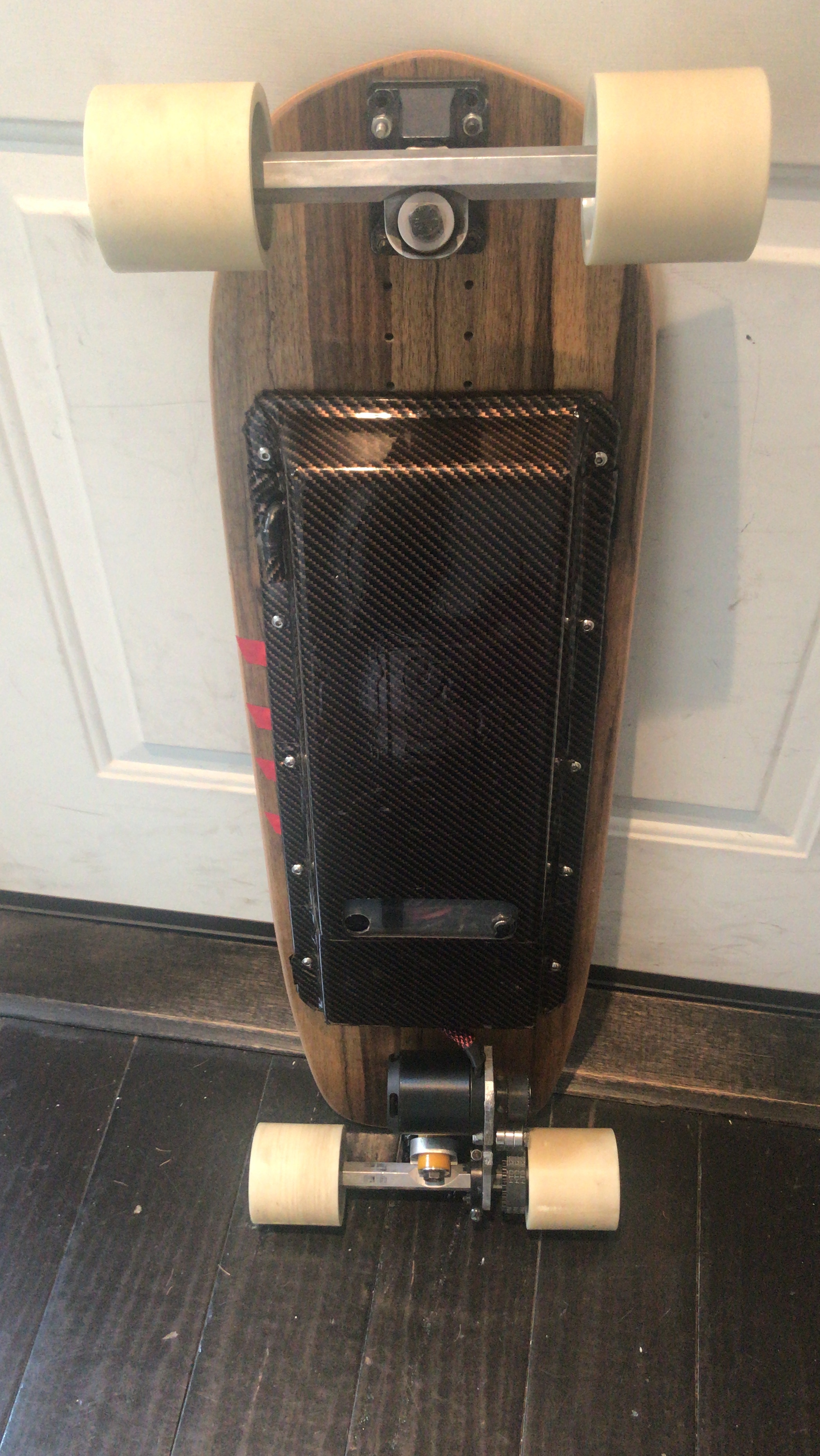

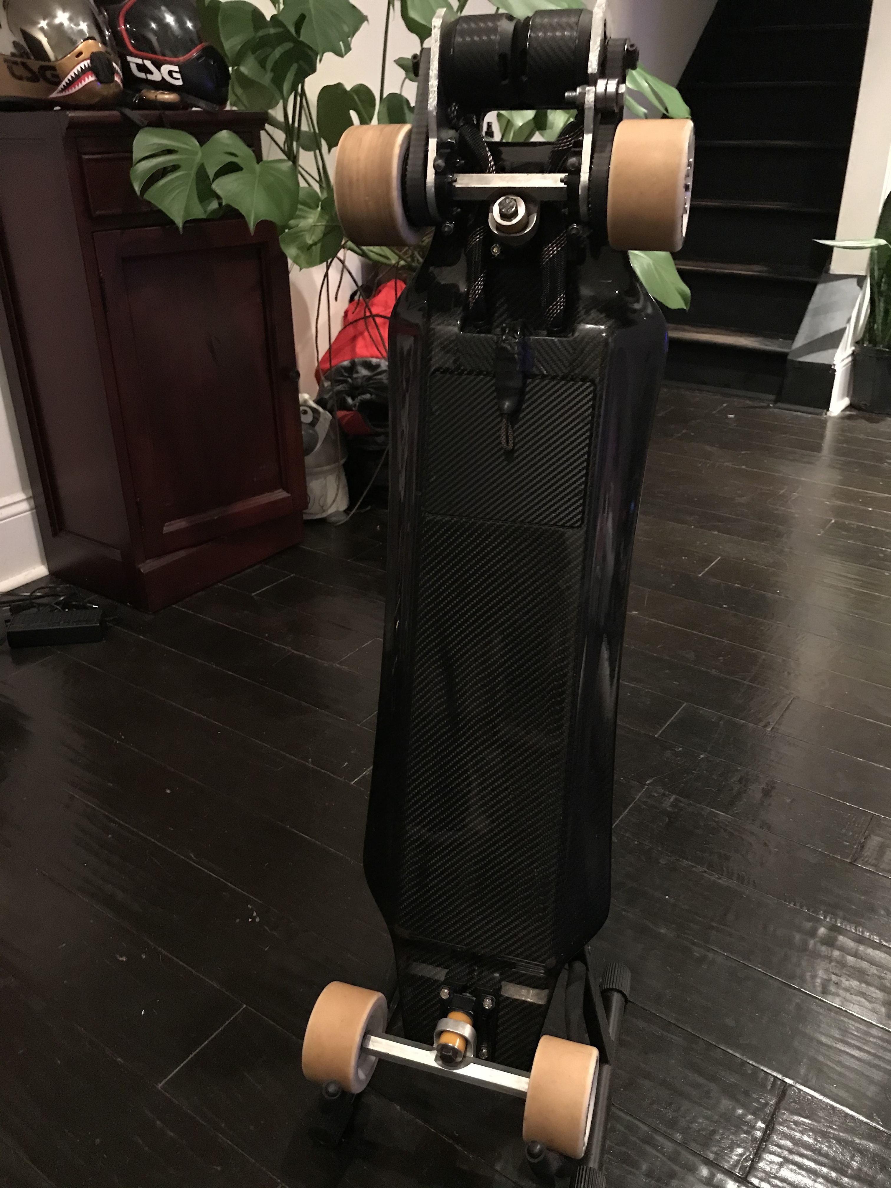

So I’ve gone with another small diameter white wheel ahmyo 76mm’s
Running with 12t motor and 36t wheel for now for thee torques but that only puts me at about 23-25ish mph. So I’ll see if that’s enough and adjust from there. Knowing myself I’ll prob change emm to 14t motor at some point.
Tried to run with single 6374 for a day but decided it wasn’t enough and had the parts for dual with some 6354’s
Pic when I had it as single for about a day lol
What was the problem with the venom’s?
didn’t have enough axel to properly run them with press fit moon pulleys on the SR TKP’s. They’re about to go on that Madrid in the background on tb218’s.
Sweet build I’m loving that deck and enclosure your giving me some good ideas. @Brently did you wrap the enclosure or paint it?
Wrapped. Has held up ok. But looks good from 7 ft.

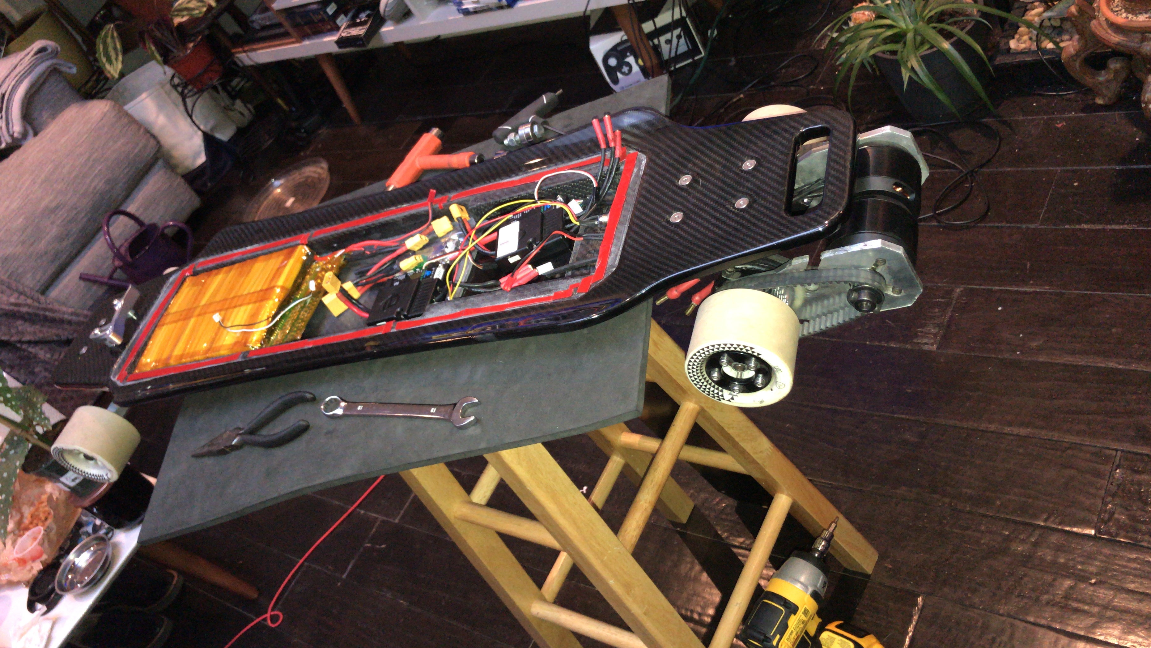

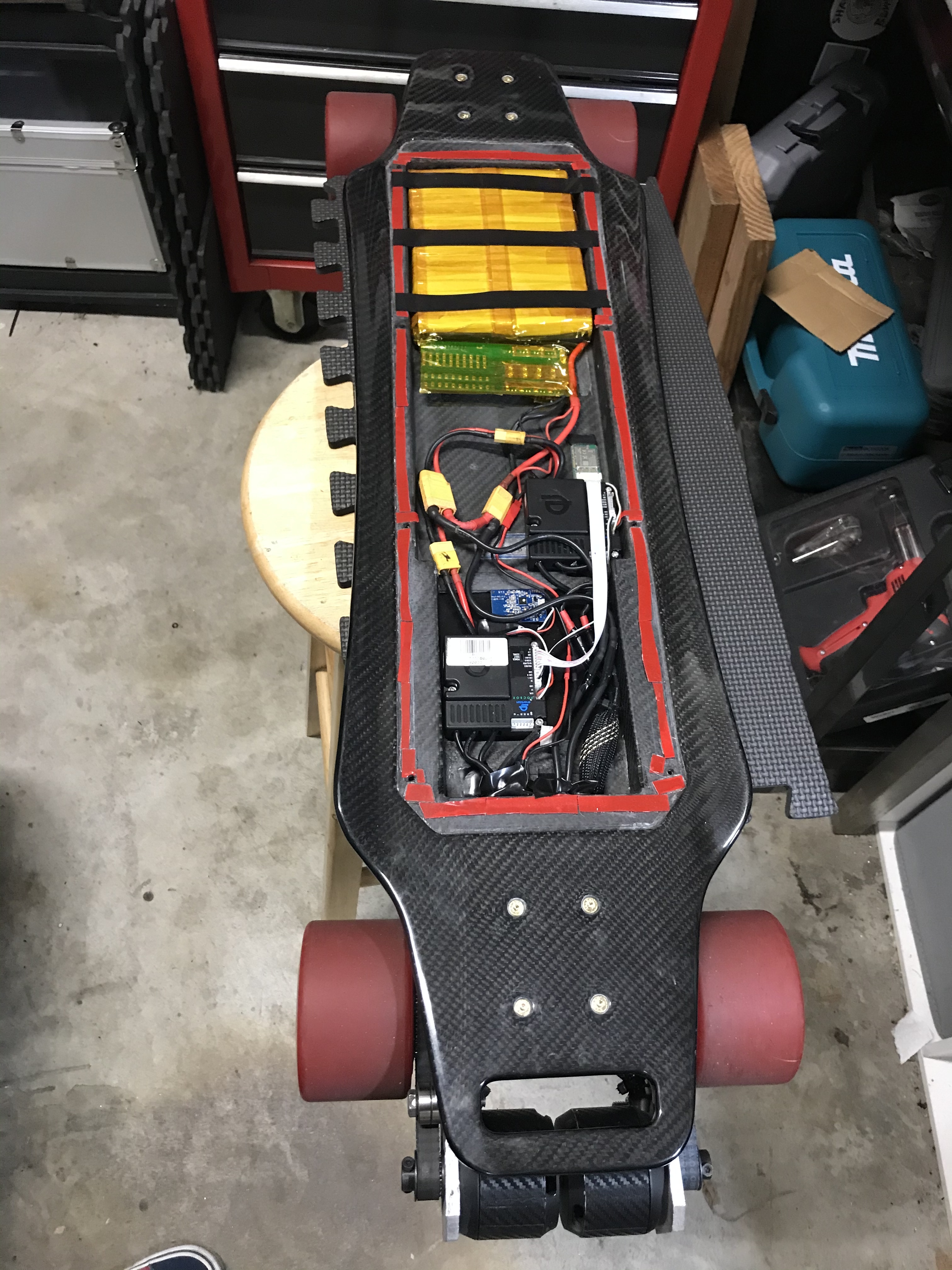

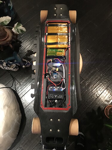

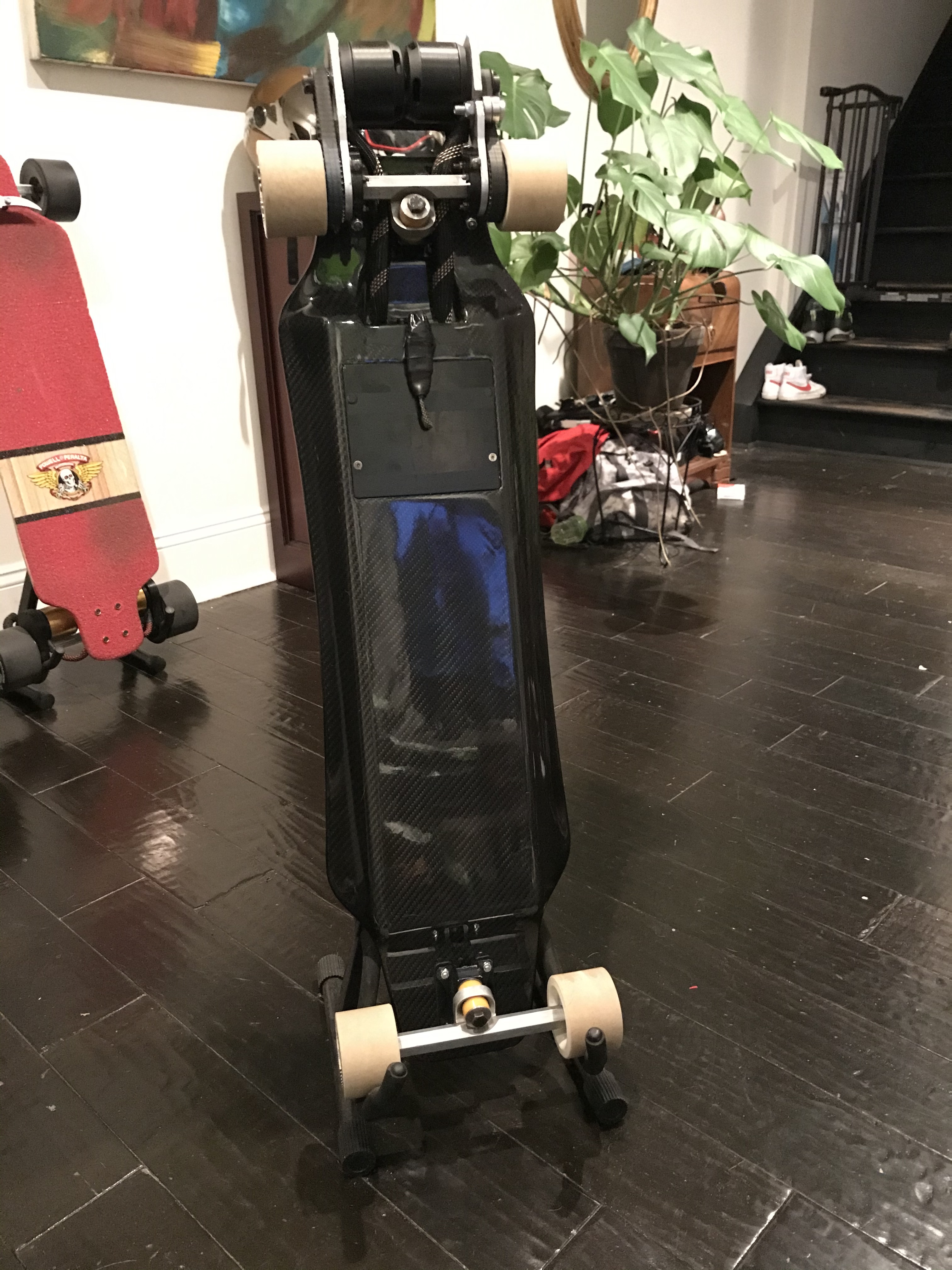

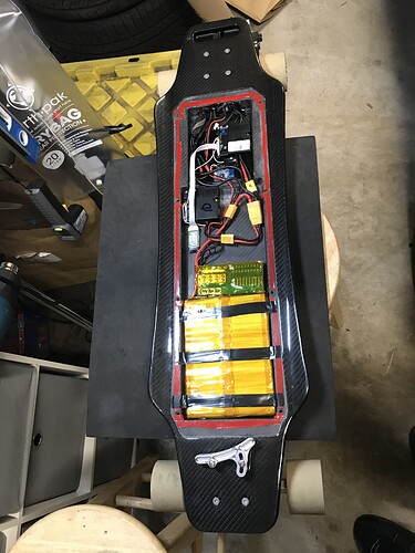

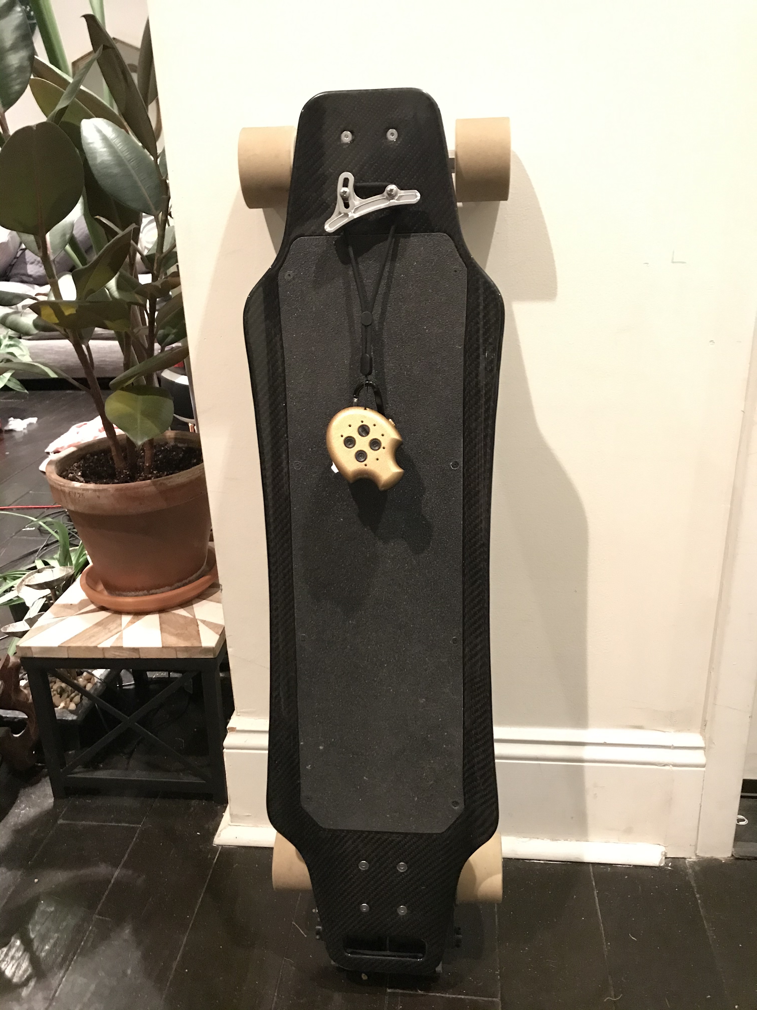

So bit of nostalgia for me, I got my hands on an brand new empty haloboard shell, my first eboard was a haloboard v1 it was a piece of shit(it got returned within a month and I bought a boosted…) but I always remember loving the deck. Moved the drive train and put a 10s2p from when I first got this build going in there with my smallest thane.
I want to keep it low for now but I’ll probably end up putting risers and boas on it eventually. Right now she tops out at 22 :rofl:
She’s lighter than ever as well!

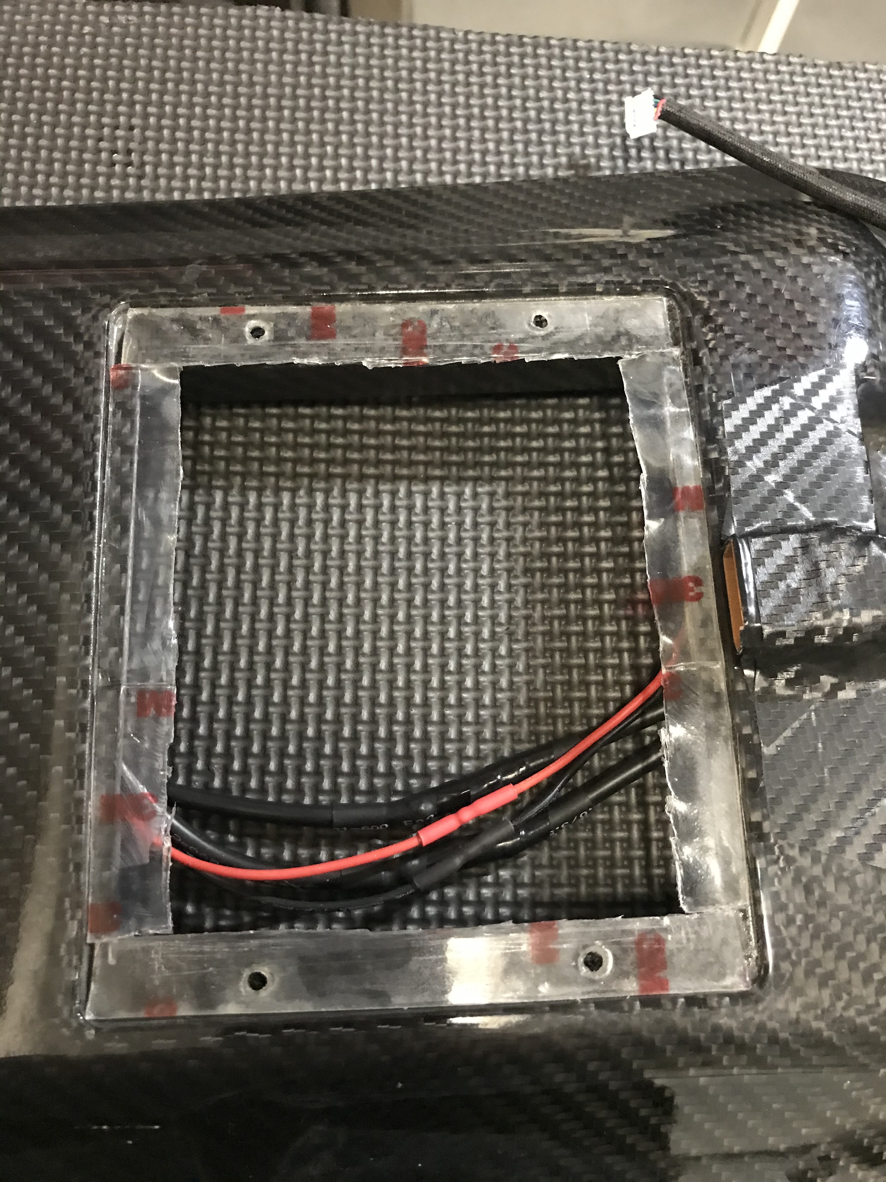

Added a metr pro:

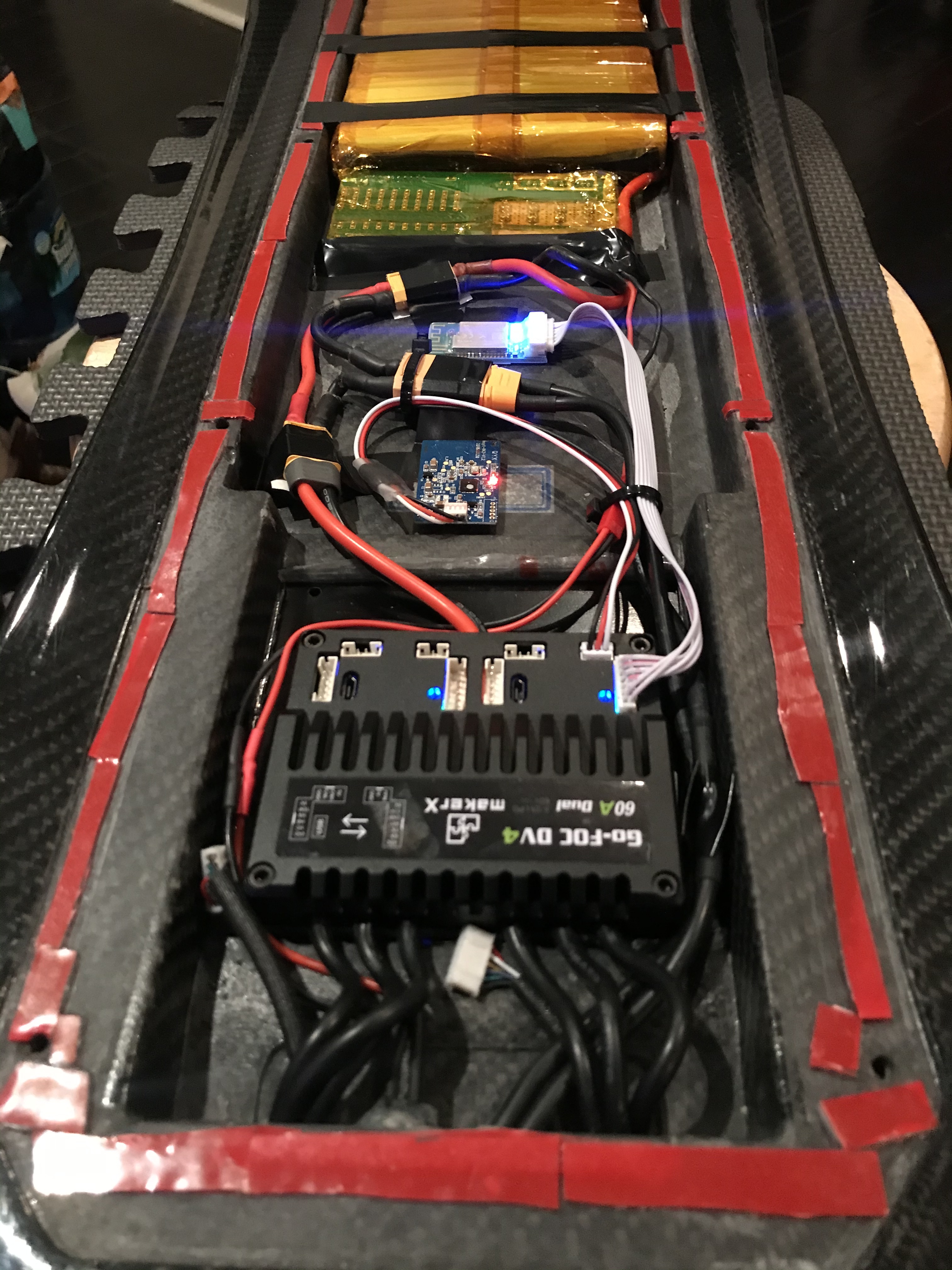

Spent some time on this guy last night. Added a makerx go-foc(yourself haa) dv4 and some 90mm’s. Internal wiring is cleaner now and that makerx fits perfect in the original esc spot.
