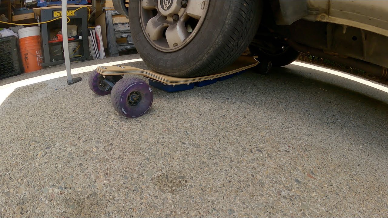

Short Video showing strength of Kydex…definitely scuffed up but no crushing…and yes the enclosures were empty…no batteries.
I think its totally reasonable for the effort and the product provided, most peeps are cheapskates tho :rofl:
Very cool to see a truck run over a longboard - something I think we all fear destroying our hard built rides. It’s definitely good marketing.
However, as a scientific-based test to prove the toughness of your Kydex, it’s not very effective. You’ve got confounding variables here that make it impossible to definitively draw any conclusions. The deck, trucks, and wheels (and built in stiffness) act in some capacity to reduce the weight & force on the enclosure sections. However large or small that factor is, it blurs the results of the test. Additionally, I don’t think most builder’s biggest concern is destruction by truck - it’s probably repeat impacts on curbs, trees roots, rocks, debris, etc.
I wonder why you didn’t turn the board over and run over it again. That would prove the Kydex strength more directly. Or stop the truck directly on top. Or run over the board alone without enclosures to see the difference in height/force.

Sleepless - good points and I’ll see about adding those to the video. I have plenty of test boards I’ve made over the last year that can be sacrificed to the cause. I also have over 1000 miles on my current board and have experienced no failures in the kydex…its been scratched quite a bit and bottomed out over rocks and curbs but have always wanted to run one of them over and thought it may look cool on video. Thanks again for the suggestions.
