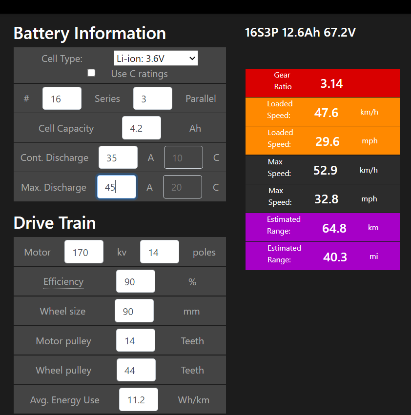

This is what it’s lookin like in terms of gearing for me
I’ll eventually put the momentum 105s on here whenever I get my grubby hands on them. Just waiting for the new batch so I can get em. if I dont like em i’ll go with the loaded dad bods

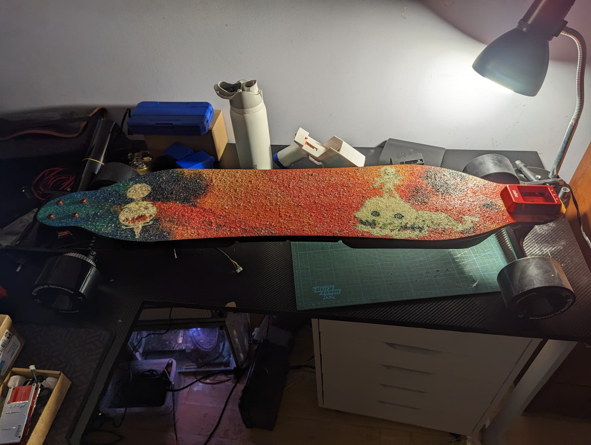

Thank you so much @TheBoardGarage for the phenomenal enclosure mounting work. Came out hundreds of times better than what I can do.
it’s actually crazy that I let this sit for ANOTHER TWO YEARS. Parts list kept changing and I got really busy with school, BUT IT’S DONE! Here’s the final parts list
KSB Senderized Vanguard 42 (Flex 2)
@eBoosted 42" Vanguard Enclosure
16s3p Lishen 21700LA Battery
@janpom DaveGa
@learntofall TB110 78a
@hoytskate ROSitA trucks
Reacher 6375 170kv v4 (thx @DeadLightning)
OG “140A” @YUTW123 MakerX D75
@Boardnamics 15/44 Pullies

16s3p with Lishen 21700LA. The original wraps werent in good shape bc i originally messed up the layout, so I rewrapped them all in 20700b red.
Is it just my eyes or is the front wider than the back? :thinking:
Your eyes do not fool you. That’s how Rosita trucks are
There’s a big spacer on the front axles. I moved the spacer to the outside of the wheel and now it looks fairly symmetrical. Easy fix

Like. The outside nut to nut distance is different?
Yeah
That bothered me some.
I got over it somehow.
Maybe it got better with wear.
Maybe it’s because the MAD wheels don’t try to kill me like TB wheels do…
That is fucked up…
Both hangers are from different projects, technically. The rear hanger is from the skatepark board with mounts and axles that work with larger motors. The front hanger is from something, idk. Front axle is crazy long, I think that they aren’t the axles that the Tabor/Pathfinder ship with. Either way it looks pretty symmetrical now
Oh. Ok. It was mismatched parts.
My OCD can live with that.
