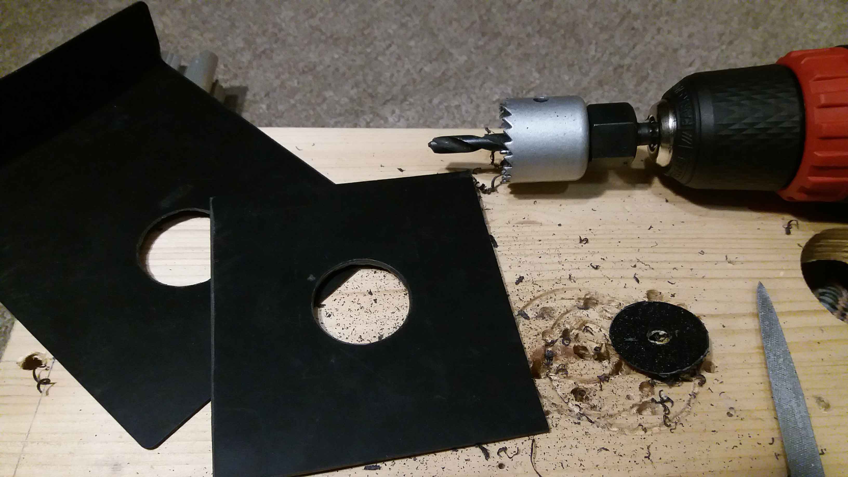

Curved cut-outs look sick but are tricky without the right tools (or would take forever) so why not going the easy route with a straight cut, made a simple template.
started with the small japanese saw
better with the big one, looks like a weapon :laughing:
Well my arm hurts but I’m satisfied with the result

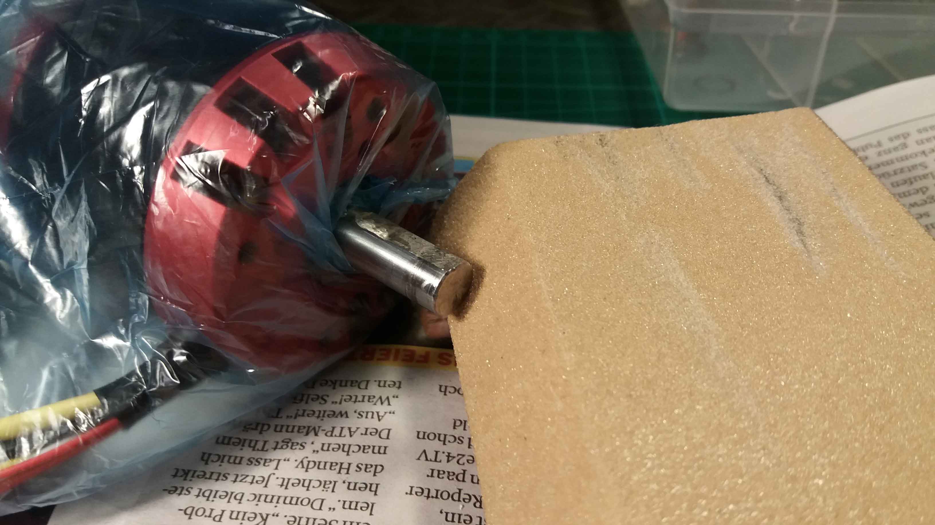

First I had to shorten the 30mm shafts
After cutting several shafts with the dremel I found a better technique this time for getting straight cuts. The bell inside a bag is much easier to work with instead of the whole motor with wires. Also you can rotate the bell if you got askew and get a new chance.
On the left side you can see the slice is askew but on the motor side perfectly straight.

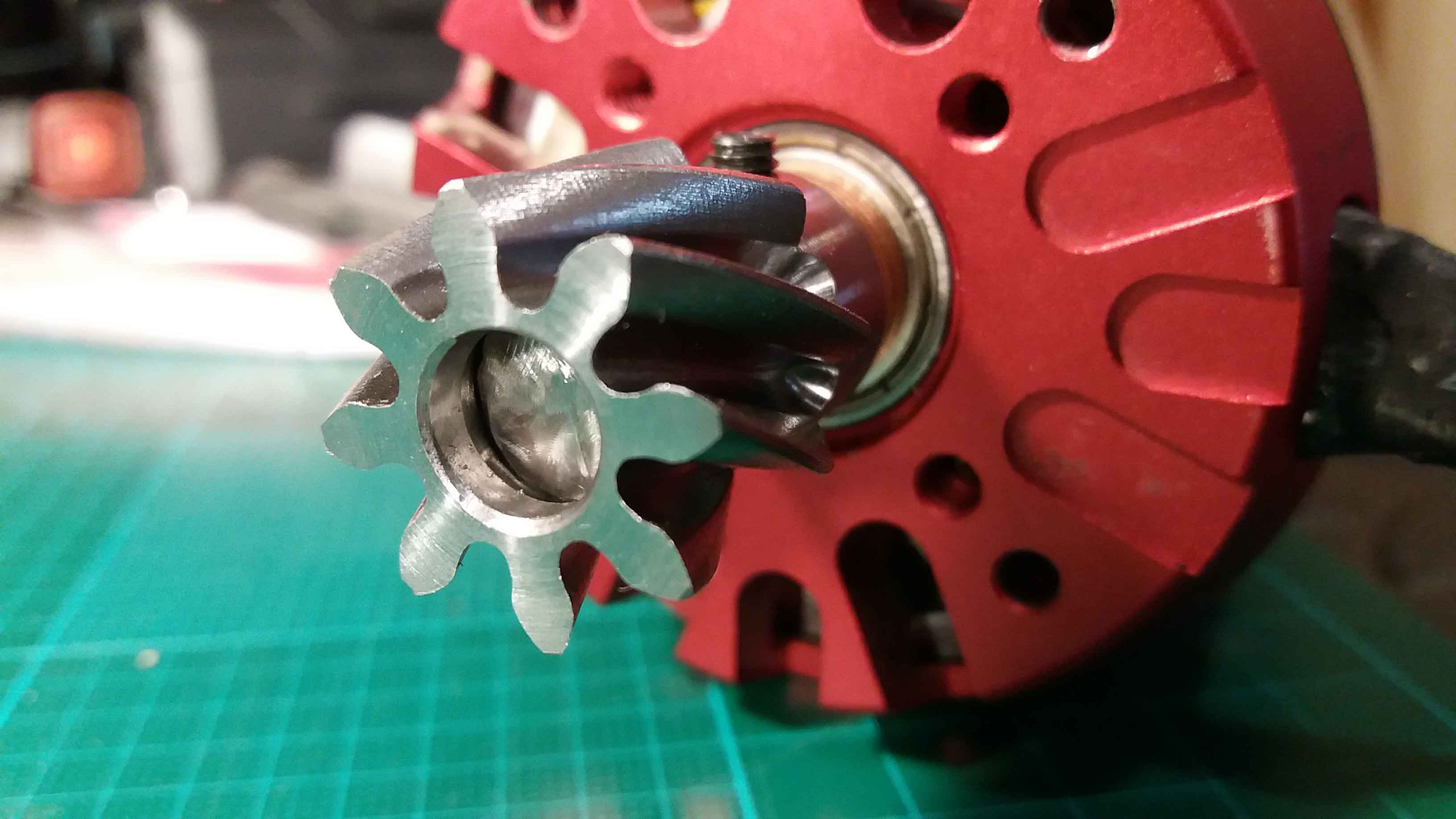

After grinding the edges I dremeled a (ugly) flatspot for the grub screw of the helical.
Shaft length check succeeded
Sanding the shafts and inside the helical with 80 grit sandpaper
Time for gluing
The clamps are perfect for holding the motor without any axial backlash (both motors had between 0.5 and 1mm). If you have backlash the motors will rattle badly on every bump or offroad and move left and right when accelerating/braking because of the side load of helicals.
Marked the flat spot for easy positioning of the threaded hole for the grub screw.
Then glued them with Loctite 638 and pressed them hard against the washers for some minutes. This way there is no chance for any gap and the gear sits straight on the shaft. If I would use the grub screw now this wouldn’t be the case.
It’s done, after 24 hours cure time I’ll add the grub screws with Loctite 243 and let it cure for another 48 hours.

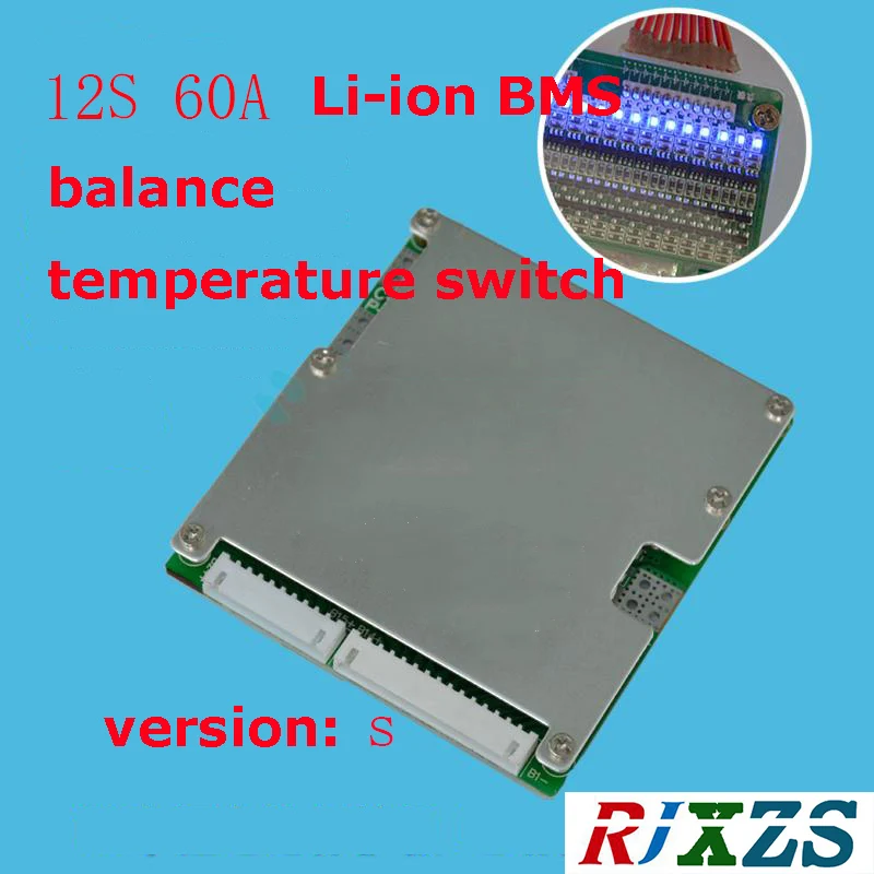

What BMS are you using?
Are you using a balance charger to charge?
I’m using this 12S BMS but it’s quite large (95mm * 87mm * 10mm)
For charging you need a Li-ion charger (CC/CV), I have this 4A charger for 12s (50.4V)
It’s small and has a fan so it stays cool. The cheaper plastic chargers like 1A-3A get very hot. Basically you connect a charge port to the BMS (-) and battery (+) where you plug the charger, it’s very convenient. Balancing is done by BMS.
I’m also searching for a smaller 12 BMS which can be used for discharge. All the “small” BMS for charging only (bypassed) are just more slim but not smaller that’s why I stay with discharge BMS for now. From my experience a “real continious” 60A BMS is really enough even when you pull 100A from time to time. On my MTB I use a 50A BMS from Bestech and pull 100A, no problem and it stays cool. It would cut-off at 110-120A.

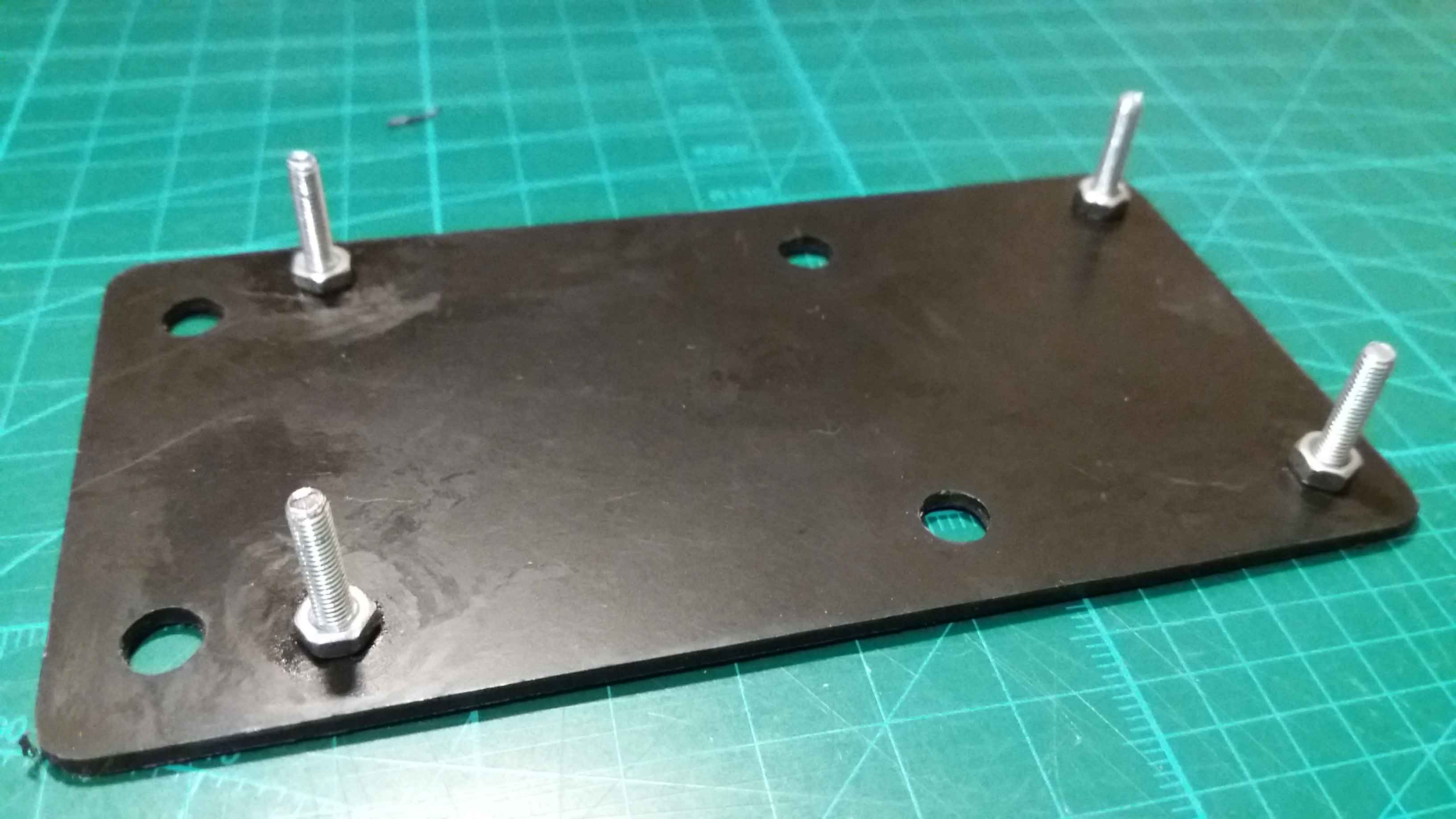

I made a 2mm ABS plate for cable management / strain relief at the rear truck.
The mess is from Loctite
Normally I route the motor wires on the hanger first but this is not possible, there is no space because the motor is too close.

I’m designing the same for routing and protecting my cables going over the back right now, but mine will be metal, with washers used for spacing between plate and deck, on top of using truck bolts to mount.
My current temporary solution while I figure out final wire length.
Much better for sure, at least I use high grade plastic :laughing:
On the rear I prefer wire routing like this with zero stress for the cables if there is space like on my Trampa.
Almost exactly what I’m going for, except I have MT60 connectors next to the motor, and my wires are tucked in tighter because I used the solid copper from the the motor as far as it would reach.
