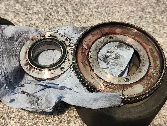

Gear drive update. Turns out the damage is more than I thought, but also easily fixable, as I have some spare parts.
So when I was fixing the board after the 1st breakdown (that was caused because I forgot to tighten the nubs on one wheel) I also took off the wheel adapter plate to clean out the aluminium between it and the casing. During reassembly I managed to over torque 2 of the 3 screws and stripped them out. The previous versions I had didn’t strip from the same torque and I assembled like 6 other sets so maybe these are some softer aluminium, lesson learnt. Then with the threads barely holding, I super glued the screws in place as a quick fix hoping the loctite brand super glue would hold up. It did for the group ride and a good amount of the track time.
But what happened is that the superglue failed eventually and those 2 screws fell out, then the 3rd screw also failed, it was not enough to take all the load. Now one of the POM plates (thanks to @AlexB I have an extra) and the bearing carrier (in which I stripped the threads) are destroyed.
Good thing I destroyed a set of helical gears an year and a half ago. And still had them in my esk8 trash stash. I can take a bearing carrier from that, and I should be able to reassemble everything again. Just need to buy some red thread locker, as blue is not enough for the two bearing carrier screws.

Fixed the gear drive, now on the swapped out bearing carrier and wheel adapter. Loctite is curing.
