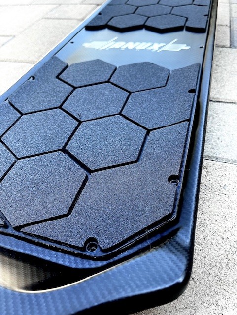

My purpose for designing a split angle on the deck is twofold. With a 10 degree front couple and a 35 degree truck, it leads to be more responsive and “snappier”. It’s great for carving, cruising, and freeriding, and it takes less lean to turn. Furthermore, the front angle provides a superior line of sight for the telemetry (Megan Voyage), as well as aesthetic appeal.
The 5 degree rear angle elevates the motors away from the pavement, not to mention the appearance of the Porsche 911 turbo wing. A lower angle, 40 degree, makes the truck more stable at higher speeds, also gives the rider a more “surfy” and “leany” feeling
Many decks on the market suffer wheel bites. I lengthen the truck mounting (nose and tail) without having the need for wide hangers.

I don’t see why anything you just said couldn’t be done with a flat nose and tail and the split angle being built into the trucks.
Now if someone likes the trucks they have and want to use your deck they will have to accept the built-in angles (and therefore a change to the trucks they like) or choose a different deck.
Or add angled risers to eliminate the decks built in angles
I understand the benefits of split angles, that’s not what I’m asking about.
I’m specifically wondering why you chose to build some angle into the deck, rather than just make your fully custom drivetrain at the final angles that you want? i.e. if you wanted 45° in the front, why do 10° on the deck and 35° on the trucks instead of all 45° on the trucks?
If the answer is just that you think it looks cool, then that’s absolutely fair. Just wondering if there’s more to it than that. Hope I’m not coming across rude, I’m just always curious why people make the design decisions they do :slightly_smiling_face:
From the start, My focus was to design a complete electric skateboard rather than a component-based product. I always liked the esthetical pleasing split angle of the deck without using wedges to attain the desired angle. You are correct about the 45° truck in the front with a flat nose deck will likely appeal to a larger diy audience.
I was more into with what I thought looked good in a complete electric skateboard than with a component-based solution for the DIY community. Flat nose and tail would definitely be more rational for a component-based offering that lets the DIY community to use whatever trucks are available.
I think what we were referring to as an alternative was building the angle into the baseplates themselves.

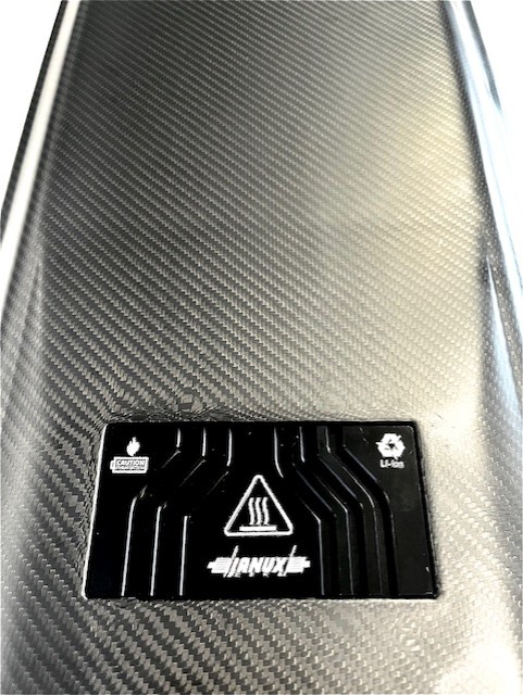

If the deck is all carbon fiber (a Faraday cage), where is the remote receiver placed?
Also I love that someone is bringing back non-plastic 3 gear drives for smaller wheels :smiley: Herringbone is the icing on the cake :ok_hand:
Yes, I do.
The remote receiver is placed toward the rear of the deck. The two front and rear plugs are made of 3d printed resin. There hasn’t been any issue with signal interference or disconnection.

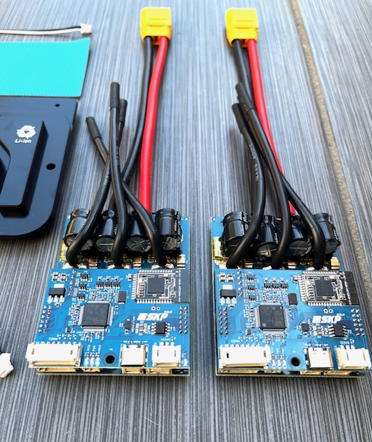

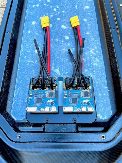

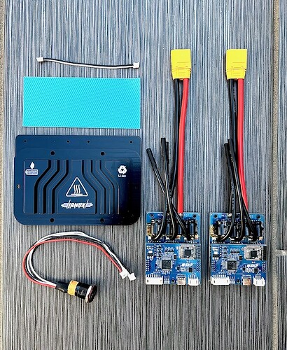

I am excited to announce the release of my own unique Janux complete carbon fiber skateboard deck. These decks, made from real 3K Twill-Weave Pre-preg and vacuum formed Carbon Fiber for maximum strength, durability, lightweight, and performance, are a joy to ride. The limited release of 10 decks is now only available on the forum for a special price of $1299, tax included with free US delivery, a saving of over $200. For International delivery, please contact me.
What is included with the deck:
  • Full carbon fiber deck
  • Battery compartment silicone liners
  • 0.25” vibration absorption foam Jessup Ultragrip tape
  • Custom ESC heat sink with thermos tape
  • High power Dual Solo escs 4-18s Li-ion 16-75.6V operating voltage
    • 80A battery current (ea)
    • 140A motor current (ea)
    • 6kw peak operating wattage
    • CAN,HALL,UART,PPM,IMU
    • Built in Bluetooth
    • On/off latching switch.
    • 10AWG supply cable and xt90 male connector
    • 12awg phase cable and 4mm female bullet connectors
    • Based on the VESC project
