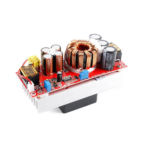

I think anyone wanting to charge their esk8 from a vehicles 12v nominal system, Unless they already have the inverter and charger set up, are better off using the ‘1800 watt’ CCCV booster that looks like this:
The 1800 watts is a bit of a joke when the input is 12v nominal. Basically it is limited to 40 amps input, which is 480 watts.
If you are running the engine so the alternator can power it, then hopefully it is receiving at least 13.6v so that would be 544 watts, input.
The efficiency of the booster goes down the lower the input voltage and the higher the output voltage.
