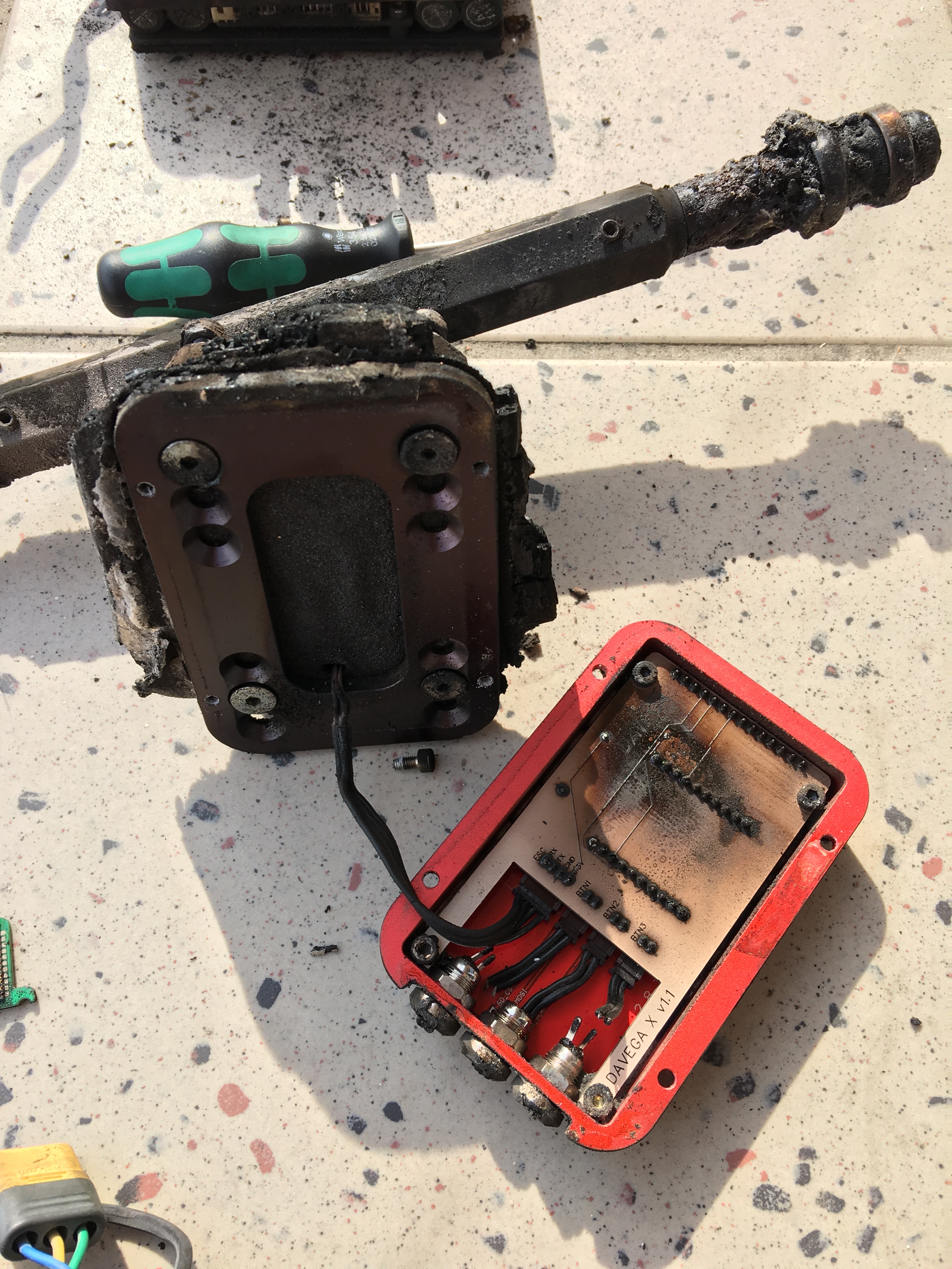

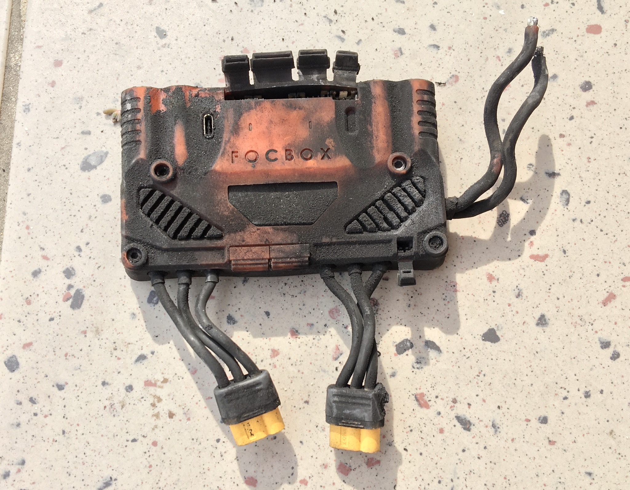

No worries. It survived. I still use it. :slight_smile:
Did you ever track down the specific cause of the overtemp cell that led to fire?
Unfortunately not. It’s a mystery. The only hint I have is that the Unity connector desoldered itself.
So probably something shorted out around there.
Now that I think about it, it would have been worthwhile checking the continuity between the two desoldered lead.

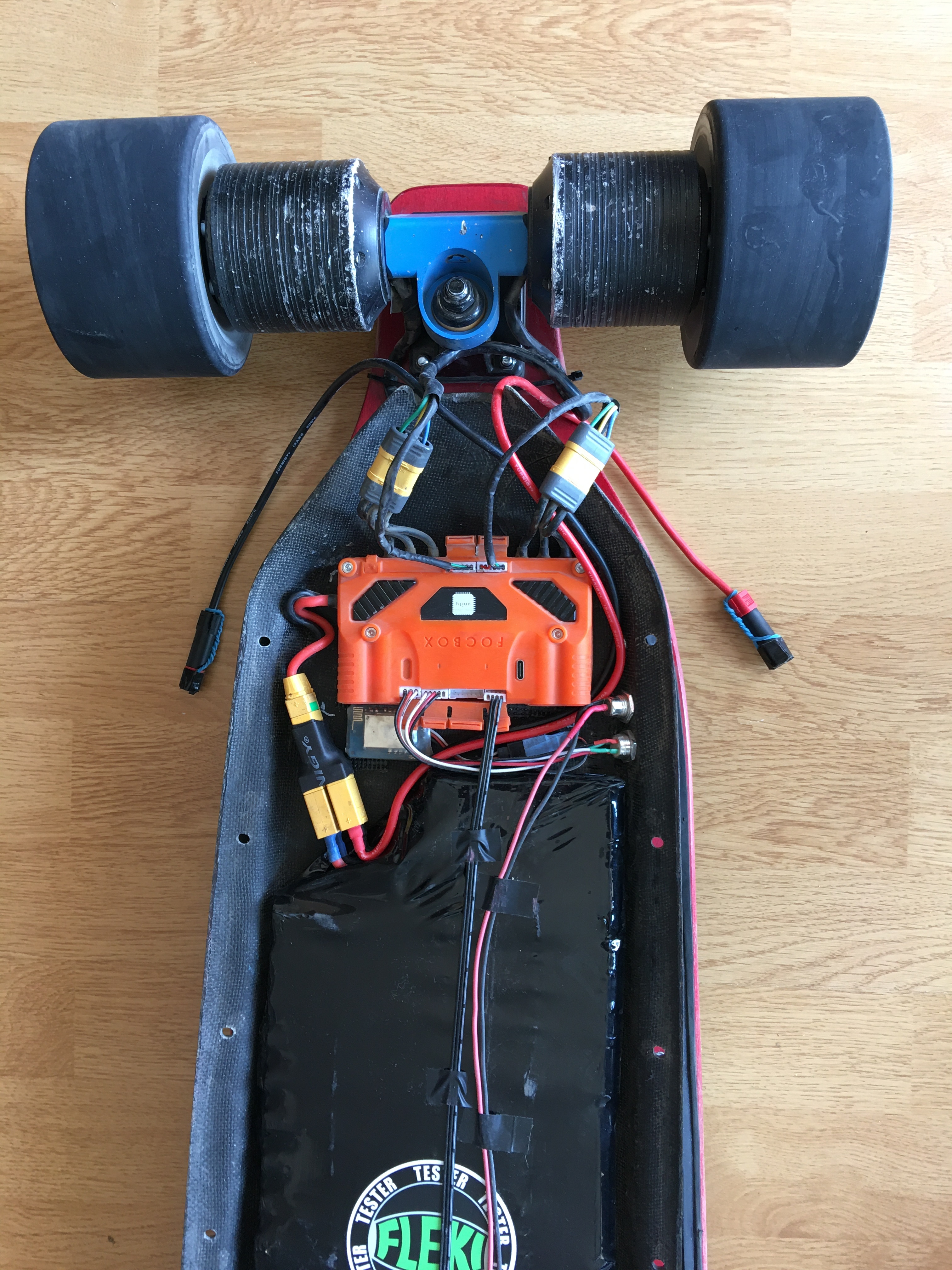

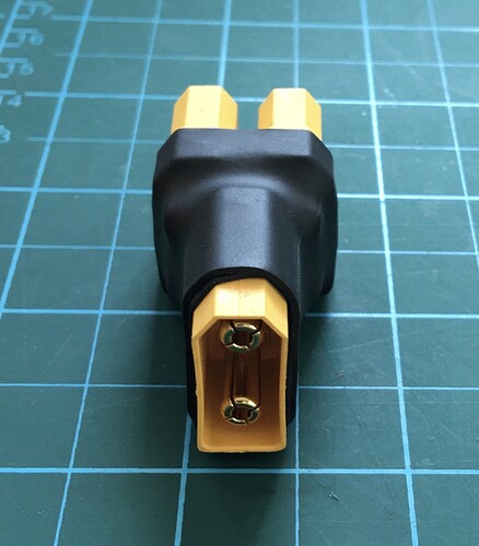

Here’s how everything looked inside the enclosure before the accident.
I had an XT90 parallel adapter for connecting an external battery.
Maybe something went wrong around the parallel adapter. It’s really strange though. I have done all the soldering myself and I believe my soldering skills are pretty decent.
Also, I have used this for a few hundred km both with and without the external battery before the accident happened.
