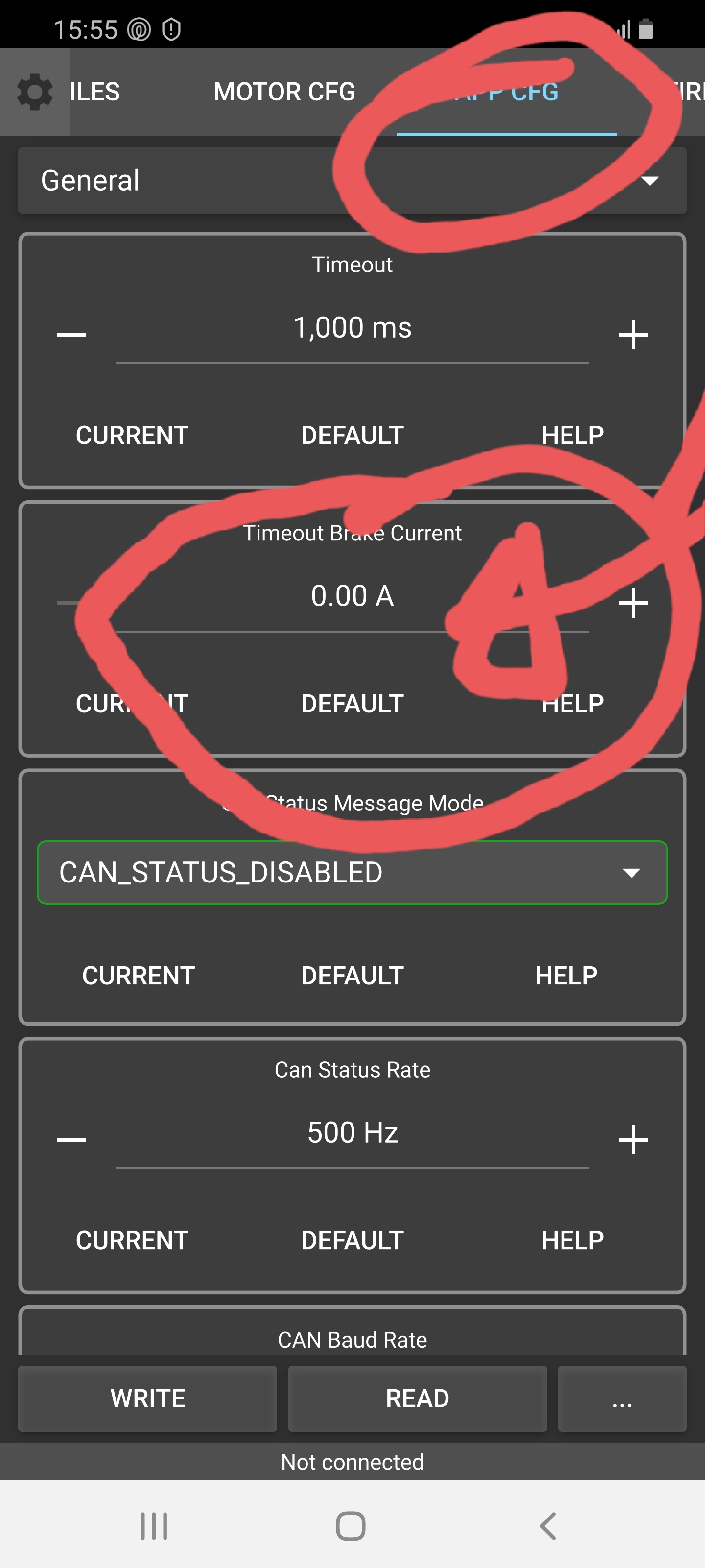

I have set up to 10amp safe break at the VescTool, 3 weeks ago going at 50 km/hr loosed connection (run out of battery on my mini remote). It was a soft and safe stop…Very happy with that future…

How did you accomplish this?
I use 10A here…It saved me many times…I`ll suggest you to start with a certain amount of A and then increase it until you find your sweet spot…This has to be done insitu,
