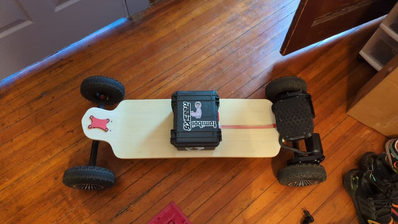

This board will be something. Why did I build it? idk. I had the drivetrain, esc, and battery. Picked up a deck and some trucks, called it a day.
Huge thanks to @tomiboi for routing out the deck for me. He did an immaculate job (as always) and it made the build possible
16s3p p42a
SKP solos
Newbee RTKP
Newbee 4gs 55:11 (will prob go down to 44:11)
Newbee Impaler rims
RS tires soon
Flipsky 6384 190kv v2
Tomiboi honeybadger with wire channel
Although the build is mostly done, there are a few more updates that’ll come, and I like making build threads because I’m a whore for likes

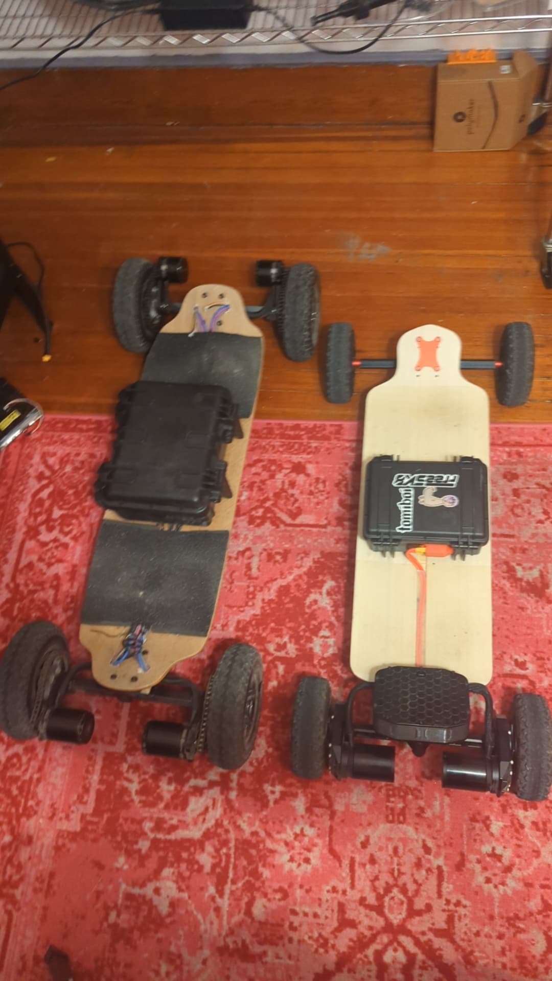

Here’s some size scale between my kaly 2.0 deck and this. It’s a smidge smaller, and the old kaly deck is already really short
AlexB:
That’s a hot slot.
Please don’t bring my mom into this.

Makes for a good board name. Evan’s Hot Slot. Exposed so everyone can put their dirty little eyes on it.
Since I made the slot, isn’t it kind of my hot slot? I hadn’t realized how short the old Kaly deck was. That things a midget.
