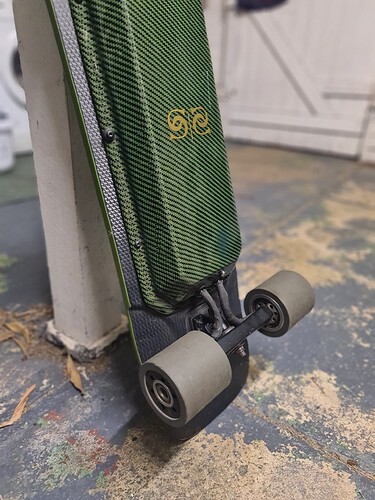

I’m running them. Friggin awesome.

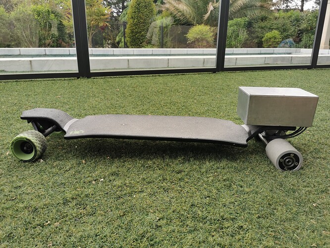

Not a pretty build but this way flex of the deck is saved.
Inside the box : 2x Turnigy 6S 6000mAh, a FSESC6.6 dual mini (my nineth ESC from Flipsky with ZERO issue) and receiver.
The box don’t prevent from being able to put feets on the board :
I think looks kinda nice. Simple.
Selling for 525$ is a great deal. Even if I wasn’t the one who made them Id say so. Compare to another drive out there and the components in the motor and these are steps above.

I ran them at decent speed for about 20 min yesterday. Motor max amp set to 80A. There were not hot, maybe 40-50 °C. Acceleration is good to me, but I’d prefer my mountainboard with footstraps to go fast. Free wheel is amazing comparing to my belt driven e-longboard. That’s what I like most. I’m very satisfied with these hubs. They are offered here at a very good price!
