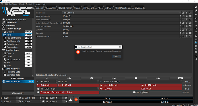

Ran motor detection, first time made some beeps and said something about flux detection/issue and ever since I only see this when running the detection
I tried pressing KL detector too but no luck.

Flux linkage detection failed. That was the first error seen. I just realized I was using my power supply as the battery which only had 58v6amp. The detection should I set the current cutoff to 6. It think it was trying to pull more , as I put the battery cutoff at 50a. Or do I need an actually lith back (14s)
I use a power supply for testing too. If the current is too low, then it will fail flux linkage detection. The motor detection requires more power than just spinning up the motor. I use a 10A supply.

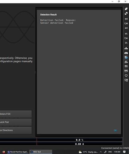

Still not getting detection used my battery 14s20ah 58v pack.
It has a 63a circuit breaker.
I will also set Current MAX at 30A in motor detection setup.
But detection failed, sensor detection failed.
This is :face_exhaling:

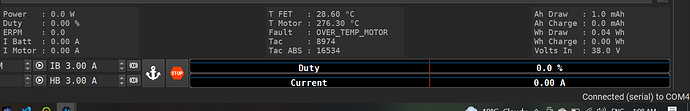

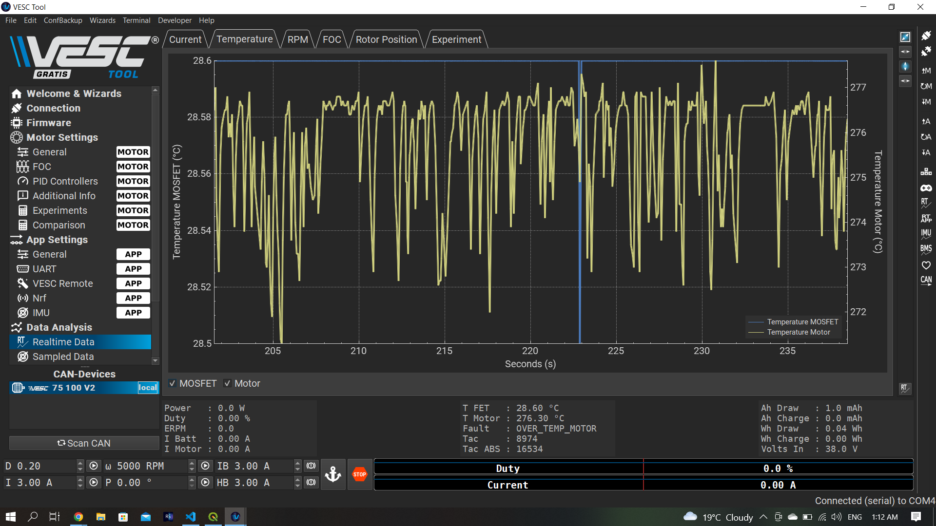

I think the detection is not working because my motor temp is jumping to 270dec C ( fault) i think i will disconnect that cable and try again. Doesnt look like there is a software way to disable it. Tried two different motors and they both showing same 270deg. Will need to review there wiring…

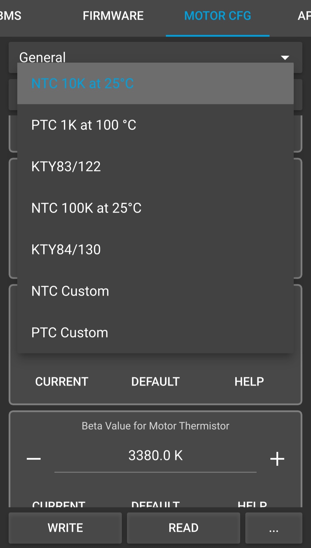

You can run the no limit firmware and set the max motor temp to like 999c and see if that allows the detection to pass.
There are also settings under motor->general->advanced that will allow you to specify the resistance of the ntc resistor in the motor to get it to read correctly.
