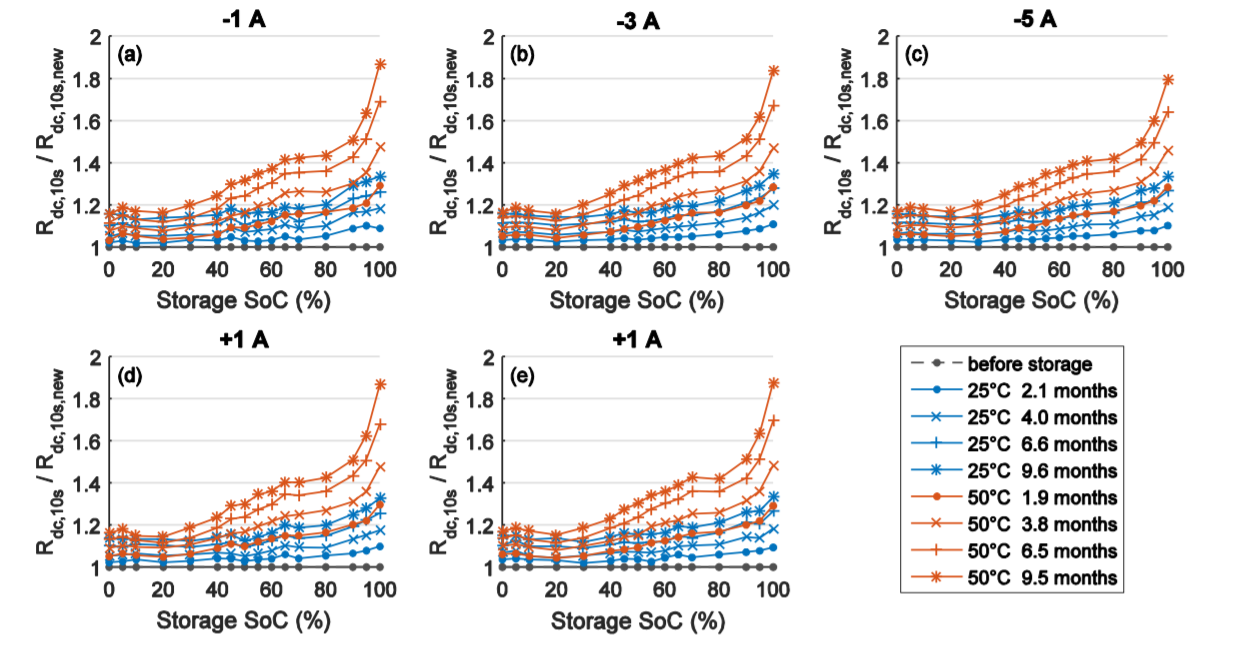

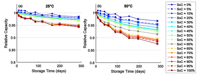

This is a really good study about battery degradation, while it can’t be applied to all cells due variations in chemistry, still relevant
Cell used is Panasonic NCR18650PD
This is the part that matter for this discussion, while the capacity fade is bad when left at high state of charge, even worse in the increase in internal resistance, and worse yet if you stored them in a hot location
