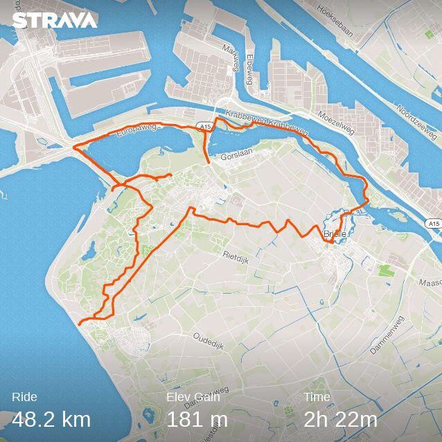

I ran my at hummie last Sunday which has a 12s8p battery for 48km.
Start voltage was 50.0.
End voltage was 42.4.
Metr records below. I am missing a part because the metr lost connection once. Probably due to walking too far away from the board and then it did not reconnect again.
I reckon with these ride speeds I could go another 10km for sure. Most likely more.

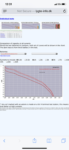

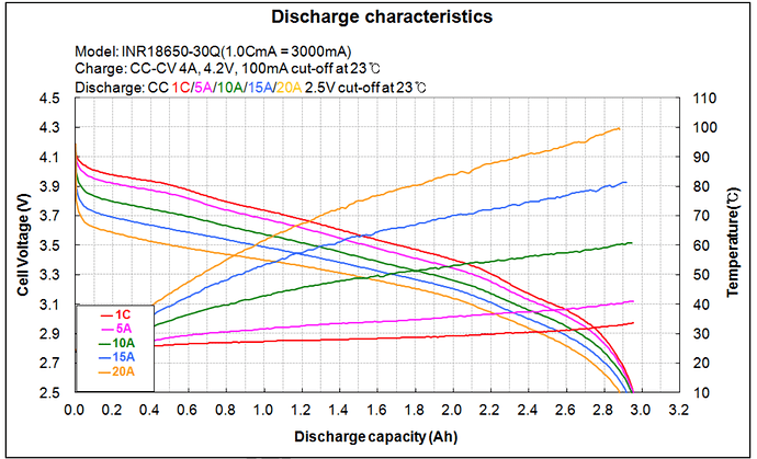

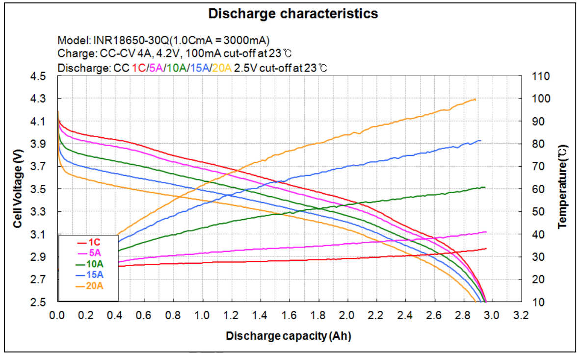

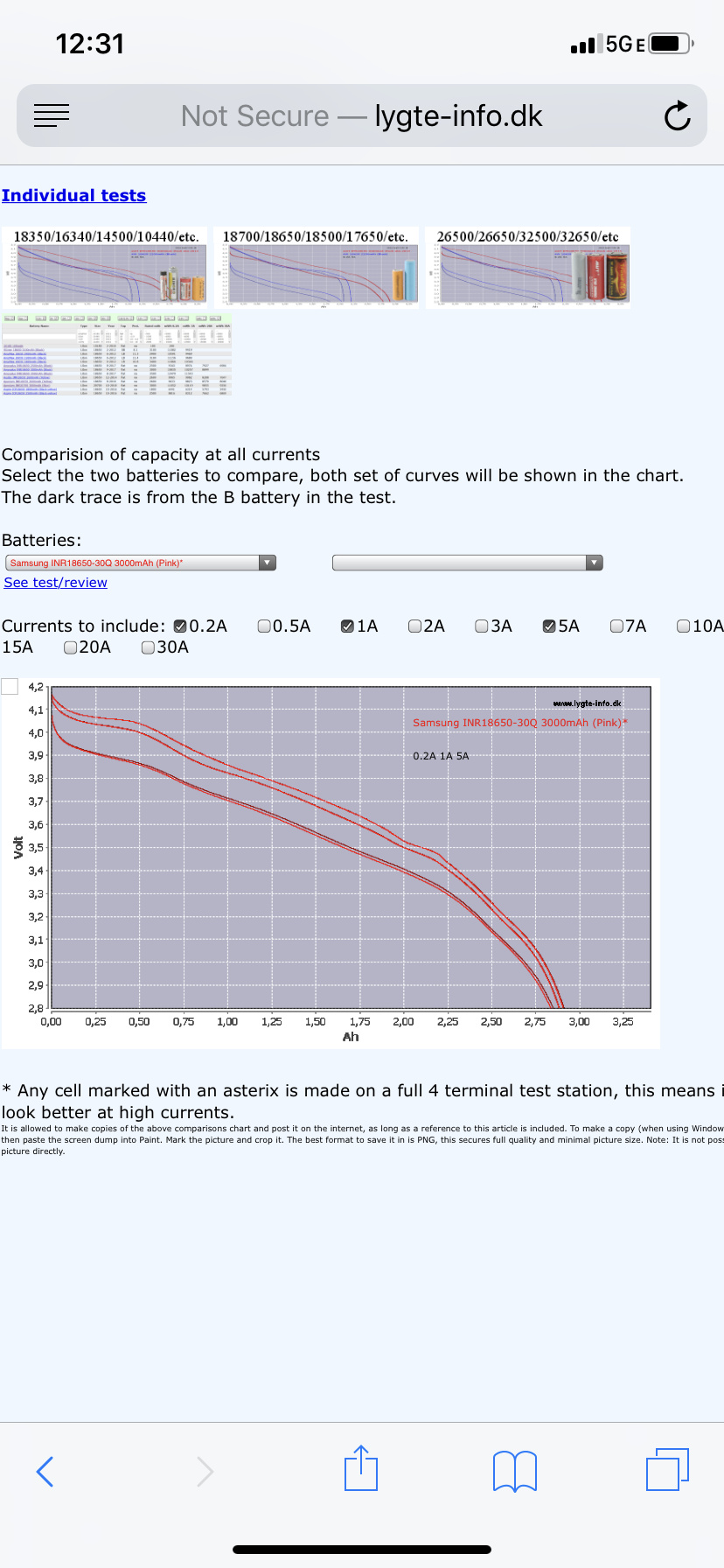

I’m afraid you’re way in the wrong with that assumption. It doesn’t work like that. Using the same logic I could argue that when your 2Ah cell voltage gets down to 1V, there would still be 2Wh of energy left when in fact it would be completely drained somewhere near 2.5V.
Here’s what the discharge curve looks like for Samsung 30Q, just to give you one example.
Two things to note are:
  1. The function is non-linear.
  2. It doesn’t go all the way to 0V since at 2.5V there’s virtually no energy left in the li-ion cells.
(BTW, the x-axis label is a bit unfortunate. It should read ā€œAh dischargedā€ rather than ā€œDischarge capacityā€.)
You see here at the end of the discharge the voltage drops very quickly for how many amp hours you get out of the cells once you go past the point of the graph the cells voltage fall extremely quickly to the point that you get almost no more range by discharging them lower
