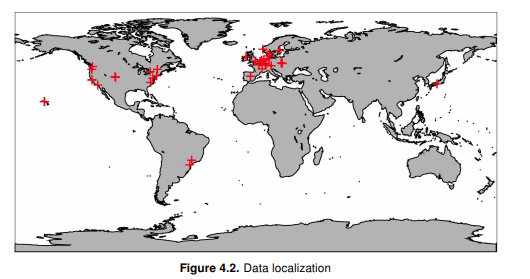

For the logs, I was thinking more in line of using them to create an individual riding profile, say that the user has 1000 km of logs, we create a small distance, let’s say something between 1 and 5 km, representative riding cycle for that specific user, and use that to compute what would happen for any other battery or any component configuration
But yeah, the temperature really kills the deal, only workaround I can see is to keep the same cells numbers and physical build, and use the logs to create a thermal model of this configuration and simulate the new temperature with the cells using this model, but this requires that the original logs to have pack temperature sensors, as far as I know only the Trampa new packs and our new Lacroix packs have cells temperature sensors for us to use
@bevilacqua has a really cool paper where he used logs from a bunch of riders to create an ESK8 riding cycle test, really cool and worth the read, something similar could be done at a individual basis (Mathias, pardon me posting directly the pdf but I couldn’t find your link anymore)
Case study Electric Skateboards.pdf (10.1 MB)
