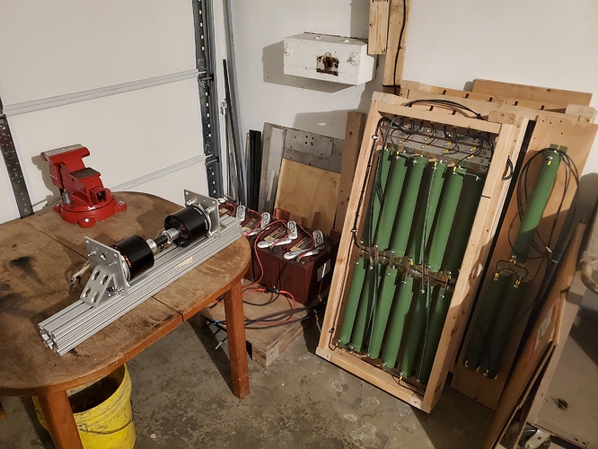

I’ve only blown DRVs on a dyno, never in use. I guess if it fails while you are braking, the severity of the failure is dependent on whether or not you really need to stop :wink:
If I had a few VESC 4s (to blow up), I could put them on the dyno (shaft coupled BLDC motors) with, and without the little heat sink. I could monitor the power line with an oscilloscope and see if there are switching transients in regenerative braking mode, and if the drv is hotter. I’d post a video…

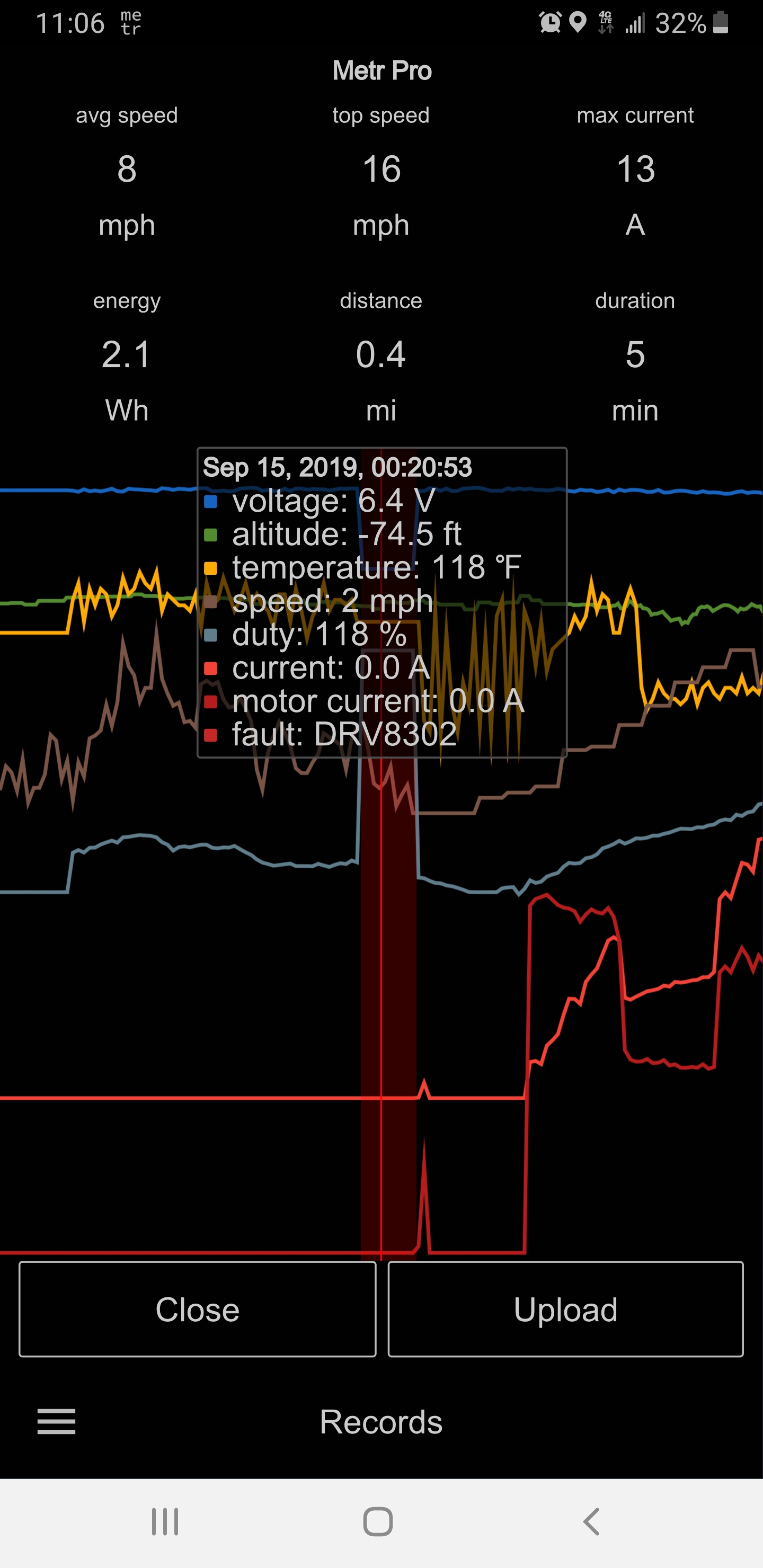

Just got 3 consecutive errors, she’s toast. Since the ESC is from @Psychotiller via another forum member, is it still covered by any warranty?
Fuck man im sorry, I just killed one of my maytech 4.12s :frowning:
anyone know what DRV fault this is? After a power cycle everything works fine…
