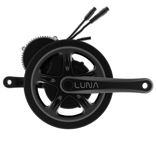

This kit doesn’t look to bad and a lot of good ratings
