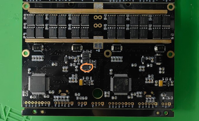

Is there any way to disable roll to start on the pro?
Removing this diode disables the push start.
Looks like I’m doing that lol

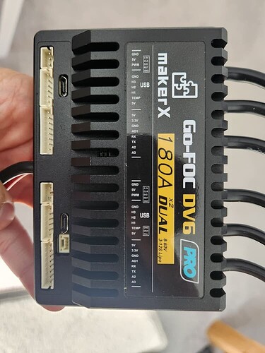

Does this version have an built-in switch? I’m plugging my switch into A3 but doesn’t seem to do anything.
no
A3 is just the third ADC pin, you’re probably shorting your 3.3V line if you’re plugging a switch into this.
Isn’t it just a high impedance input? So nothing is shorting into anything as far as I would guess.
