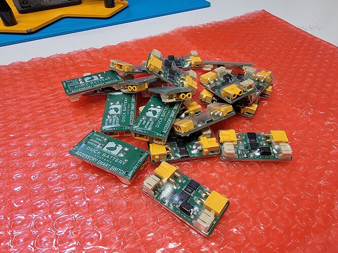

I don’t know about other folks, but I typically run LEDs in series on a constant current source from battery voltage.

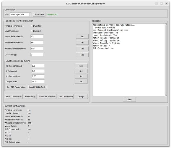

As promised, now you’ll be able to configure your controller over usb with this program:
(dont need to mess with the firmware at all to change the parameters)
Just plug the remote on usb, and voila! plug and play.
I’m uploading the tool and the level assistant later today
Most headlights are either shredlights, a handheld flashlight, or a motorcycle headlight that can take full pack voltage.
For that last type most either use a COTS button or an A.S.S
TLDR a 5v rail to control lights please.

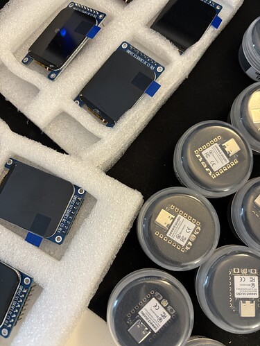

parts starting to arrive, will have some remotes to build and ship :star_struck:
