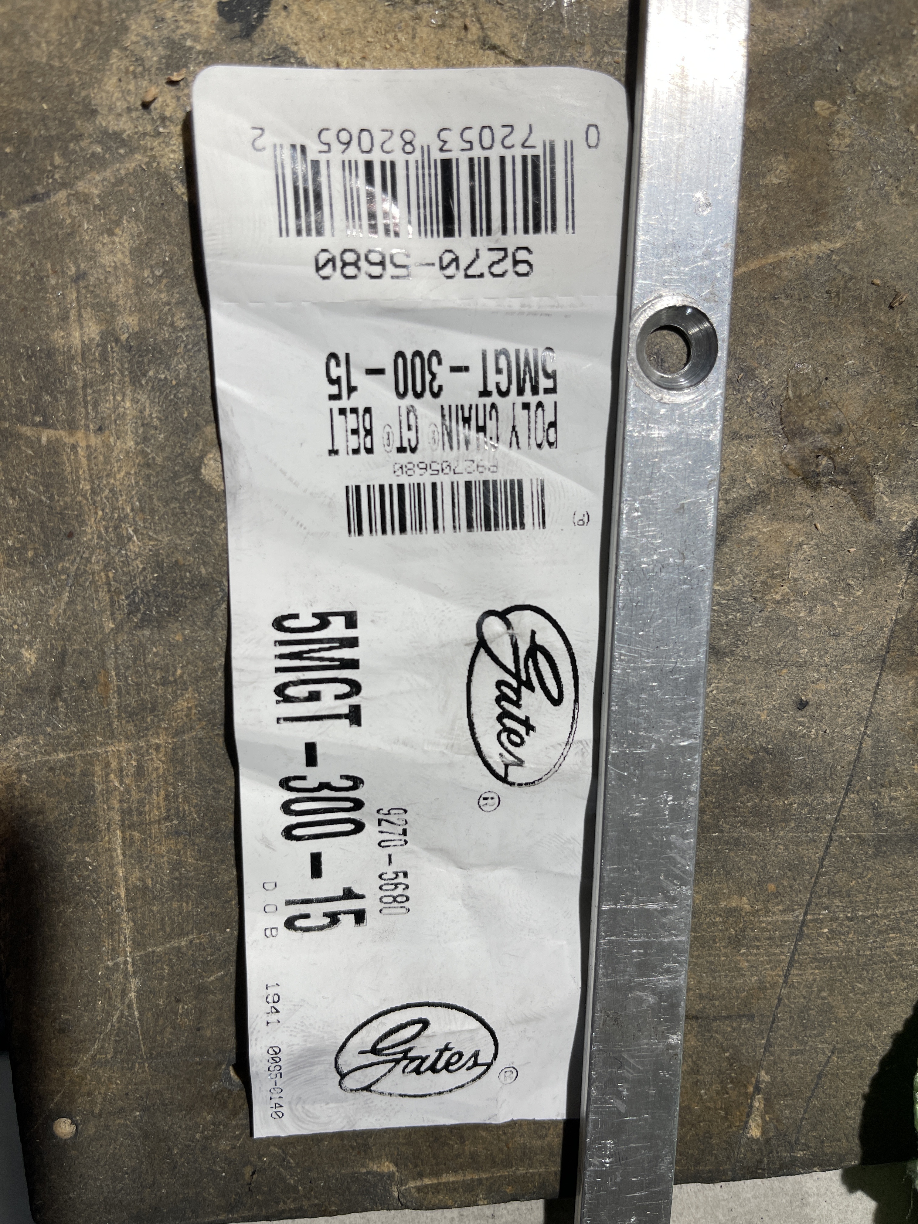

Gates polychain GT carbon belts
you could go for 3d printing extra wide pulleys in like cf or pc
some of them have ridiculous strengths

You can probably order a wider pulley of a standard tooth profile pretty easily.
Just need an adapter to suit wheel core and to drill the pulley stock to suit adapter fixings.
:arrow_up: the pulley stock for 48T HTD5M is like $200+
Cheaper to buy two pulleys and machine them into one
@b264 5mgt
What, they jump from 300mm to 375mm?
