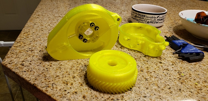

@Skatardude10 dude! That’s awesome! Those are some wide gears, mine are only 18mm wide and I will probably drop that down to 16mm for a dual drive. That gives me a lot of hope that yours did well. My mini-spline motor connection has had zero issues whatsoever so I think we can count that problem effectively solved. Also, I think making a workable printed gearbox should be doable. My gearbox right now is super janky, because I didn’t want to invest in getting mounts machined so I just made an enclosure that would work with what I had so I could test enough to see if the idea was viable or not, but based on my experience so far and your success it is probably time to design a proper gearbox. Thanks for sharing your experience. Do you by chance have any pictures or anything you can post?
@moon thanks for the grease suggestion, I will get some on order tomorrow so I can get back to it.
That’s all I could find for now. Tried a couple different designs and decided to go simple. The simple ones towards the end worked best, but really I think any enclosures need to be stronger, or at least flexible and bulky at all the connection and mounting points, made with nylon.

Yeah man that’s awesome! You went to town on those gearboxes, the hinged design is pretty cool. I’m thinking the gearboxes I end up using will be very boring, very similar to all of the geardrives out there right now, only with a printed cover instead of a CNC’ed cover. I feel like it is the simplest and strongest, and makes it possible to add a v-ring seal. I can’t believe you fit a dual drive with 24mm gears…
Also, it looks like you remixed my printed hubs (which were just a remix of @Maxid hubs) for that build? Haha that’s awesome.
Oh shit good catch, yep! Made a few changes, beefed up the side rim things quite a bit, they served me well while I was running them… mostly ran them belted.
Nice. yeah I like the side ring mod. I’m glad somebody got some use out of the model.

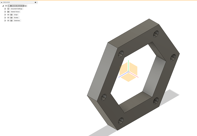

For funsies, I just started building my own variant of this theme as well!
That’s the Fusion360 modeled parts.

Looks good! :slight_smile: what material do you plan to use for the final version? And better balance those wheels before you really start using the drive, the oscillations put way more wear on the drive especially on 3D printed gears.
I bought some NylonG specifically for playing around with on this project. I don’t know that I’ll ever actually make two of these and put them on a board, but it’s been a fun learning/modeling experience.
You should add a bearing to the design, so that the gear will run as true as possible around the axle. It sound like the gear is just a tad woobly now, which creates a lot of unnecessary wear and noise.

not so muchfully 3D printed, used Nylon and PETG with metal TB mounts. Before this I did quite a few different straight and herringbone gears without covers that worked great for a while… the biggest issue was rocks and debris getting in and mucking up the gears. The enclosure on this one didn’t work so well to contain the gears enough as you can see.
I do believe a fully 3D printed drive can work well… I just gave up for now. But man, did they ride well when they did :grin: Honestly, I got a lot better reliability using no enclosure, as the enclosure tends to catch and trap more debris than the bits that might happen to get caught in the gears just right and spit back out immediately.

You’ve definitely got a leg up on my fusion skills, I suspect :smiley:
I don’t have a huge problem with that, but most of the mount is custom to a given truck and the gears aren’t special (there’s a plugin that does it). Also, it’s only a single ratio. So…kinda rather specific. There are a few designs for this on thingiverse already, which I definitely used to ensure I wasn’t going off the rails, but they also only work in fairly specific applications.
