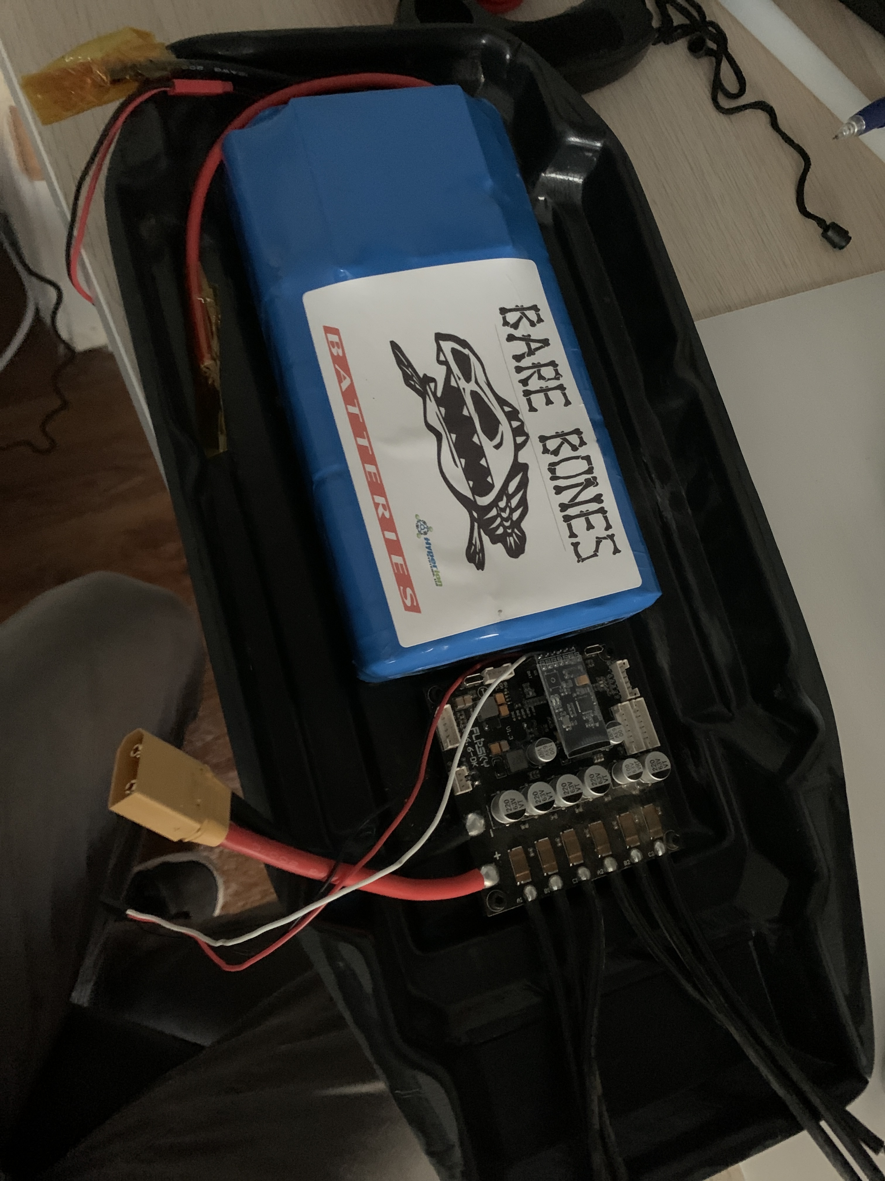

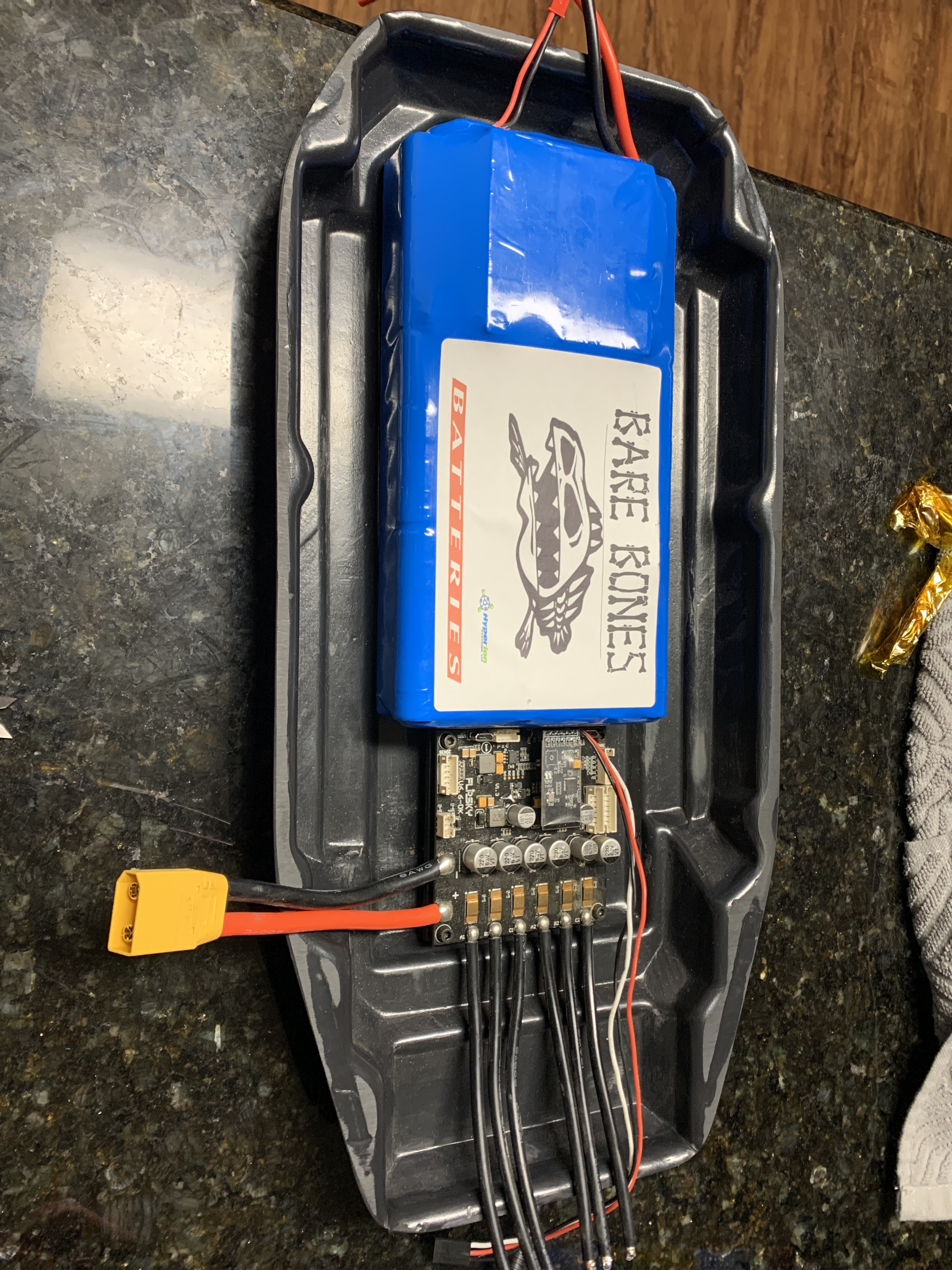

Need an opinion for a problem, geometry is a bitch!
I got enough room for my battery and ESC with space left over for light up toys and fuses and what not, but the BMS (ontop of the battery) is higher than the enclosure, by about 3/8"… Do I just route a pocket in the deck so it sits in it? Also what should I use for padding on the battery? The main body of the pack sits at the lip of the enclosure when there is nothing underneath, I was thinking craft foam on the enclosure and Velcro on the deck
You can also remove the heat shrink and move the bms if you’re feeling brave :stuck_out_tongue_winking_eye:
Long story short, I bought a battery and it doesn’t fit, what do?
I’m thinking I move the BMS to sit under the ESC and shrink wrap the whole thing (just phase wires and sensors on one end, and antispark with charger on the the side…and I guess the aux line on the far end) I’ll have space for it and it’ll be a nice wrapped block…only 3mm to spare lengthways, and -2mm to spare on the top
P.s. if anyone wants to send me a sticker that says “Tetranox angry pixie box” just PM me :smile:
Is it bad to set the ESC and BMS heatsinks against each other and shrink wrap it all together? I’m thinking a plastic spacer to keep the batteries from rubbing
Why can’t you move the esc more to the rear in the enclosure? It looks like it’s got room.
Height clearance, the caps are tall enough that it doesn’t sit in the pocket, I can only use the space for the light drivers
I’m gonna guess a hair dryer to mould out the plastic isn’t possible either. What about cutting the back or front off and extending the enclosure in some way?
That’s got to be such a low profile enclosure if it won’t fit… Can you route the deck a little?
Hmm, I guess that’s possible, get some Kydex and use it to patch the gap? But all that does is let me have the ESC at the end, still doesn’t help height. I really don’t wanna have to put a giant spacer underneath…gotta have some style right
That’s what I want to avoid…it would just be leaving 1/8” of the deck left under my front foot
But would it be safe to stack the ESC and BMS?
What about glassing the top? A few layers of fibreglass/carbon fibre could strengthen it.
How many mm to tall is the pack?
I was planning to frit the top but that would work, just worried if it getting uncomfortably stiff
52mm, the main cell body is 43mm
